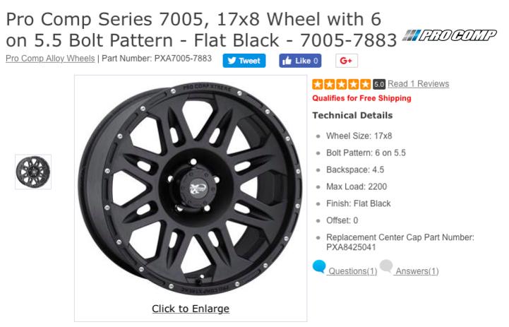

Are the Pro Comp 7005's that you have 17x8 with 4.5 backspacing and 0 offset? Any special lug nuts necessary? Are wheel spacers necessary with these wheels. I've got an Old EMU 3" kit on the way and want to make sure everything will fit properly on my 05' V8. Would you recommend 275/70/17 or 285/70/17?
Not sure of the offset, i beleive 0 however. I used my local 4wheel parts to match me up.
As far as lugnuts they provided a matching set.
Wheel spacers were not necessary.
I've got 285 and was happy with it. but youll need to remove your mudflaps.
