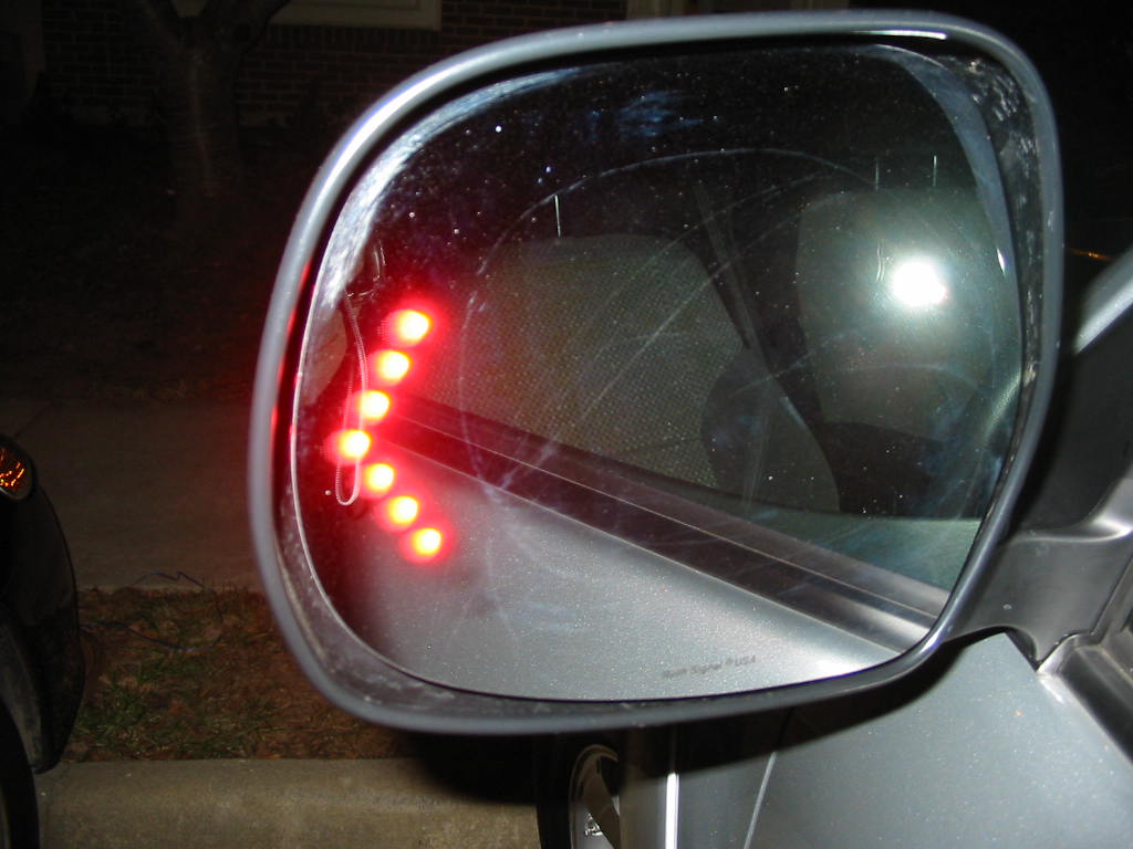

Added Muth Signal Mirrors

What was the installation like? Is everything behind the mirror or do you have to take off the door panel? TIA
I DL'd the instructions and you have to take apart the door panels and mirrors. It isn't a quick install but maybe if you decide to change your speakers one day you could do this at the same time.
I like the signal mirrors, pretty cool!
That was the cost for the heated ones. The non-heated ones were $219 I think.
BTW I'm getting all this info off the link that was provided.
I had a shop do the install took them 1hr 45 min.
Link for installation
Door panels were removed to access wiring.
http://www.kwmuth.com/techsupport/pdfs/21000890.pdf
You can still use the heated option only if you had the heated option to begin with.
Heated mirrors are $265.00
Non-heated mirrors are 219.00
Warranty 3yrs. 36000 miles

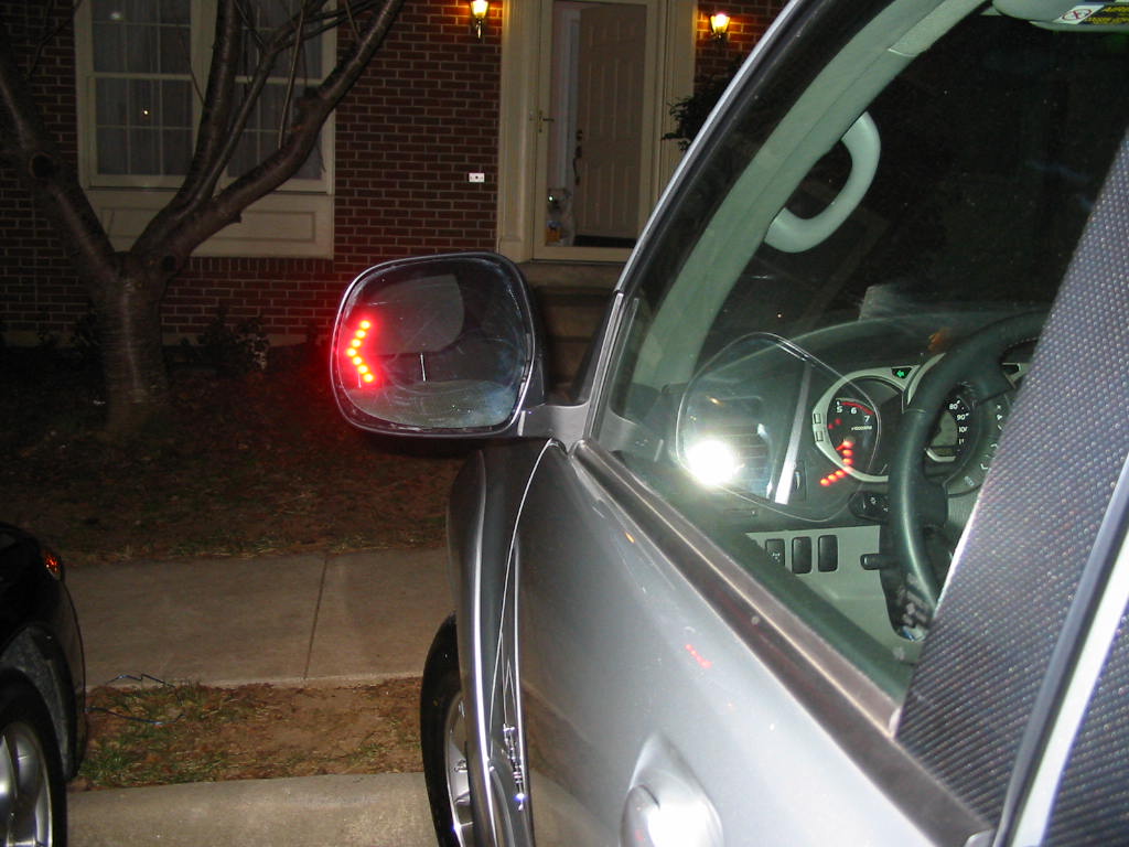

How much did the install cost?
I think you posted somewhere that off-roaders would think it a waste but I think it's great!
That looks like a great weekend project and the results are really nice. Good choice in mod....gotta scrape together some extra cash for those myself now!!
