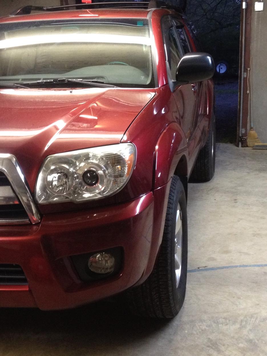

Spent my late Thursday afternoon installing Spidertrax wheel spacers. Bought the blemished product from Spidertrax...saved $10.00 a piece and couldn't really notice blemishes. Used 85 lbs on the torque wrench and the supplied red locker product. Total install took maybe an hour and a half. Pictures of results in my photo album. Definitely gave the runner a more aggressive stance. No noticeable gain or loss in vehicle handling on test run. Seems to be aligned just as before. No pull left or right at highway speeds or slower.

Any rubbing? I have 1.5" All Pro's sitting in my garage (a month now, due to road trip & getting all fluids flushed). Can't wait to do my first "real" mod on the 4R.
No rubbing. Very close though. I'm in stock size so that seems to be the key.
JA has a great section in his spacer thread about a fairly simple wheel well mod that corrects rubbing.
