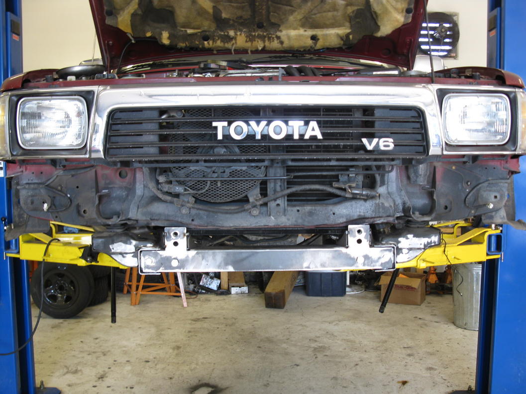

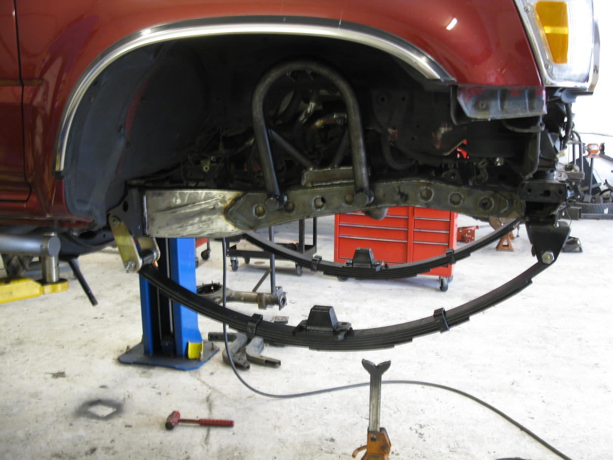

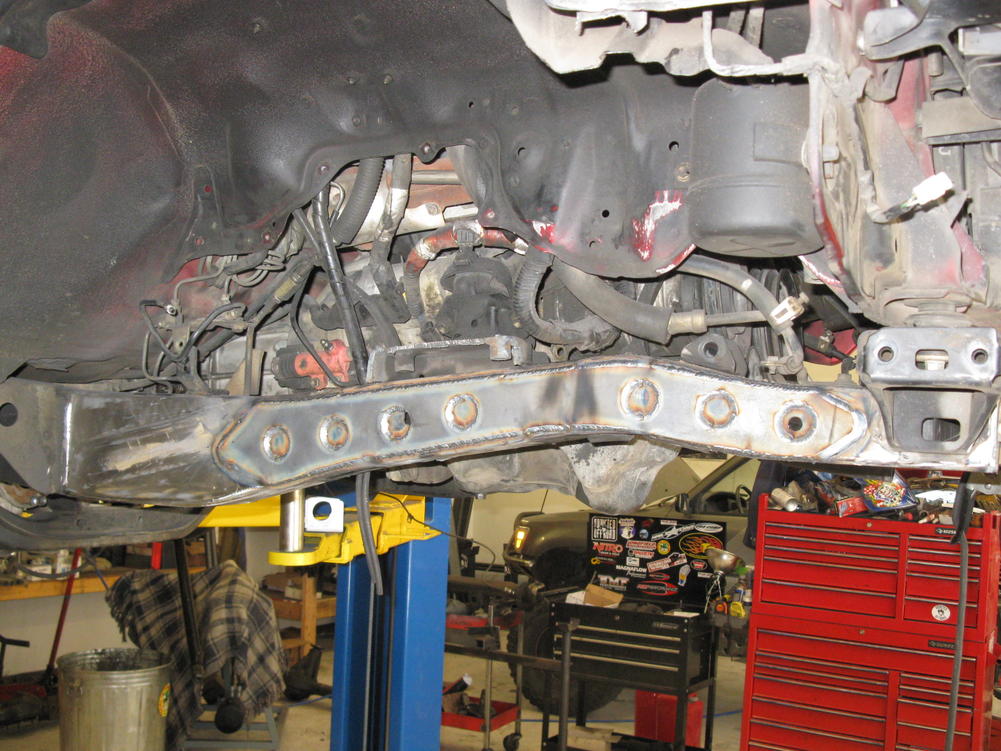

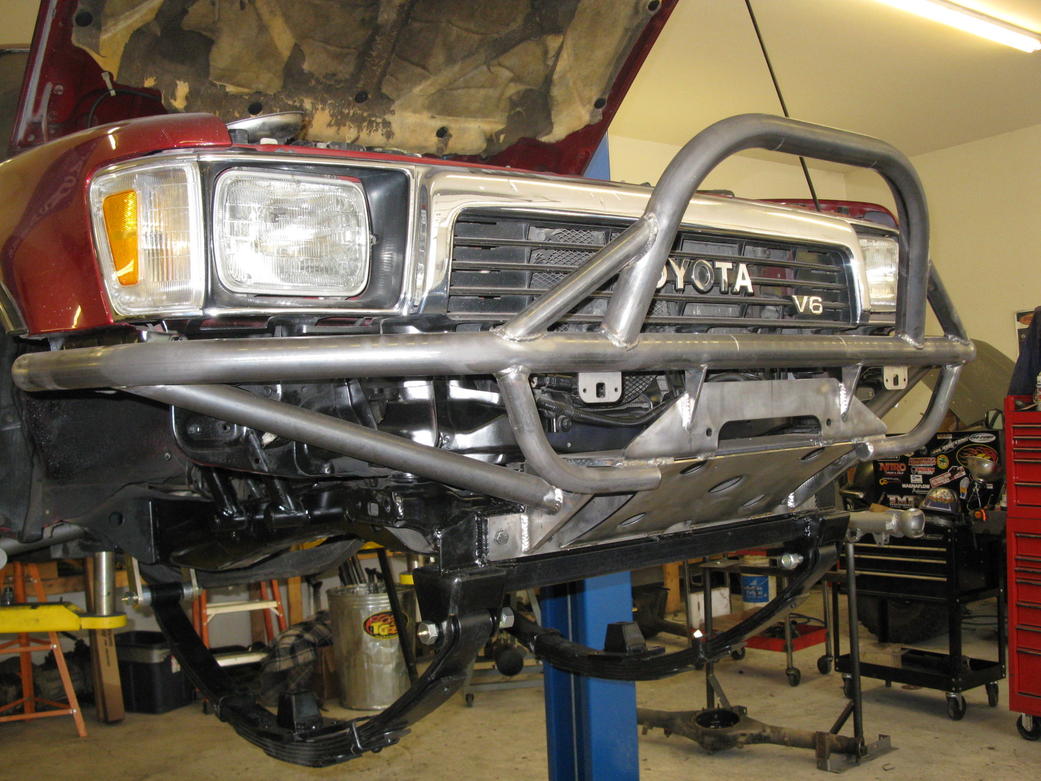

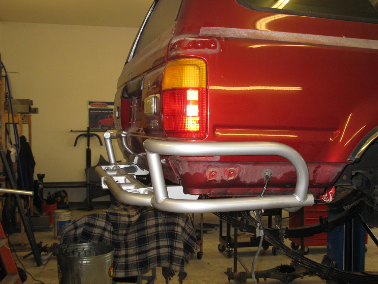

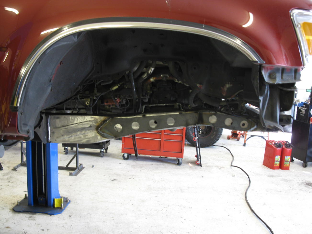

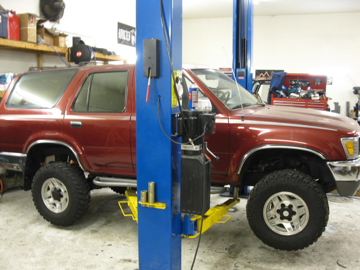

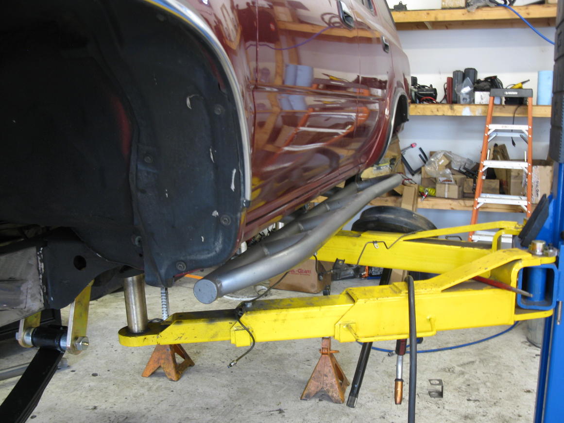

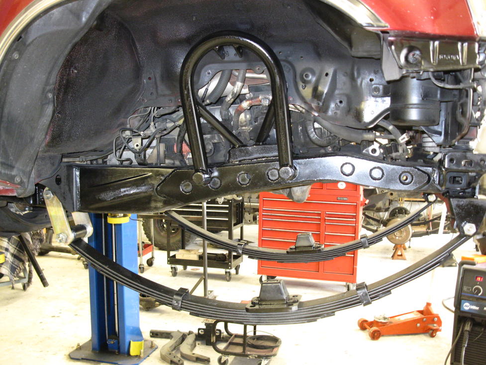

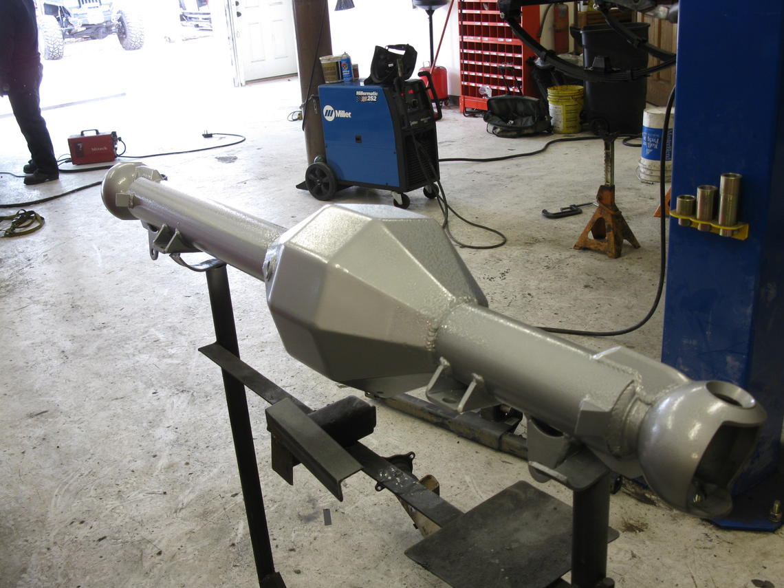

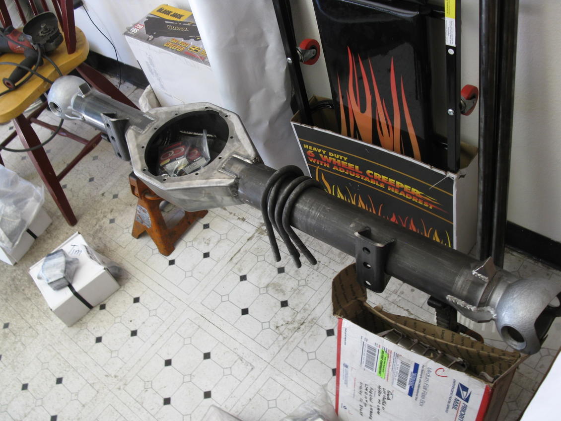

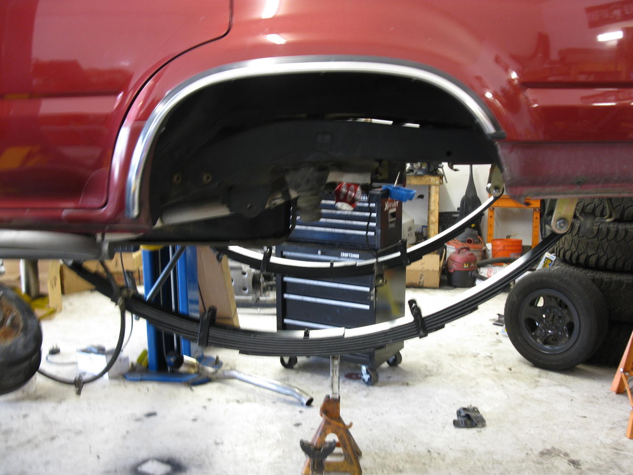

This 4runner was shipped in from Phoenix, AZ for one of our full-turn key builds.
Specs:
61.25" wide Diamond axle
High pinion front 3rd. 5.29s, Yukon Zip Locker
30 spline Longfields
IFS Leaf sprung rear axle
Dual cases. 4.7 rear case
All-Pro Sliders
TG Rear bumper
Addicted Offroad Front bumper and frame reinforcement kit
4" IFS Elim kit
5" Rear kit
Long Travel shafts
35" Mickey Thompson MTZs on rockcrawler wheels
