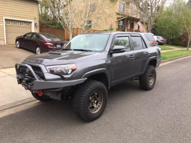

I'm having my bumper and roof rack powder coated a silver to contrast my Magnetic grey 4runner. Ill post pics once its done. Wanted something different from the normal black. Hoping it looks good. Sometimes hard to envision what something will look like till you actually try it. LOL might be an ugly mistake...we'll see

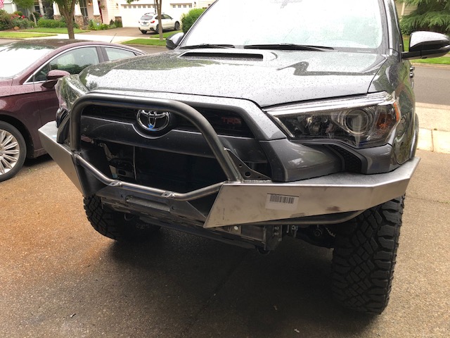

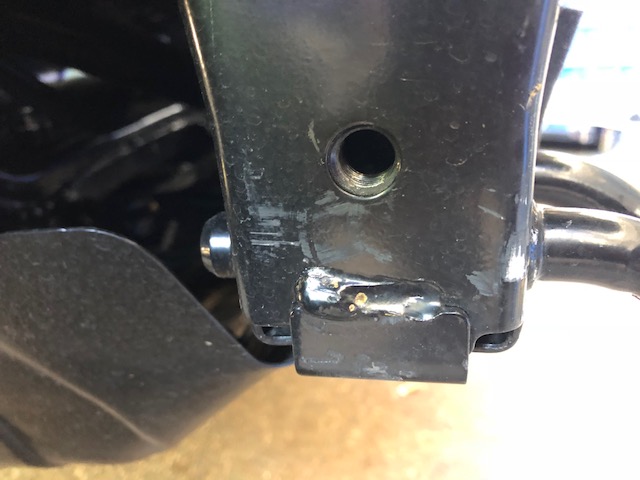

Finaly received bumper yesterday and started doing the test fit. Found a couple issues with Addicted offroad's manufacturing.

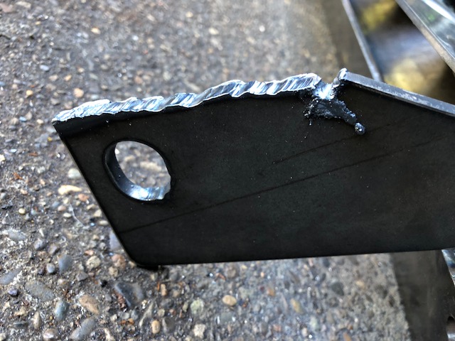

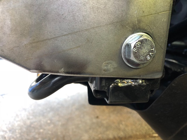

first is the two side plates of the crossmember where they slide on the outside of the 4runner frame. Found that the plate was too tall and interfered with a factory weld. I had to plasma cut 1/4" off the plate and regrind it smooth. You can see in my pics where i plasma cut it and then ground it smooth again and now it clears the factory weld
Second, 3 out of the 6 nuts welded inside the crossmember had weld slag in the threads or something and I could not even start a bolt into any of them just sitting on the ground. I had to get a tap and clean the threads out.
Third, some of the holes are not drilled perfectly center where they should thus once all the bolts are in you cant adjust the side to side level. I had to wallow out a few holes with the die grinder to create some movement.
After a couple hours fixing those issues Iwas able to get it mounted and test fit. Now take it apart and send to powder coating in silver.

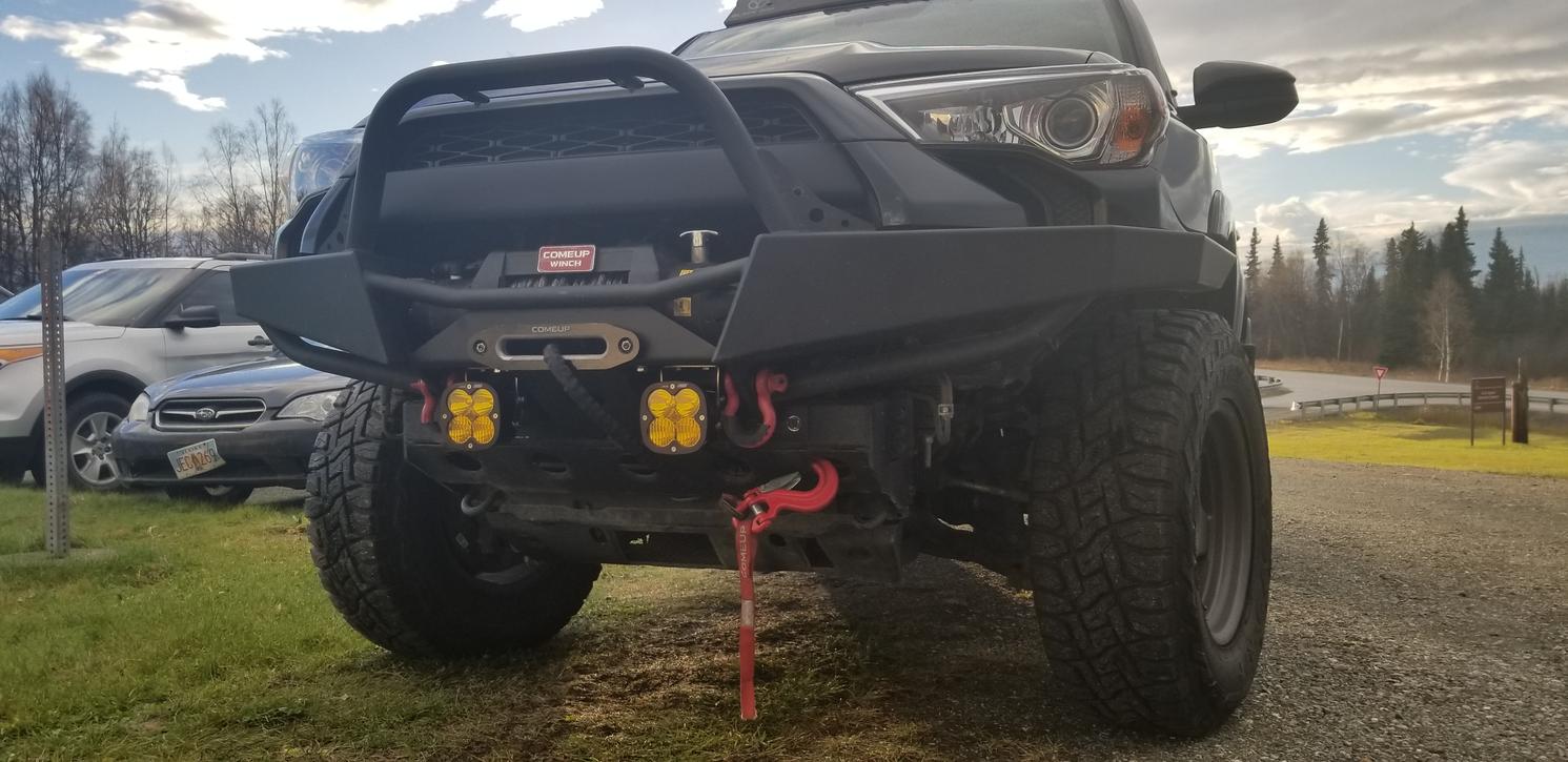

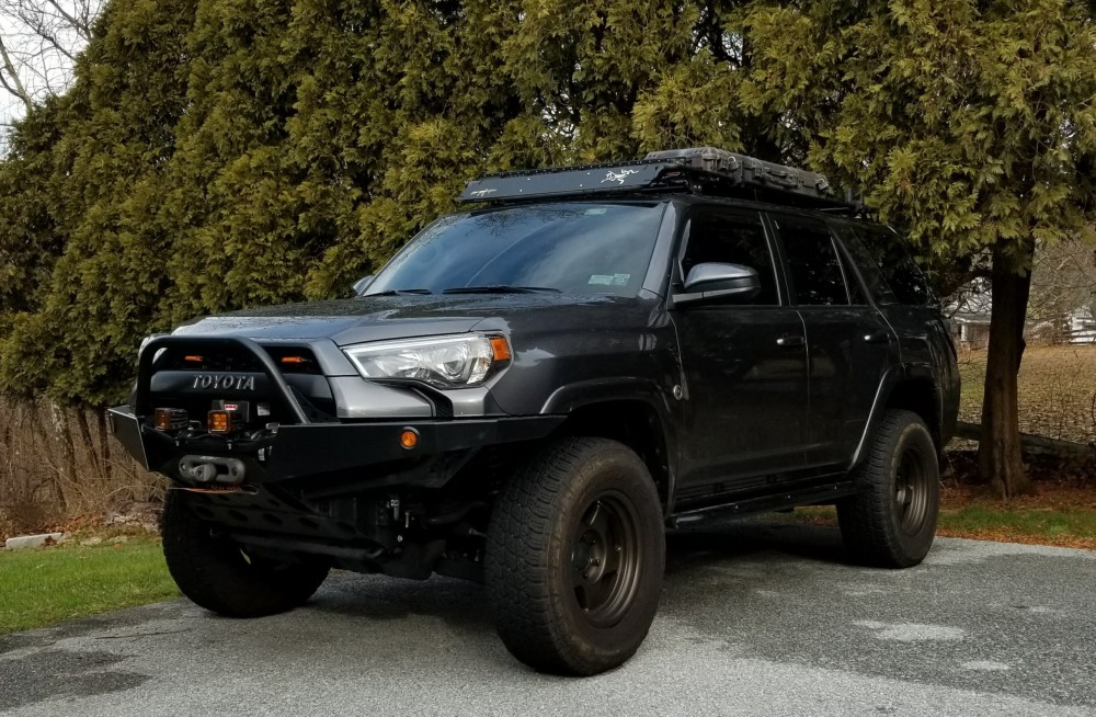

Mine has come tgether nicely. I have played around with a couple different light setups and settled on these ambers

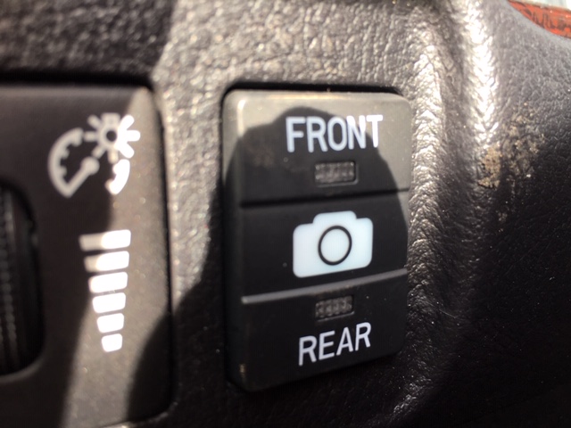

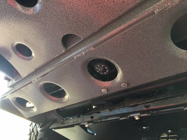

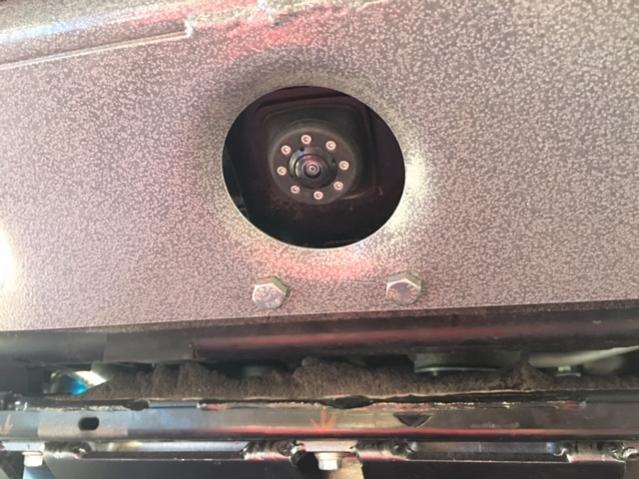

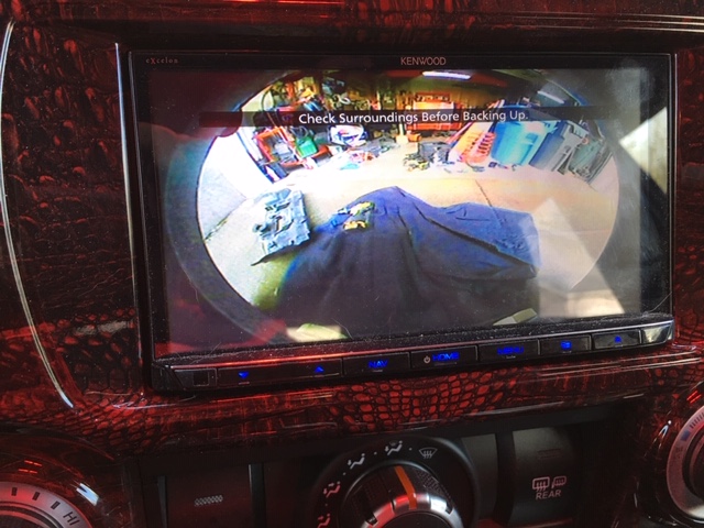

I installed a rock camera up inside one of the holes in the bumper so it protects the camera then a switch on the dash to turn it on at anytime on the head unit screen

Install mostly done. It looks beastly on the truck Click here to see more pics.
Still need to trim the bumper cover trim pieces and then get the bumper powder coated.
Decided not to run a winch for now, so will have the lightbar filling that space. Will weld some additional tabs on for it.
Looks like the winch can be easily put on without removing the bumper (huge bonus). The grill and one support will need to come off though, but super easy.
Fit is nice.
Install was easy (actually did it myself with no extra hands)
Clearance is amazing. 35" on the corners. Should be able to get a tire up on crazy stuff. Way more than the rest of the truck can deal with.
Requires a little bit of cutting... (shown in the pics)
Will do a full write up on the install once completely done.
Very pleased at this point.
Oh yea, Front end dropped 1/4". Hardly noticeable but have not driven it yet.
