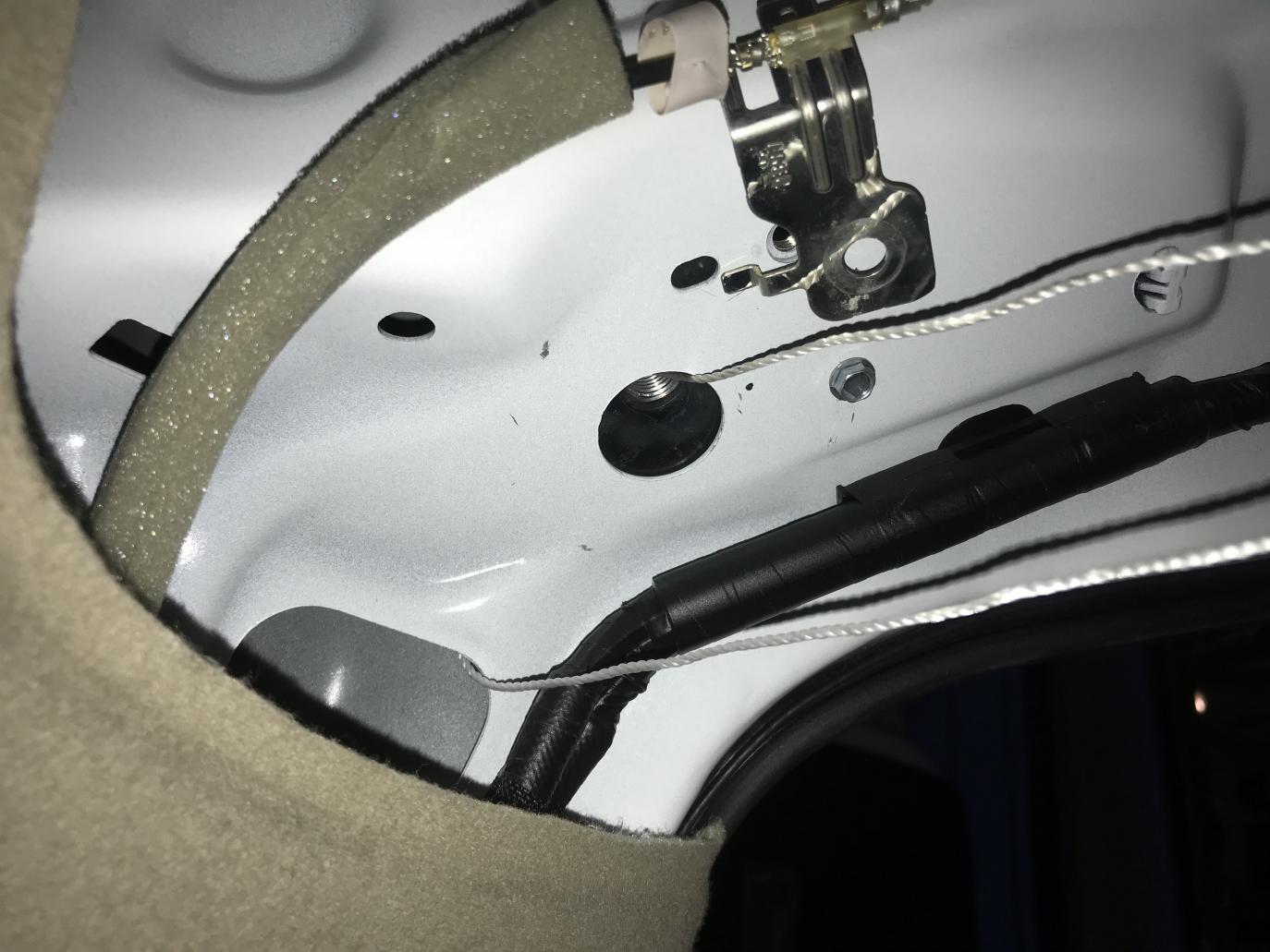

I'm attempting the swap pretty soon. One potential problem that I can already see is the mounting point for the seatbelts. The upper most mounting point (see pic) on 3rd row equipped 4runners has a nut welded behind the D pillar to receive a bolt. Mine has a hole but no nut welded behind it. Will need to figure out a way to properly bolt down the seatbelt.
That might be tricky. Can you get a nut in behind there?
or use a stainless steel rivnut? Possibly mounted on the back side?
Only thing I would be nervous about is if you are in an accident and actually needed the strength of that mount point to protect precious cargo.

its too tight to get a nut behind it. I may have to drill a hole to access that part which may or may not compromise structural integrity. I thought about rivnut but not sure if they make one big enough. ill get some pics up this weekend. Worse case, i can have someone weld in a nut.

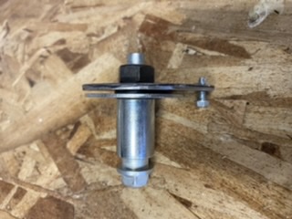

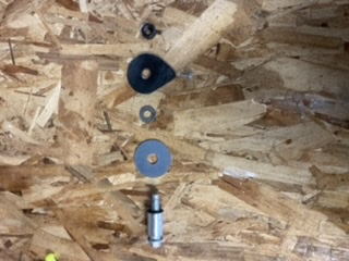

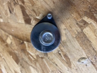

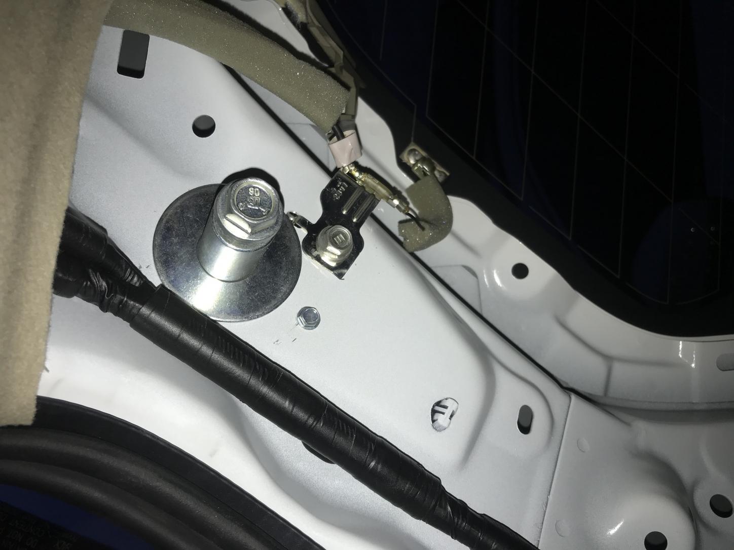

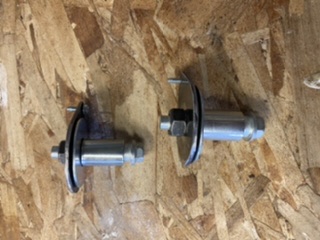

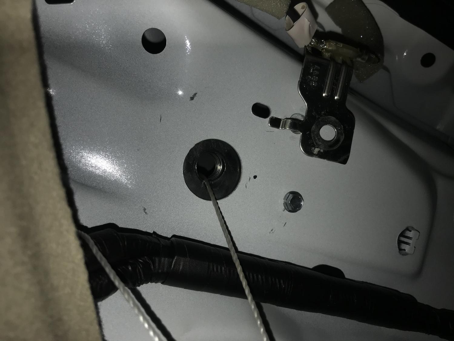

Here’s what I ended up doing with the top mount for the seat belts. I slid a plate with a nut welded to the back down from the top. I then held in position with a secondary bolt which also prevents the nut from spinning.
Now I need to figure out the lower mounts.
