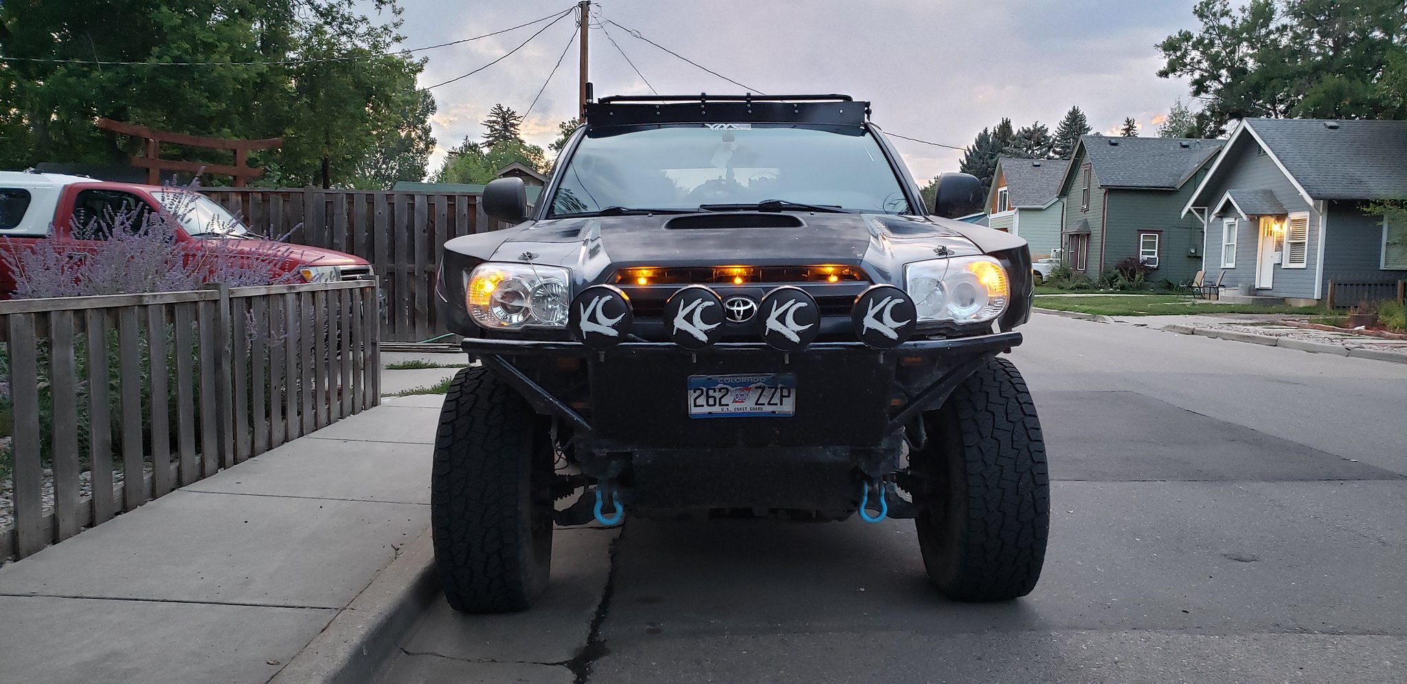

I actually took some rubber plugs from Lowes and drilled out the centers and installed 3/4" LED marker lights in the holes so they would match my Raptor lights.
