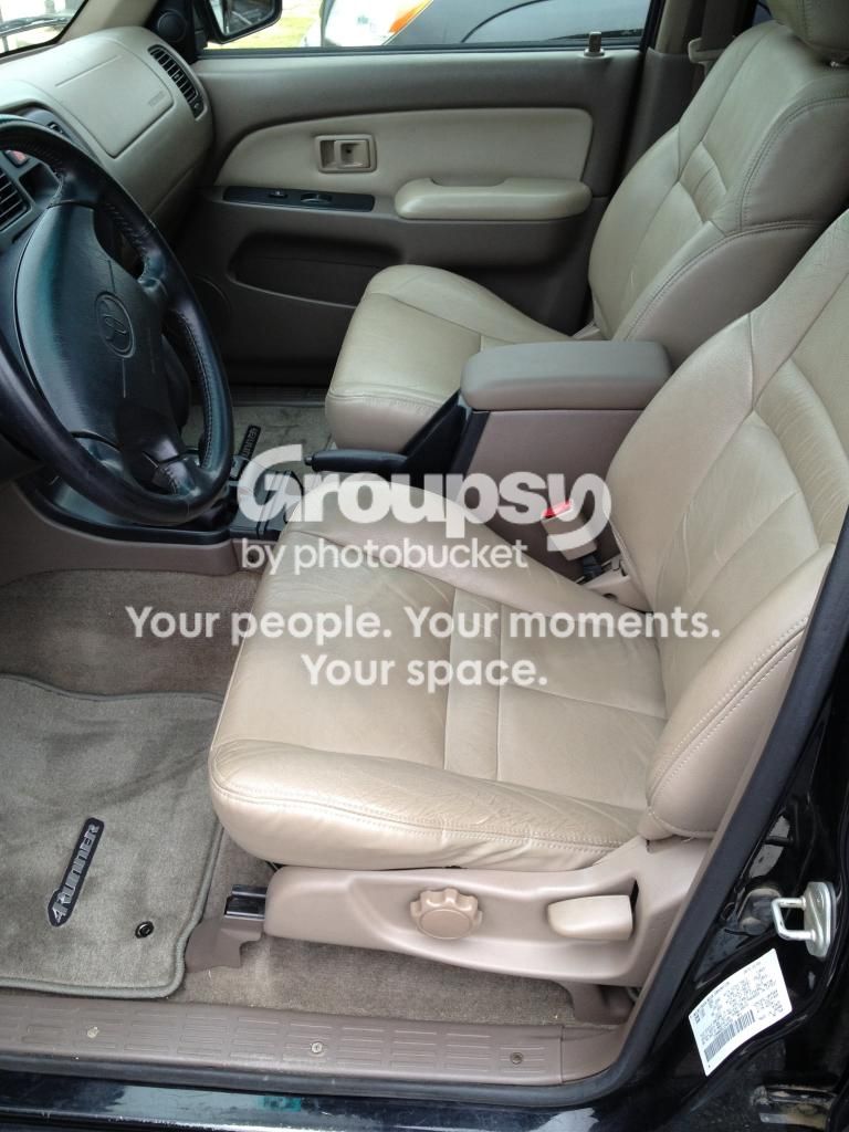

About a month ago I purchase an one owner 01 4runner with 111K miles. Has a few dings but overall is in great shape. With this build I was very tempted to SAS straight from the start. But after a little deliberation decided I would build it up the way I wanted and slowly peace together what I wanted for a SAS. I figure this way I can still enjoy wheeling and take my time to do the SAS the right way (not rushed).
Most of this build will be completed relatively quick. This is my 4th 3rd generation 4runner so for the most part I know what I want and I know what works.

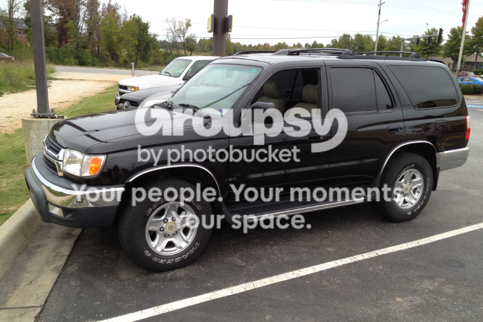

Day I brought it
IMG_2390.png~original
IMG_2377.jpg~original
IMG_2367.jpg~original

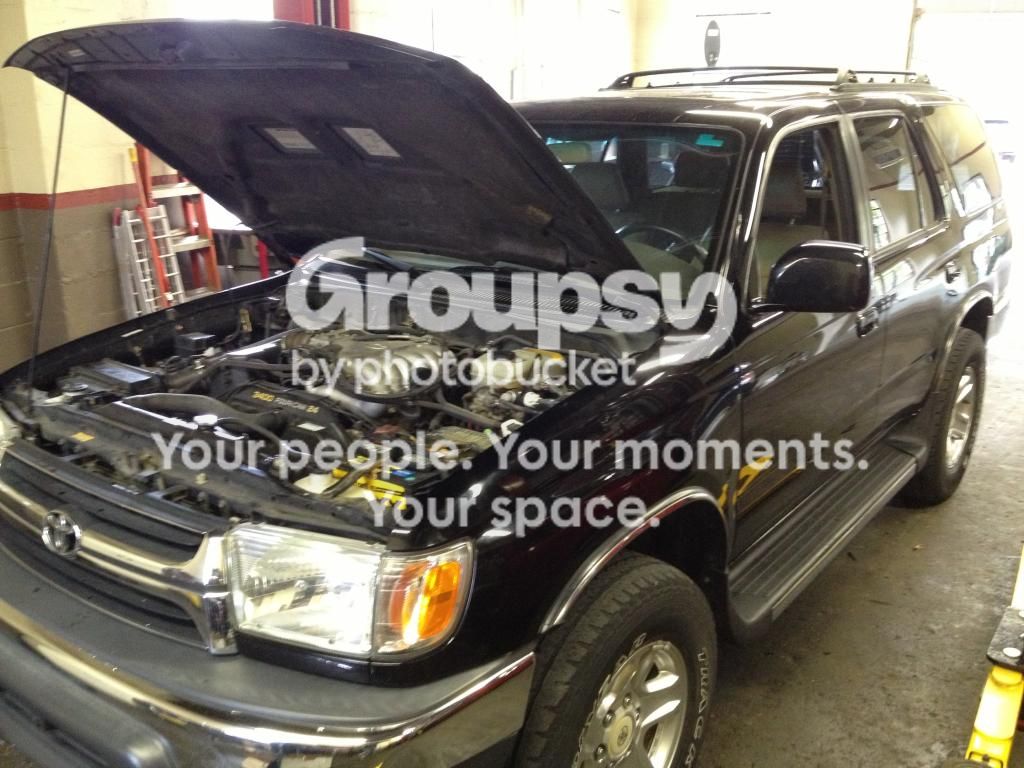

First thing I did was get the timing belt, water pump, belts, trans fluid, and transfer case fluid all changed out so I wouldn't have to worry about it.

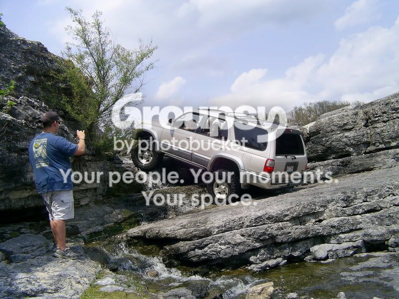

My First 4runner Limited 98 E-locker conversion on 33's Build specs:ADH8796 3rd gen - YotaTech Forums

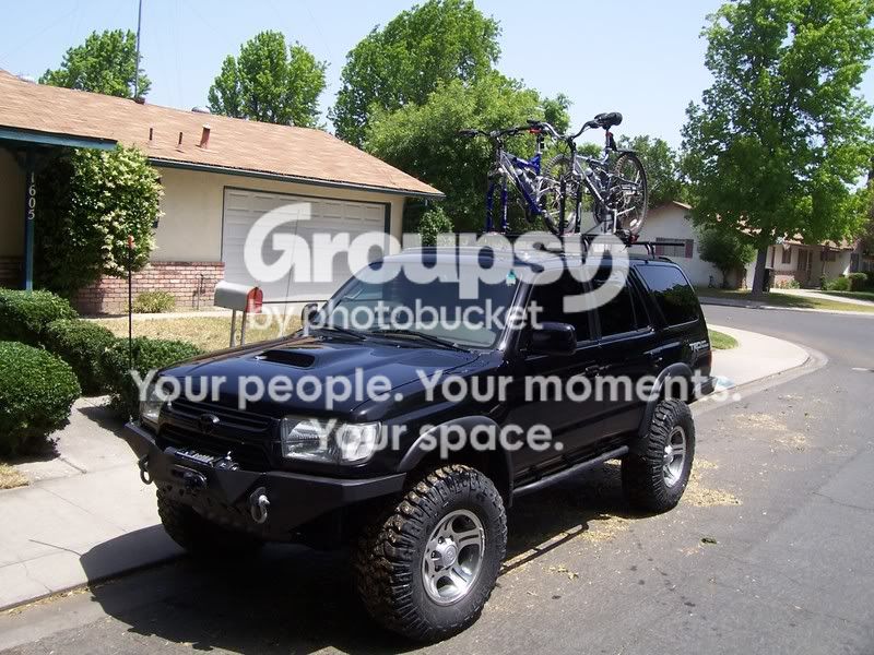

My Second 4runner 99 Highlander LR locker on 33's. Build specs: ADH8796's Black 1999 4runner 4WD Highlander Edition - YotaTech Forums

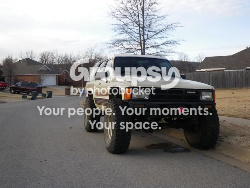

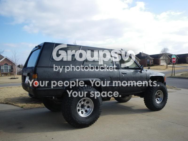

85 4runner no lift on 37's
IMGP0337.jpg~original
IMGP0392.jpg~original

Man I miss having bent up around.. That bumper you had on your 2nd 4runner was nicely done by them.
Great looking base. The others have looked sick too. Why do you go through them? Get bored after you build them?
Yeah that was a killer deal to I ordered it from them without mounting braket's since they only made them for the tacoma's and then built my own mounts. Then all I had to do was narrow it 1.5-2" on each side and it was done. Super slim and great approach angle. Only cost me like $500 if I recall.

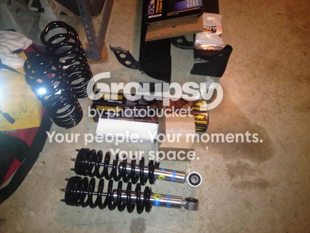

I ordered my front lift from Sonoran Steel. In the past I've run everything from spacers to full out coilovers. But the nicest ride I ever had was with my Tundra/OME setup and it flexed every bit as much as the coilovers. The rest of my lift I ordered from Toytec which included OME 891's, OME 60028 Comfort ride shocks, and 1" body lift.

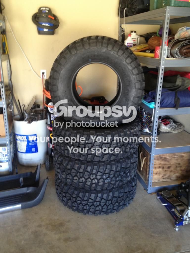

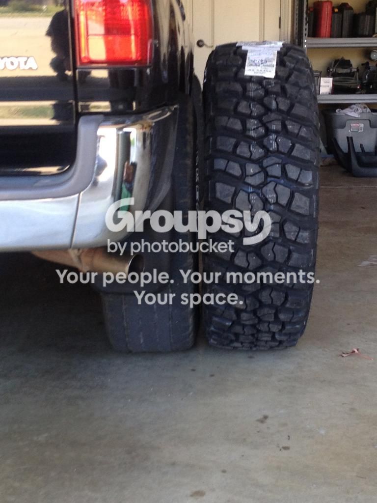

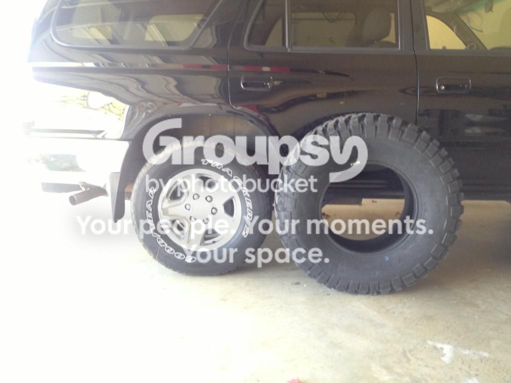

When it came to tires I already knew what I wanted. I've ran a few different sets of tires but in my opinion BFG KM2 is by far the best on/offroad tire available. My last set road very smooth on the road and hooked up great in the rocks, snow, and dirt. I can't say much about how they handle in muddy conditions (I hate mud) but I've heard good things. But when it came time to order them in the size I wanted 35x12.50R17 they were on nation wide backorder and I was looking at a six week wait time. So after calling around a little bit I found that Discount tire direct still had a set and was willing to beat any price I could find.
IMG_2421.jpg~original
IMG_2419.jpg~original
IMG_2418.jpg~original

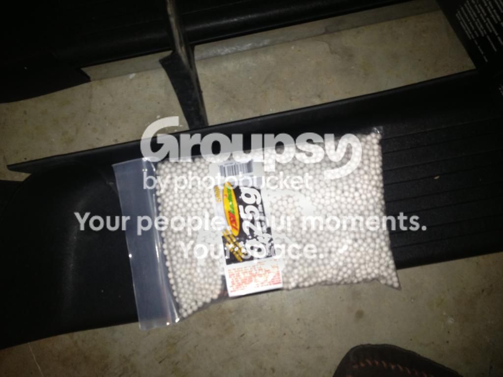

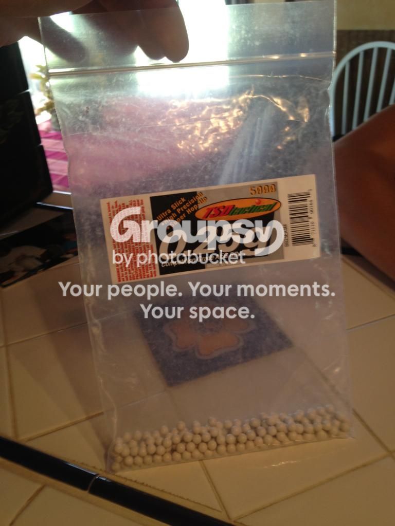

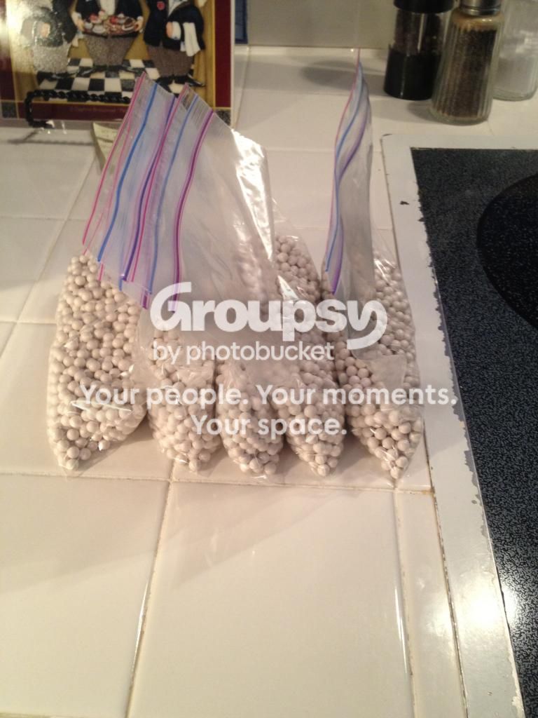

To balance the tires I'll be using 8.5 ounces of these per tire. Beats the heck out of sticky weights or standard wheel weights especially for a grand total of $17 for 5 tires.
IMG_2423.jpg~original
IMG_2503.jpg~original

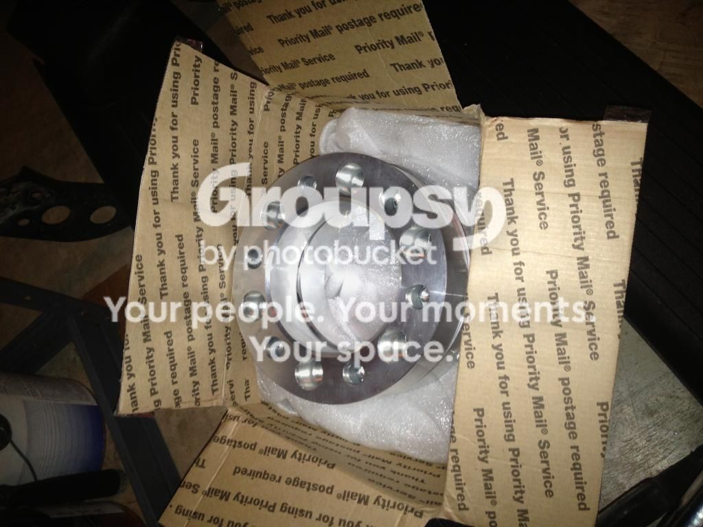

Also pickup up a vortex muffler,B&M tranny cooler, & some wheel spacers

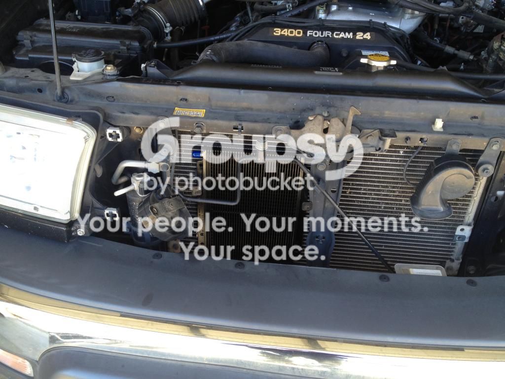

And finally got around to installing the tranny cooler and bypassing the OE cooler to avoid the pink milkshake effect
IMG_2489.jpg~original

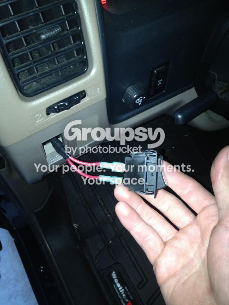

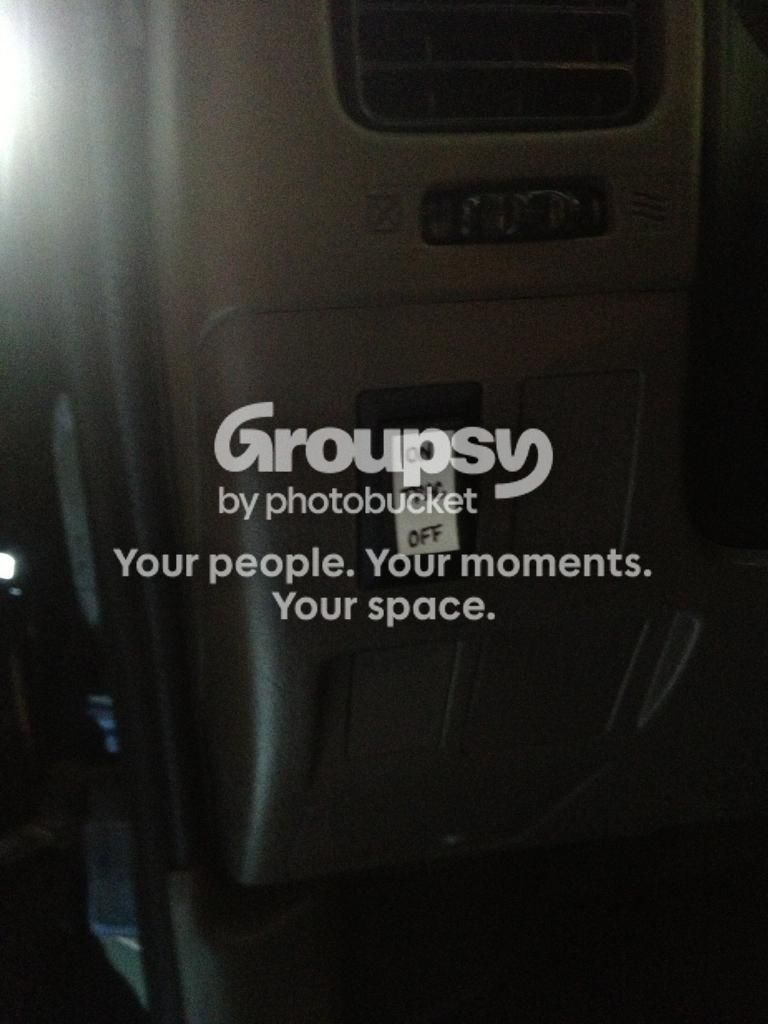

I also went ahead and disabled my DRL's and installed a switch to control ATRAC/VSC.
IMG_2505.jpg~original
And a temporary label for the switch
IMG_2510.jpg~original

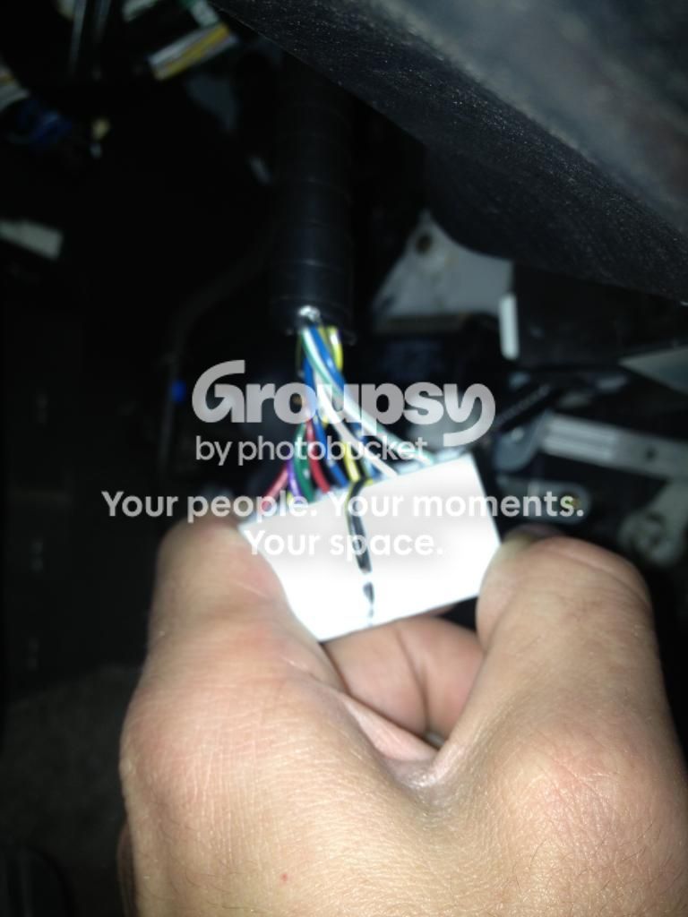

Disabling the DRLS was more simple than I would have thought just cut the wire.

Does 8.5oz of beads really do the trick for tires that big? I'd love to run beads if I have a good feeling that they'd work well. If they work, the tires stay balanced for the life of the tire....which is pretty sweet in my opinion.
Same here... I've always been curious about this tire balancing technique.
ADH, you should post a review of how those BB's work out for you once you get the wheels/tires mounted.
Lovin' it. :drummer:
I took a look at this chart to determine roughly how many ounces I needed per tire Aggressive Tire Chart this chart is specifically for Dyna beads but should work just fine for air soft apllication as well. The chart recommends 8oz per tire but adding more than you need won't hurt anything unlike not having enough.
I'll be sure to follow up with a review on how well they work.
