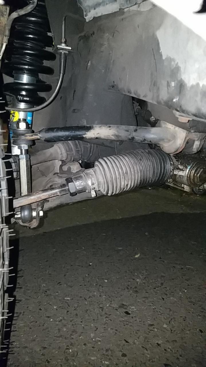

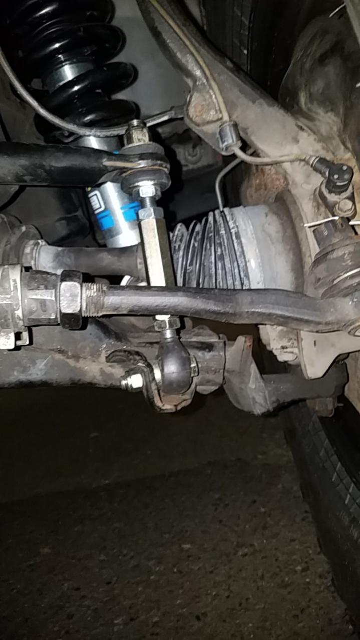

Here are pics of the length they're set at and how parallel the bar is to the road. Or should it be tilted to match the upsweep in the frame, is that what you guys are saying? Perfectly flat ground here
Update: maybe these pics work?

What brackets are holding the inner part of the Swaybar to the 4Runner? Can you post a pic of those? I had some crazy sounds with the Energy Suspension brackets and when I switched them out for (Dorman 928-361) and got them good and tight that quieted things down a lot.
