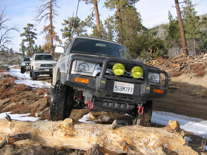

I got my shrouds from the retrofit source.
