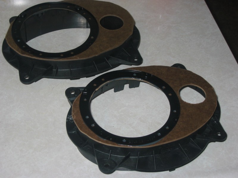

I have found the wiring to be even easier than described here while adapting for size to be harder.
I cut and spliced the speaker end of the wiring so it could plug into the source from the door. Couldn't be easier.
As for the 6x9 adapters, I purchased the same ones from cardomain and they didn't fit. Here is what I did:
The adapters are made of clipboards cut to sized with a band saw and dremel. Then I bonded this to the factory adapters. I think the factory adapters are the best adapters to use - they are strong, they fit, they have a shroud in the back to protect against water - cut out the factory speaker and use it.

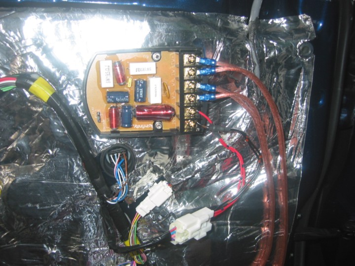

wiring
here is how i did the wiring.
I mounted the crossover where the tweeter was. Cut the plug from the tweeter, and wired that to the cross overs. This then plugs back into the source. The woofer part of the plug is unused. The factory wiring is the last two wires into the crossover. The first 4 go to my woofer and tweeter.
In this picture, you can also see the damplifier that I have put for vibration control. Also, I used Infinity Kappas. They sound great. The Reference speakers have 2 dB greater sensitivity, so can be considerably louder with the scion HU so they should be a great.
