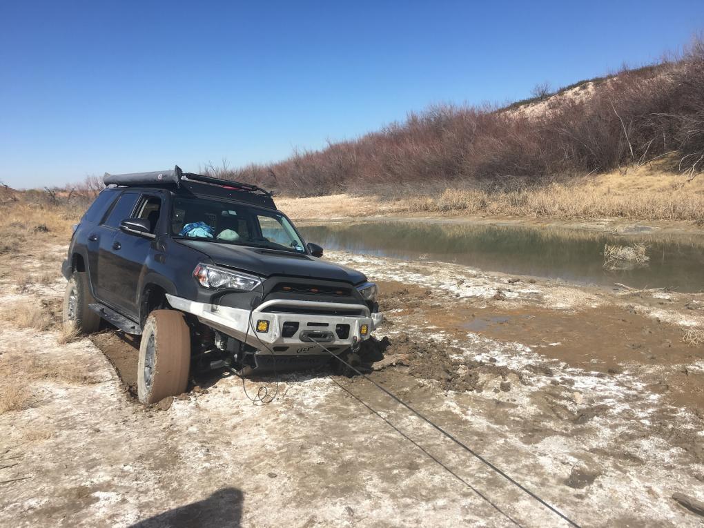

if you want fwd aux lighting for any reason, i would suggest a 20-30" bar or pods for the bumper. my cheapo roof lightbar has become a $60 airdam as it creates unnecessary glare across the hood.
I've had a winch for a year and a half and used it 3 times, twice for myself and once for another. admittedly it saved my ass in a riverbed of thick bottomless muck i was stupid enough to drive into just over a year ago
