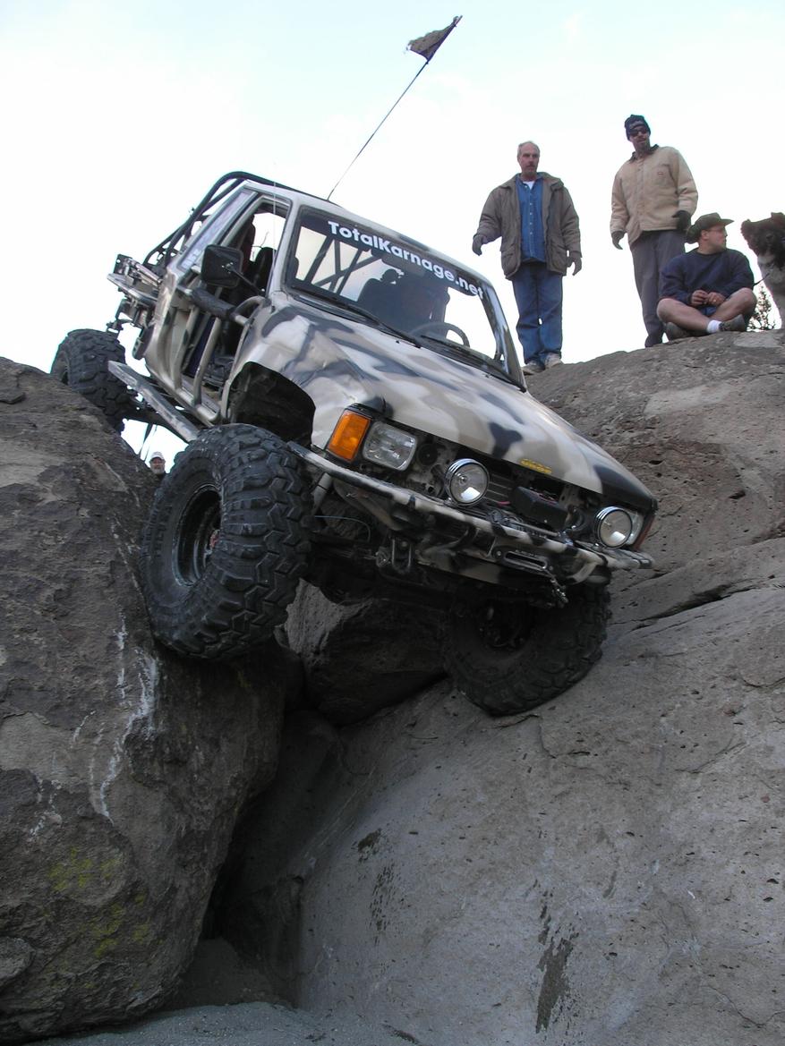

That's the opposite of my experience. I went through 9 35/12.50-15's on my Bronco, and only cut them when aired down, and all were sidewall slashes. I don't subscribe to the "squishy sidewalls conform to the rocks and don't cut" theory.
That's the main reason I went with SX's on my dedicated Toyota crawler. I ran em down to stupid low PSI and never cut a single one. Of course those tires weighed about 80lbs each.
And the ones you just posted the pic of are likely C range, but they're definitely bias ply. I ran the 38x12.5-15 SX on my Toyota....same thing, only cut one.
The SX is a steel belted BIAS ply tire though.
I think we're in violent agreement.
