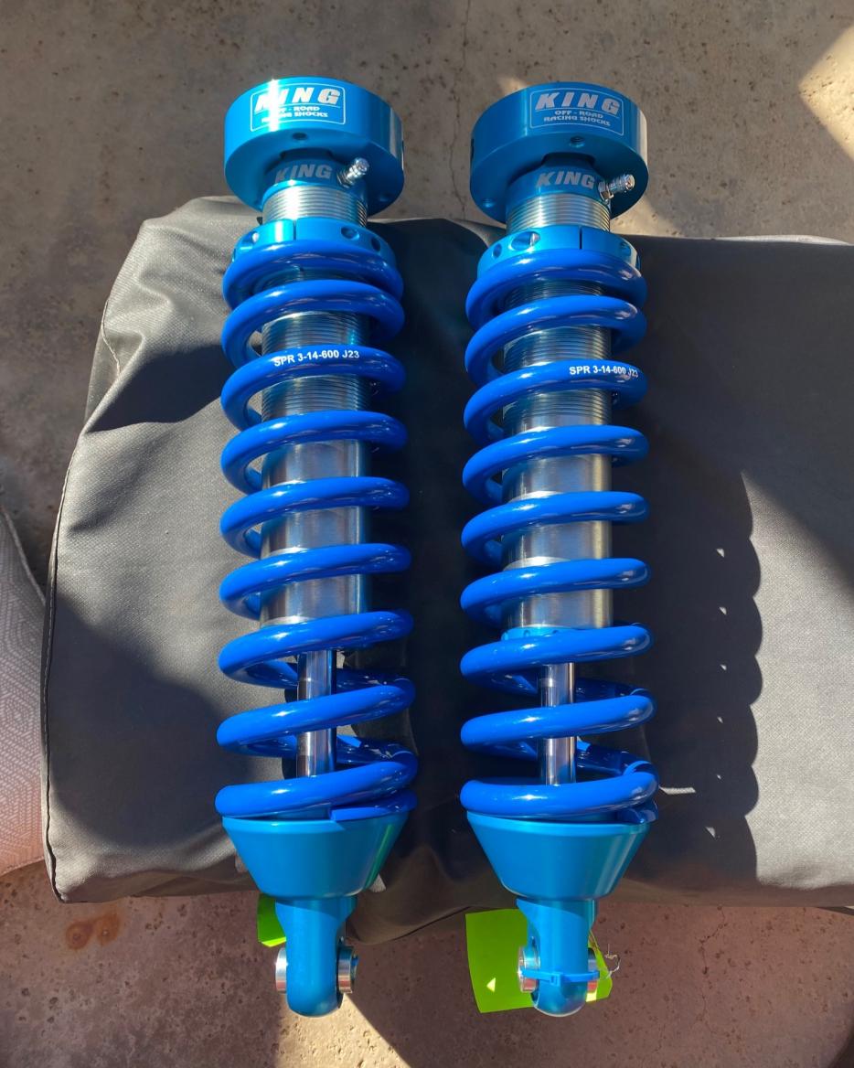

Suspension!

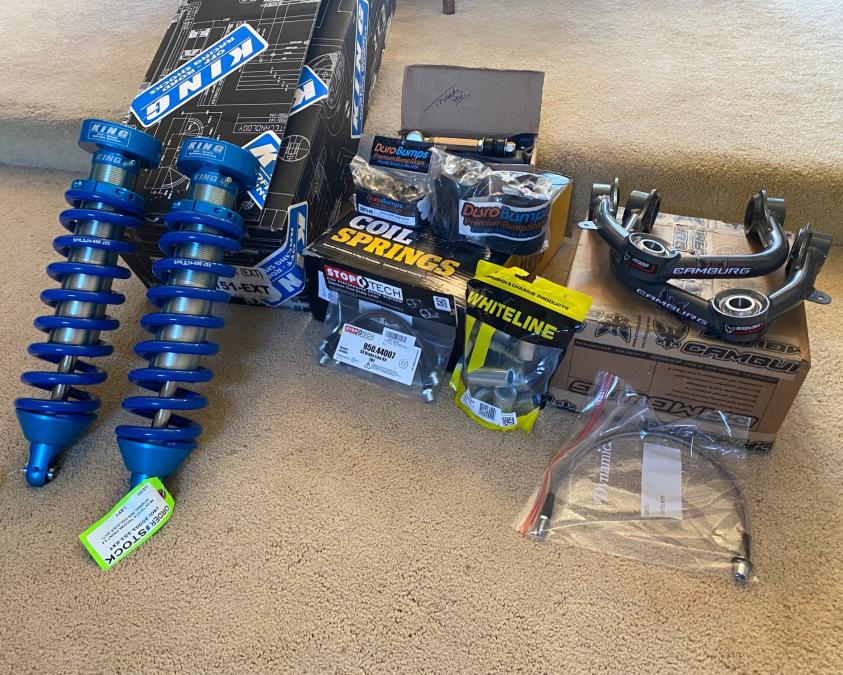

Hey guys little update here, I got some fun stuff!!

Incase it's hard to tell what all is in that picture here is a list:
- King OEM replacement coil shocks extended version
- Camburg 1.0 uniball UCA
- Durobumps Front / Rear. Front Primary only, Rear 3.5in version
- OME 906 rear coils
- Overland custom designs adjustable sway bar links
- Stoptech front stainless steel brake lines
- BTF rear extended brake line
- Whiteline poly. lower control arm bushings
I am still waiting on a couple things like the rear shocks and the alignment cam upgrade kit I purchased from KPOFFROAD. A set of the 5-way adjustable alignment octagons and bolts.
I scored a set of 2.5 rear king shocks that are going to be "gifted" to me. Just waiting for those to be rebuilt and I can then put them on. I can't wait to get them. Then I can start putting on all the fun stuff I got!

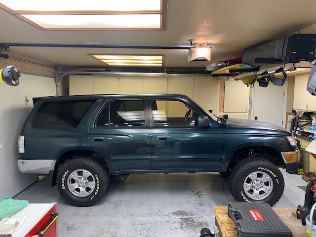

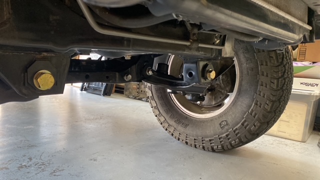

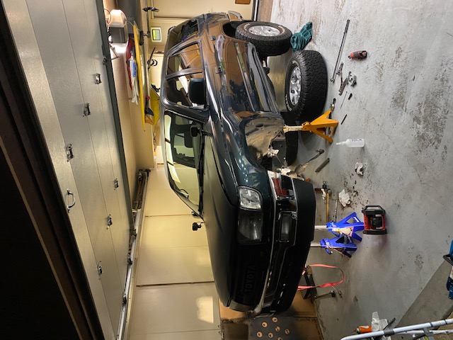

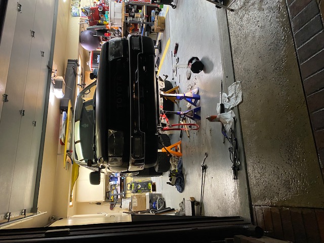

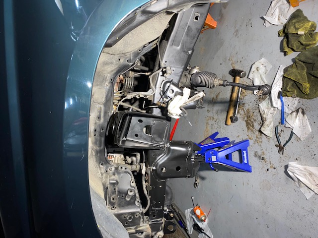

finally on!

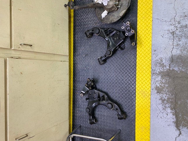

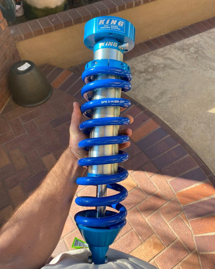

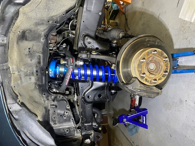

Finally got all the parts and little pieces and little stuff to get this job done. The kings are finally on in the front! Basically took the whole front end off. Took off the spindle the lower control arm the upper control arm. Installed the whiteline LCA bushings and the KPOffroad octogon cam kit, put the new stainless brake hoses on and the Camburg UCA's and of course the shocks themselves. Also spent a good amount of time cleaning everything up so it looks nice and fresh. so Stoked! Still waiting on the rear kings to come in they should be soon. I guess we'll be squatting for now. haha. Time for an alignment!

Awesome stuff! Gonna ride amazing with all those new parts.
How long did you have to wait for the Kings to come in?
Oh yeah i've already tested it out the front rides wayy better than before. I looked at my old shocks after I took them off and they say toyota on them. Kinda leads me to believe those are the original shocks lol. I've been going around town hitting every bump and obstacle I can haha. The difference is huge. I only waited about maybe a month to get them not very long. Is there supposed to be a long wait time on them?
Yeah last I heard they were like a year out haha. That's awesome though, where did you order from?
Great to hear about the improved ride. I know mine was a big difference when I replaced everything up front.
