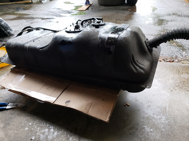

I found it fairly easy to do. Watched Tims video so I knew what I was up against. Main thing is I didn't run my tank down enough and thought I could syphon the remaining gas out. There's a baffle plate in the way and couldn't get a hose in all the way. So tank was a bit heavy. I just used a standard jack with plywood and then put it on a dolly to move it around. Remember to get the gasket like Tim said, also the filter screen.

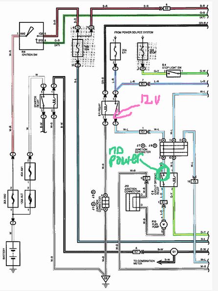

I replaced my original 350K+ pump last Summer with an oem. I was popping EFI fuses, thought it might have been the pump, ended up being an unrelated harness short. But I figured it was good preventive maintenance anyway being 20 years old with high mileage.
Hey Keith, glad our video helped you out. In regards to your EFI short, would it blow fuses all the time or just intermittently. I have a friend with the same problem but his seems heat related. His fuse popped on a Death Valley trip and it has also popped back home for him but only on hot days. I have heard that the fuel pump is the component on that EFI circuit that draws the most current from the system and could cause the fuse to blow. When the weather is cooler, his rig seems to be fine. It's my theory that the fuel pump is overheating causing a higher than normal current draw and popping the fuse.
I think I possibly asked you this before but could you share a picture showing exactly where you found your short?

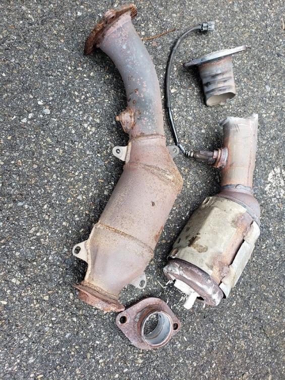

Initially I had a less than 1 yr old front cat break into 3 pieces and fell out onto the highway. The plug got a little messed up so I just threw in an an old cat temporarily til I could get a new rig side of plug soldered on, along with a new cat covered by warranty. I just let the plug hang free, it didn't look like it would cause a problem. I went a too long without repairing the plug (7 day work weeks, long hours grind). Was just getting a code for not plugging in the front cat, was running ok. But then it started popping EFI fuses. I ended up finding the front cat plastic plug end fell off later and it had a bare end lead end that was tapping metal and shorting out. So I repaired the harness and has been good ever since. It was my fault anyway, just prolonged a repair I should have taken care of right away.
So maybe an area to look at, that harness and maybe possible the front 02 sensor can maybe short out internally.
Here is a pic of my exploded cat, next to the temp one I put back in. Also a pic of the EFI circuit diagram, not good image. But these are available online in large PDF.

Initially I had a less than 1 yr old front cat break into 3 pieces and fell out onto the highway. The plug got a little messed up so I just threw in an an old cat temporarily til I good get a new rig side of plug soldered on. I just let the plug hang free, it didn't look like it would cause a problem. I went a too long without repairing the plug (7 day work weeks, long hours grind). Was just getting a code for not plugging in the front cat, was running ok. But then it started popping EFI fuses. I ended up finding the front cat plastic plug end fell off later and it had a bare end that lead end that was tapping metal and shorting out. So I repaired the harness and has been good ever since. It was my fault anyway, just prolonged a repair I should have taken care of right away.
Ok, thanks. My buddy Aaron doesn't have any obvious wiring issues so the search for the culprit continues.
