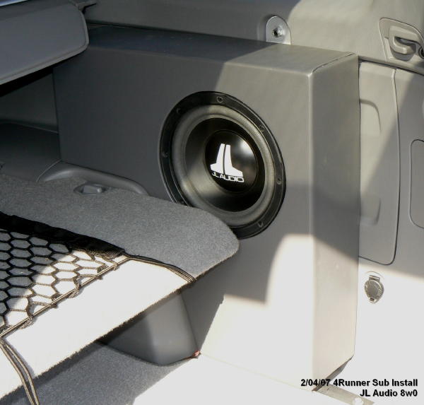

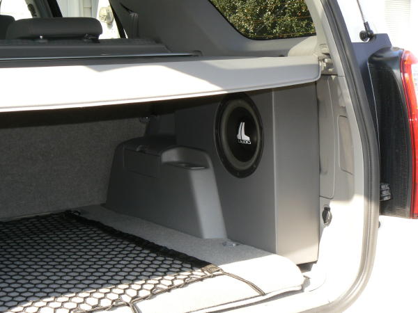

Pics of Psudo stealth install
If I can get these to load...

Looks great! Full use of the DD shelf too. I think the 8W0 can only see 200w rms, so you won't get that to thump in the big cabin of a 4R, especially firing into open air and not into a side or real panel. Have you looked into retrofitting a 10" in that box? One with a shallow mounting depth and small sealed box requirements.. IDQ or ED, for example.

I have used this sub because it was left from a Tacoma I had.
The box was built to the JL 8W0 spec and is right at .3 cuft.
This week, with any luck, I will be getting my new amp and front door speakers as well as some Raamat . When I get the whole system together and tuned up, I'll decide if a larger sub is needed. I have looked at the ED SQ10.
