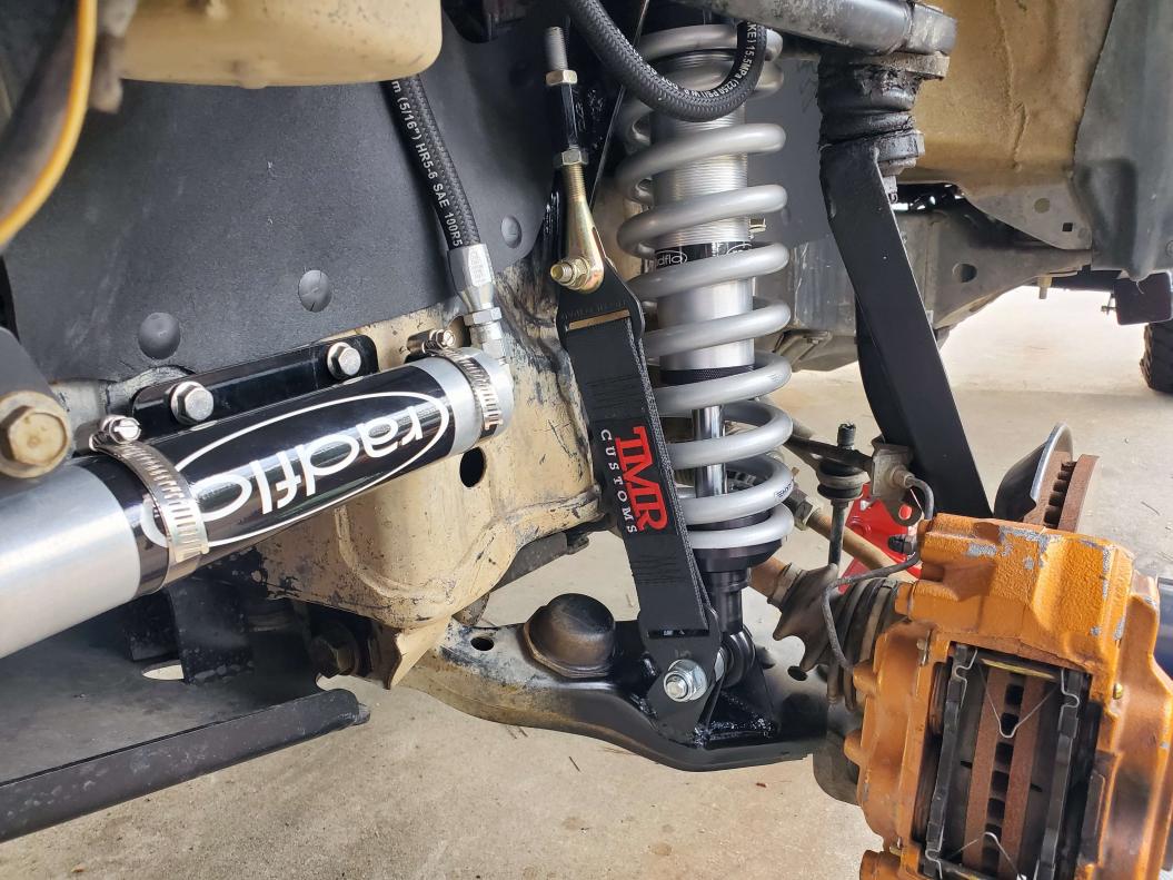

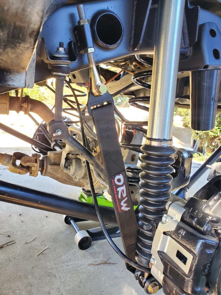

This is what I did for limit straps. Currently my manual hub cv's are extremely limiting my down travel. I didn't want to run a super short limit strap in the front, for strap mount clerance reasons.
I diy'ed the control arm double shear bracket out of 1/8 steel. It just barley clears the coil over. Shortly after that pic, I removed the rear swaybar completely. Don't notice any difference and flex is more smooth.

I went with 10 inches for the front and 17 inches for the rear. But it all depends on your set up unfortunately. I'm running a 10 inch rear shock outboarded w/arcworks kit.
Eta: I really like orw's (off road warehouse) limit straps, exactly like tmr's just cheaper.

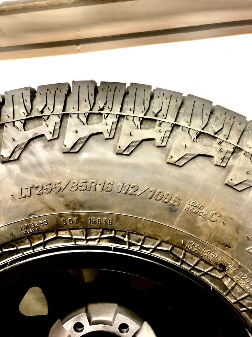

I am running WildpeaK AT4W LT255/85R16 112/109S Load Range C at
+/- 18 PSI off road.. Maybe I expect too much. I don't carry the spare tire usually and it's here in my office at work LOL.....

New tires will need time to break in. So go out, lower the tires psi and get in a rocky trail/rough trail(makes side walls flex). It should also soften up a bit too.
It was like that for my baja boss at in load E. A bit harsh, but after broken in, its plush, but I run them at 15 psi when I'm off road.

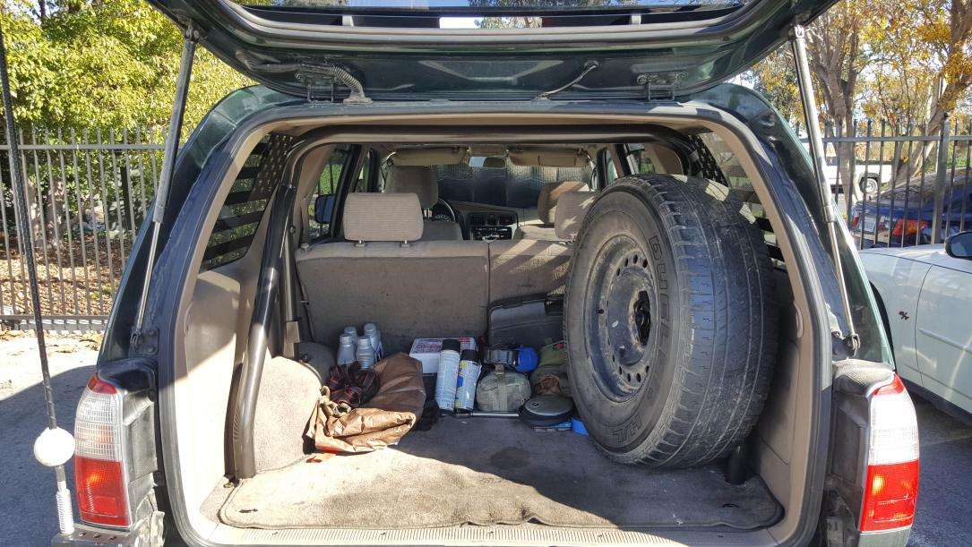

So far they are nice. Anything would be better that the clapped-out Patagonia M/T 32s, though - they got cupped, lost chunks of tread, and were loud AF! These feel great on the road and are quiet. Supposedly they re-engineered the tread compound and pattern. I never felt "my tires are too skinny" in sand or on rocks, but then I'm just enjoying having new tires, period. I'm not qualified to tell the diff between a 255 and a 305 to be honest. I'm sure some fatties would be nice, too. Ah - the spare. Yes I need do do something about that. 33s are big and heavy! It would suck to get one back up on my rooftop platform alone. I do carry a plug kit, some Gluetreads, and a compressor. It's kind of irresponsible not to carry it, but I was sleeping in it and had space issues.....it's on the list......

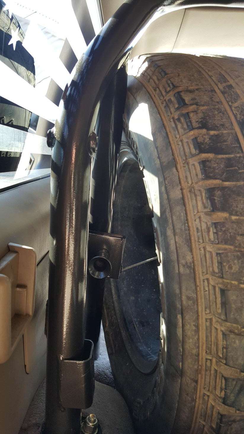

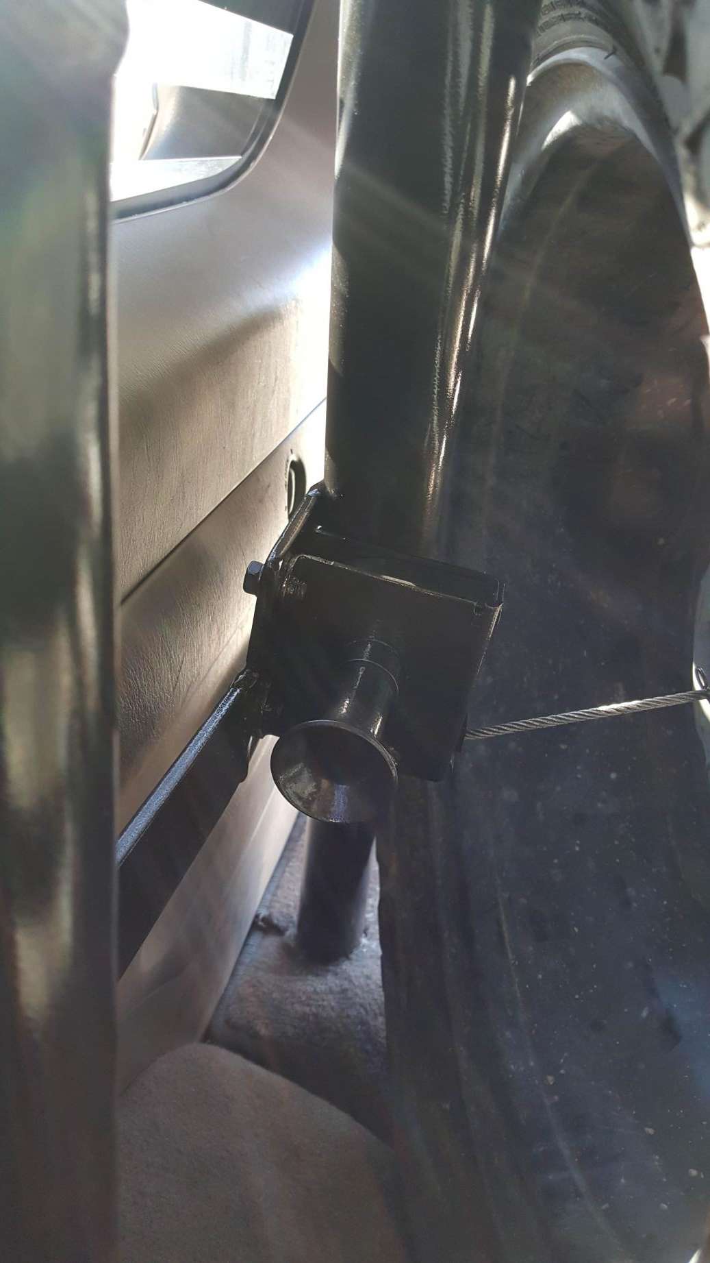

Find a 1st gen 4runner roll bar, mod the 2 front mounts, use the 4runner stock spare wire crank carrier thingy. Mount the spare in the back! I did this specifically to fit a 255/85 tire, as I didn't want it hanging off the back.

I like that a lot. I also remember someone fabbing an inside spare mount bracket and trying to sell it here. My only issue is that I need drawers to keep gear from flying all over on trails and I sleep inside. I could stand up the spare on one side and have a single, wider drawer and sleeping platform....
