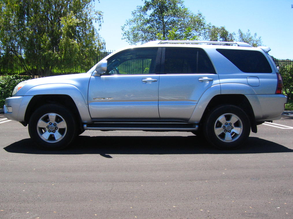

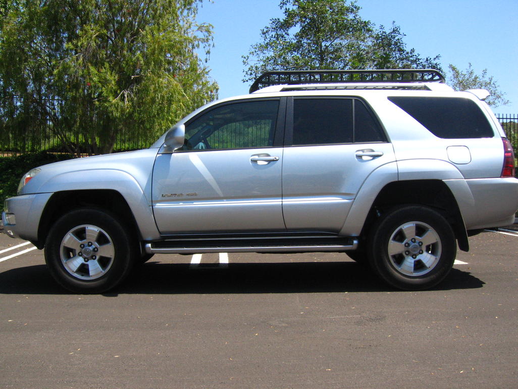

A few pics
Okay here's a few. I'm not very good at the photography stuff, but you can see the front is a little higher than the rear. This is with the 5100's installed with stock springs and set at the 1.75"(3rd position) on the shock. I think the 1.5" spacers with settle it out nicely.

Looks nice!
I'm just amazed at the variables that come into play when estimating how the 5100's set up would look, as far as which notch we use and whether it's with FJ springs or not. It just strikes me as being very inconsistent and rather unpredictable.
I have mine set on 1.75", with almost brand new FJ 4x4 springs (900 miles), which by themselves is supposed to provide even a bit more lift. But look what I had when it was done - no way I was going to put a spacer on the rear! I remember some of you were suspecting that I was going to get a "bro-lift" when I said I was going to use the 1.75" setting :)
And the funny thing is the brush guard is very light weight actually and V8 can't be that much heavier than the V6! See pictures below.

Sorry, but I neglected to get measurement before the install. I was in a hurry to get this done before leaving for vacation with my runner loaded down with about 400lbs of gear plus 4 people. Currently with the 5100's stock springs all around and a Daystar 1.5" coil spacer here's my measurements. My runner is a limited V8 model
Front - 35.5"
Reaer - 37"
Here's a pic as she sits now.
