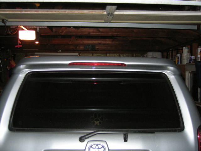

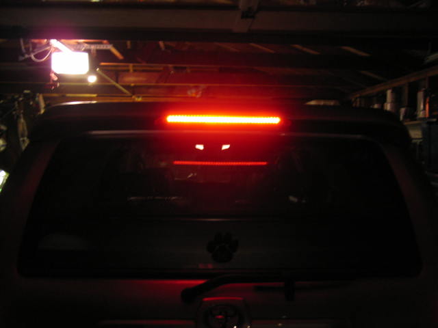

A few weeks ago my spoiler was damaged by an access gate at the parking garage at my work. After the stealership's $911 + dollar estimate and a few others over $1k. Can you believe the stealership was cheaper than a few body shops??!! Anyway, I decided to look for different options. I found a replica factory spoiler, painted to order at www.thespoilerfactory.com for $209 delivered to my door. Well I finally installed it and I like it a little better than the stock spoiler. It uses LEDs for the collision light and looks more streamlined. Here's a few pics

Thanks. Install wasn't bad, but I dropped a piece of debris between the panels and every time I open the lift gate I hear it rattling around. Pisses me off a bit.

Looks really nice!
I've been thinking about getting a spoiler for my truck and have been looking into the aftermarket ones. I like the location of the CHMSL on the factory spoiler better than the aftermarket ones, but I can't justify the cost since they're almost identical.
Thanks for the pictures, I think I'm going to go for the aftermarket spoiler in a few months.

BTW, another nice thing about LEDs... they illuminite several milliseconds faster than a bulb, giving the guy behind you precious seconds to hit his brakes. At highways speeds, that makes the difference between a near miss and a collision. The LED on your spoiler looks nice and bright! You might also consider adding a brake light flasher to gain some extra attention... :awais: The CHMSL flashes several times then goes solid with this one:

Thanks for the info. Looks like a good idea with a new little one on the way. Install was easy due to the holes already being there, as you stated the spoiler came with 3 holes on each side and double sided tape. I didn't use all the holes, spliced the 2 brake light wires and it went on relatively easy. Definitely a better value than the stock spoiler. In fact, when I chatted with the guys from the spoiler factory, they said that dealerships often order spoilers from them. I'd be pissed if the stealership bought an aftermarket spoiler for $209 and charged me $750. I would have to agree, if you don't have a spoiler now, let your body shop do it. Not the easiest place to match up holes.
