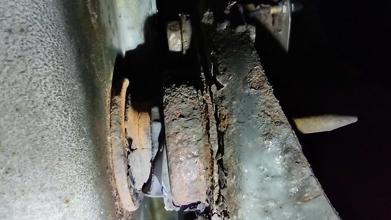

Old one. sorry it's rotated... turn your head to the left.

I might be more worried about the mount and rust? that is kind of a lot of cancer? none of that stuff is coming off without fire and a lot of bacon.
