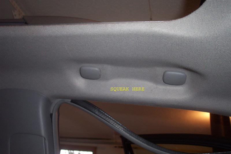

What a relief!! I had a very small headliner rattle/squeak over my left ear. SUPER annoying! It started a couple weeks ago, so I arranged to have the Toyota "service" dept look at it. I did not have great expectations of them fixing it, but some small hope lingered.

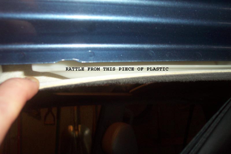

You guessed right if you think it did NOTHING for the problem. He didn't even try. So after doing some Christmas shopping today, and hearing that f&$%ing rattle over my ear, I parked in my garage and did my own looking. Only took 5 minutes to actually find a loose piece of headline support plastic!!! It was the exact place I told them the rattle was coming from!! Lazy A$$ technician!!
All I had to do was pull down the window weatherstrip, move the actual headliner down. and there was a plastic support which clips into the roof. It was the only piece (there are a few) which was obviously loose. In fact when I flicked it, the exact rattle was there!!! SOB!! I pulled a couple of the pieces of foam out of the headliner where the tech had stuffed it, and folded it and stuffed it next to the trim piece between the headliner. Pushed the weather strip back on and the squeak/rattle is banished!!!

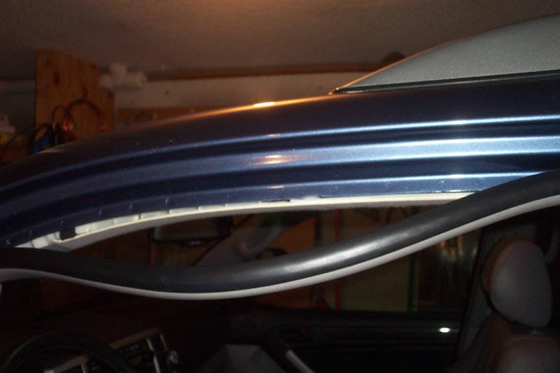

One last picture
The weatherstrip pulled down, really easy to take off and press back on. The loose plastic clip is between the headliner and the roof

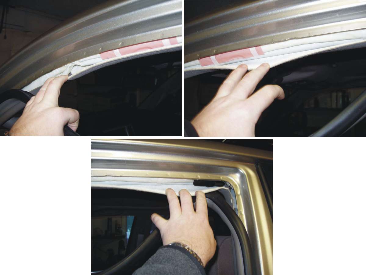

great string and photos. I've got a little rattle in the exact same place as your photo shows a squeak. However, I've got the side air-bag curtains right there and do not want to do anything that might interfere with their deployment. Do you or any other members of this forum have any ideas?
To carina71
You should at least be able to pull the window seal off the door frame and take a look. Is it that different from a vehicle that doesn't have the airbag curtains?
Re: To carina71
Yeah, it is different--here's some pics. Ironically, after I peeled the window seal off the first time to take a look and then replaced the the rattle seemed to disappear on its own (so I must have moved something just enough). Now, as long as I didn't undo what I had done before while taking these pics it should still be okay--I guess we will see...
