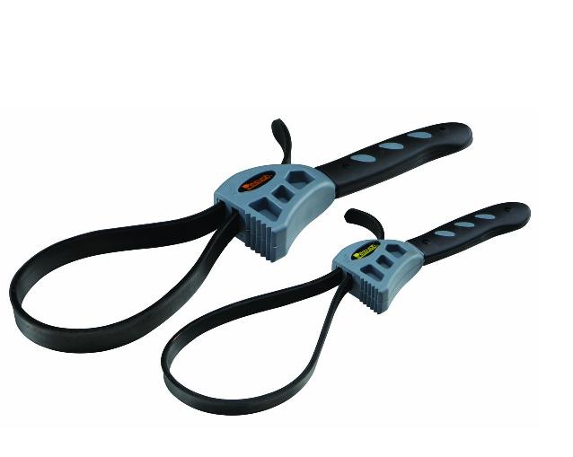

Those front shocks are usually pretty hard to get off. That top mount in the engine bay is usually the worst amongst the shock removal mainly because the shock body will turn when you try to turn the top nut. I'll get a pic of the tool I used to hold the shock body from underneath while my buddy put a ratchet on the top nut.

Check the add it's on wheels with just a frame, body is gone. And I'm glad I didn't try to solo mission this one. Alright well I'm gonna fly you out here to help me. See you tomorrow, lol just kidding. I'll prob get my cousin to help. And any clue where I can get that tool? Auto zOne?

Those rubber strap wrenches are at most places that sell tools. Harbor freight has them for $5 but it would it probably be better to undo the bottom shock mount and break the shocks off if the owner will let you. I'm not saying they will be easy to break off but it would be quicker for sure.

And I'm going to get that wrench thang (car and driver cupon)
