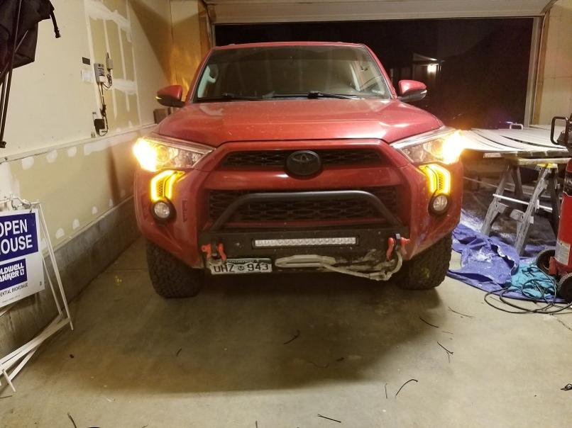

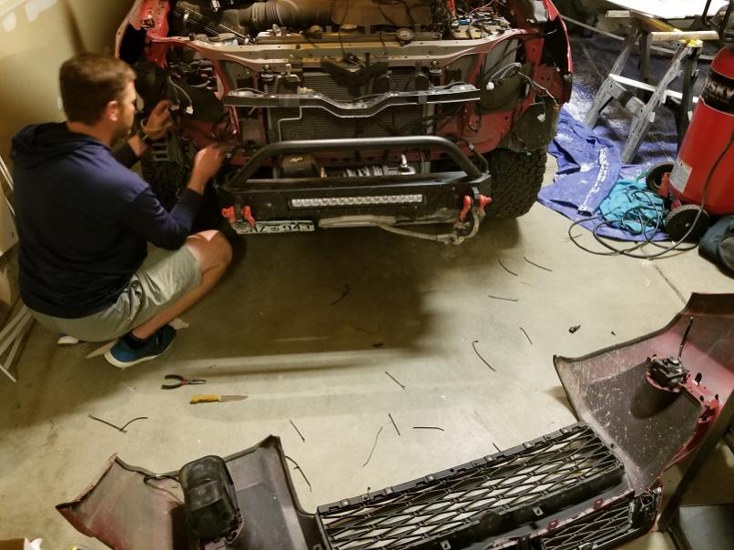

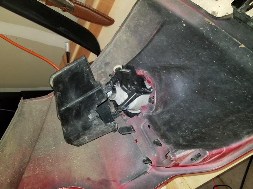

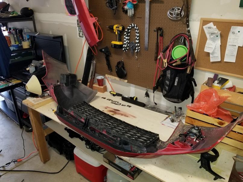

Got the kit installed last night. I've gotten pretty accustomed to removing my front bumper after the SSO Slimline install, so I saved some time there compared to someone who's never removed theirs before. It was pretty easy to remove the old fog light bezels and pop the new ones in, though for some reason the passenger side has a shroud over it that was harder for me to remove than it should have been.
I'm no expert regarding anything electrical, and the instructions where a little vague in some areas. There were a couple of pictures with the instructions, but there weren't any that helped me with the part I was stuck on. I obviously ended up figuring it out, but was a little frustrated at one point. It was much easier to just remove the headlights to work with the wiring rather than reach up behind the fender liner like the instructions said to do. The kit came with two wire taps, one for each side. Of course I snapped one in half right away as I tried to apply it. I still ended up getting it to work, and I just wrapped it with Electrical tape to keep it snugly in place.

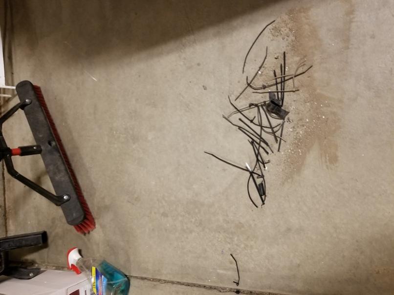

I used a lot of electrical tape to hold the connections tight and sealed, and I used a LOT of zip ties to secure the harness. As you can see, I went through some trial and error with the harness positioning in order to get the connections to reach the appropriate places, resulting in some wasted zip ties.

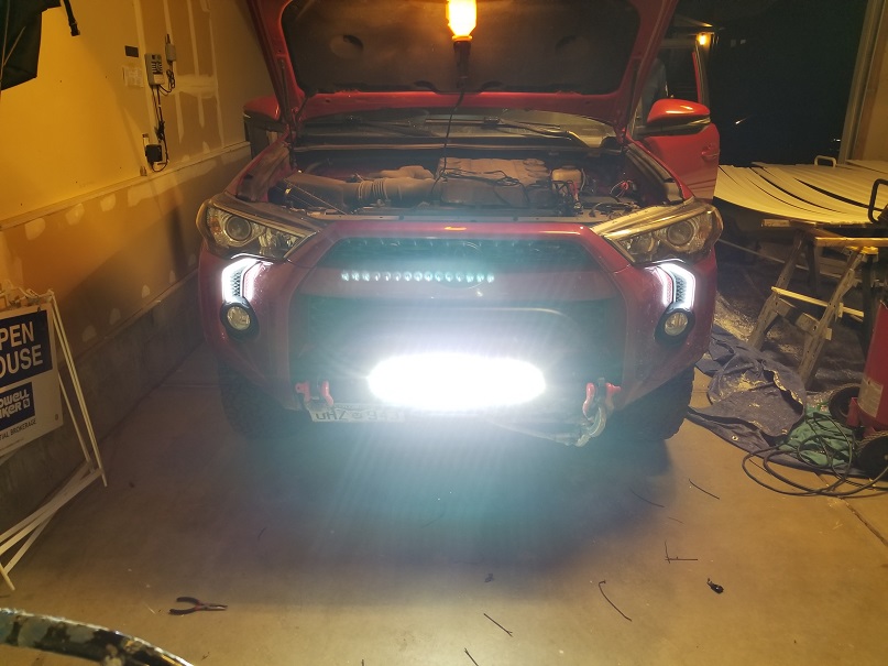

Overall, I think it turned out very well, and I think it looks great. Happy to have the whole thing behind me now.
