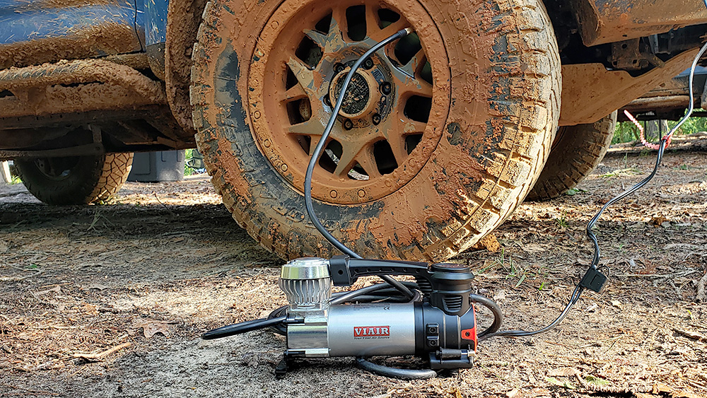

I've got a VIAIR 88P, and have been super happy with it. Hard to beat the bang for the buck, and it sounds like one that is perfect for your needs.
I wrote this article about it, and included some info about inflation times, and a quick/easy mod that I did to my compressor.
VIAIR 88P Portable Air Compressor Review + Quick Release Air Chuck
