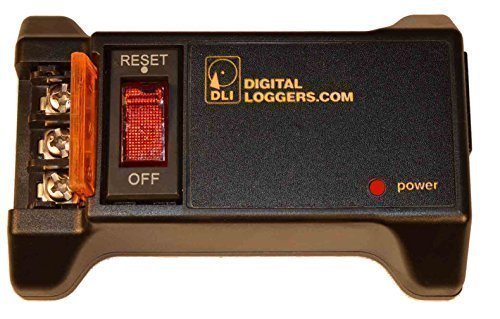

I'm thinking of the following configuration.
  • AC/DC Power Relay plugged into the rear 110v outlet
  • Viair 450p plugged into the rear 12v outlet with the relay controlling the power
  • Viair 450p in some type of enclosure (ammo can, plastic bin, ...) and secured in the cargo area
  • AC/DC Power Relay is located in the storage enclosure

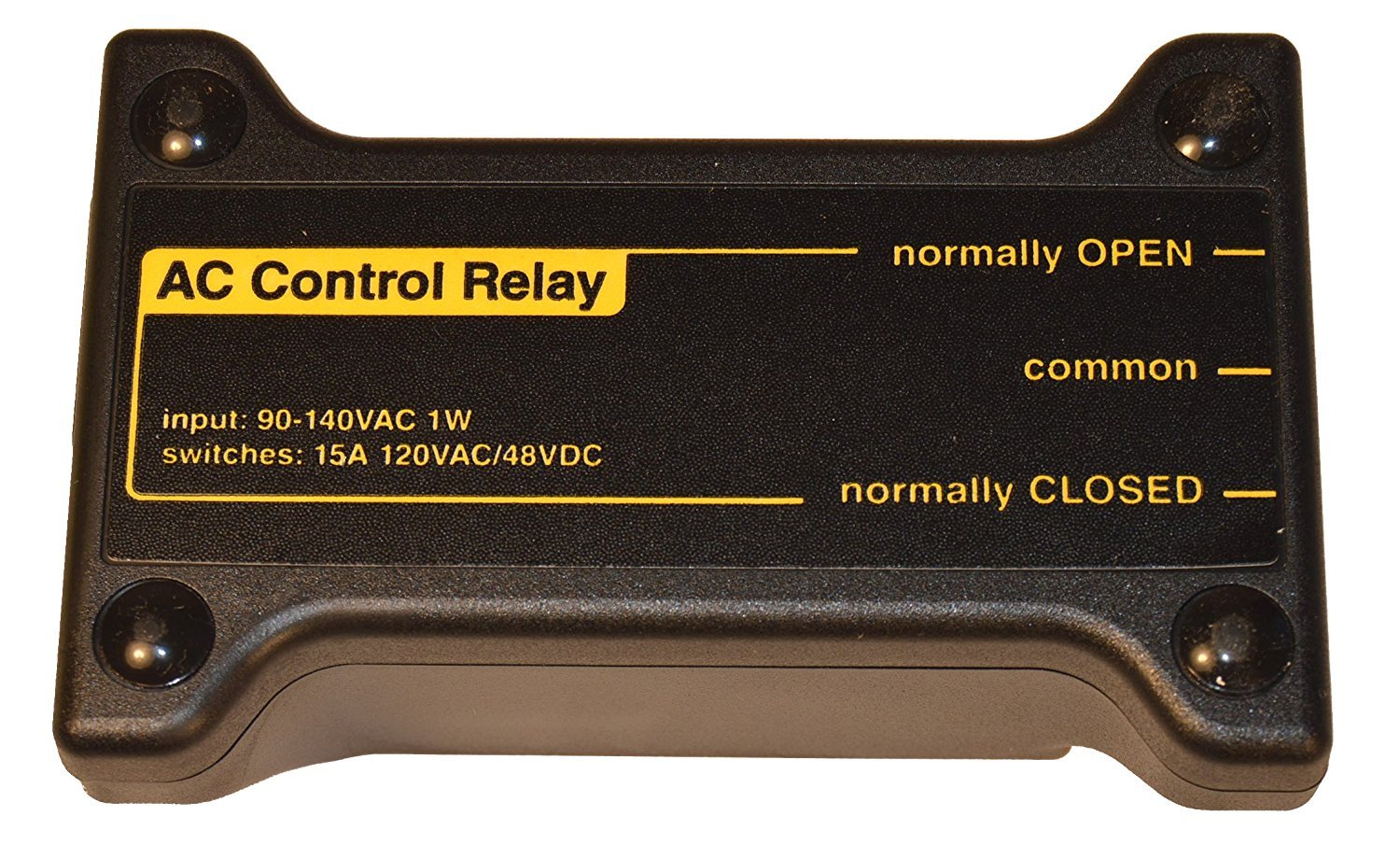

Using the compressor
  • Turning on the 110v plug activates the relay
  • The relay allows power to flow to the compressor that is switched on
  • MTB tires are filled
  • 4Runner is turned off or 110v plug is turned off

Enclosed AC/DC Power Relay with Protection & De-Bounce. Screw Terminals. 120V Trigger Input. by DLI
https://www.amazon.com/Enclosed-AC-Protection-Bounce-Terminals/dp/B017743I7S
Price: $12.95
Safe and easy to install. Controls any AC or DC device.
Durable high current relay for long life and reliable switching.
De-bounce circuit for safety. Dry contact relay output - connect to any voltage circuit.
Thermal switch and circuit breaker add safety, limiting current to 15 Amps.
Includes detachable power cord.

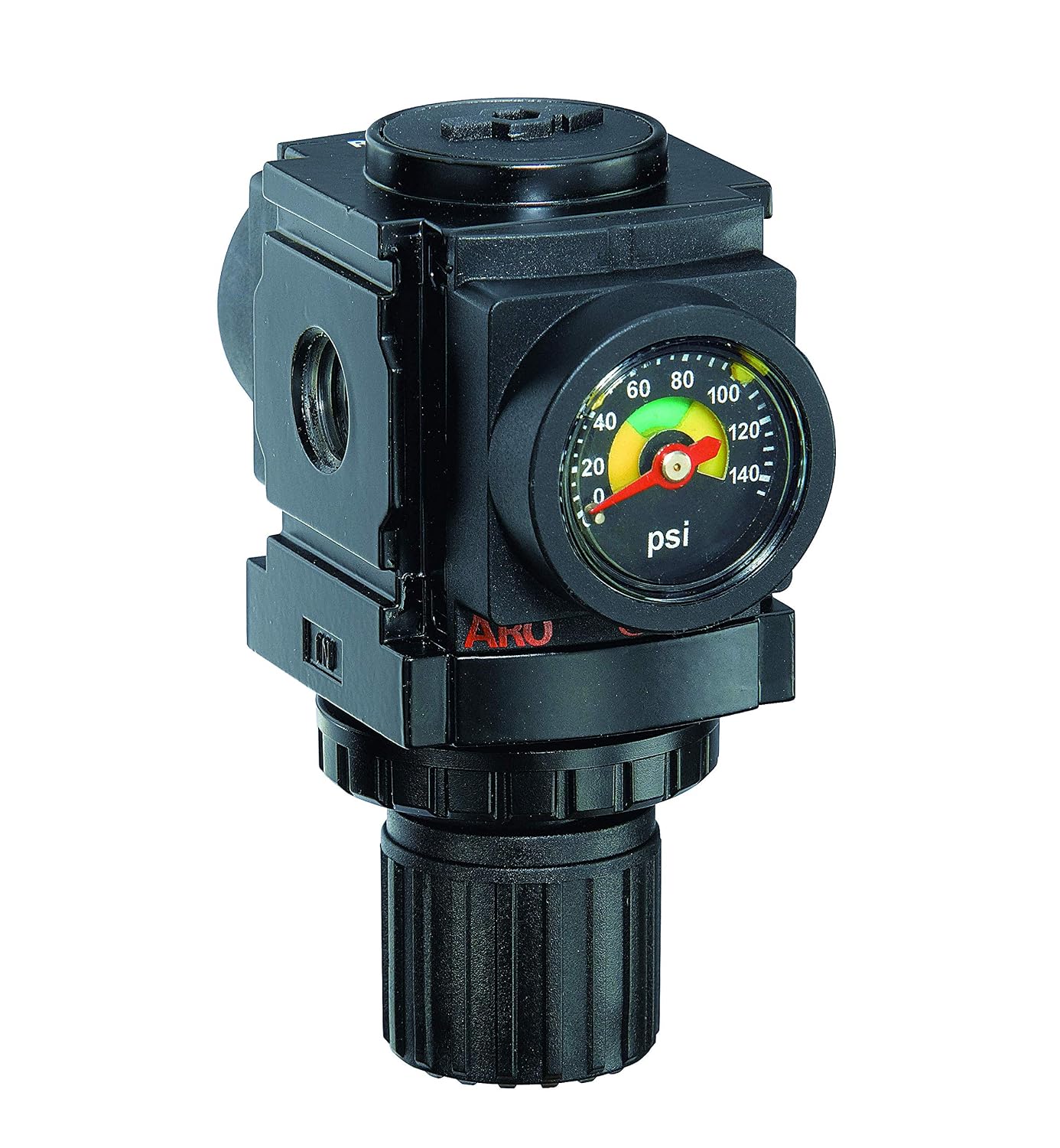

ARO R37121-600-VS Air Regulator 1/4" NPT, w/ Gauge - 250 psi Max Inlet
https://www.amazon.com/gp/product/B0057D8LMY/ref=oh_aui_search_asin_title?ie=UTF8&psc=1

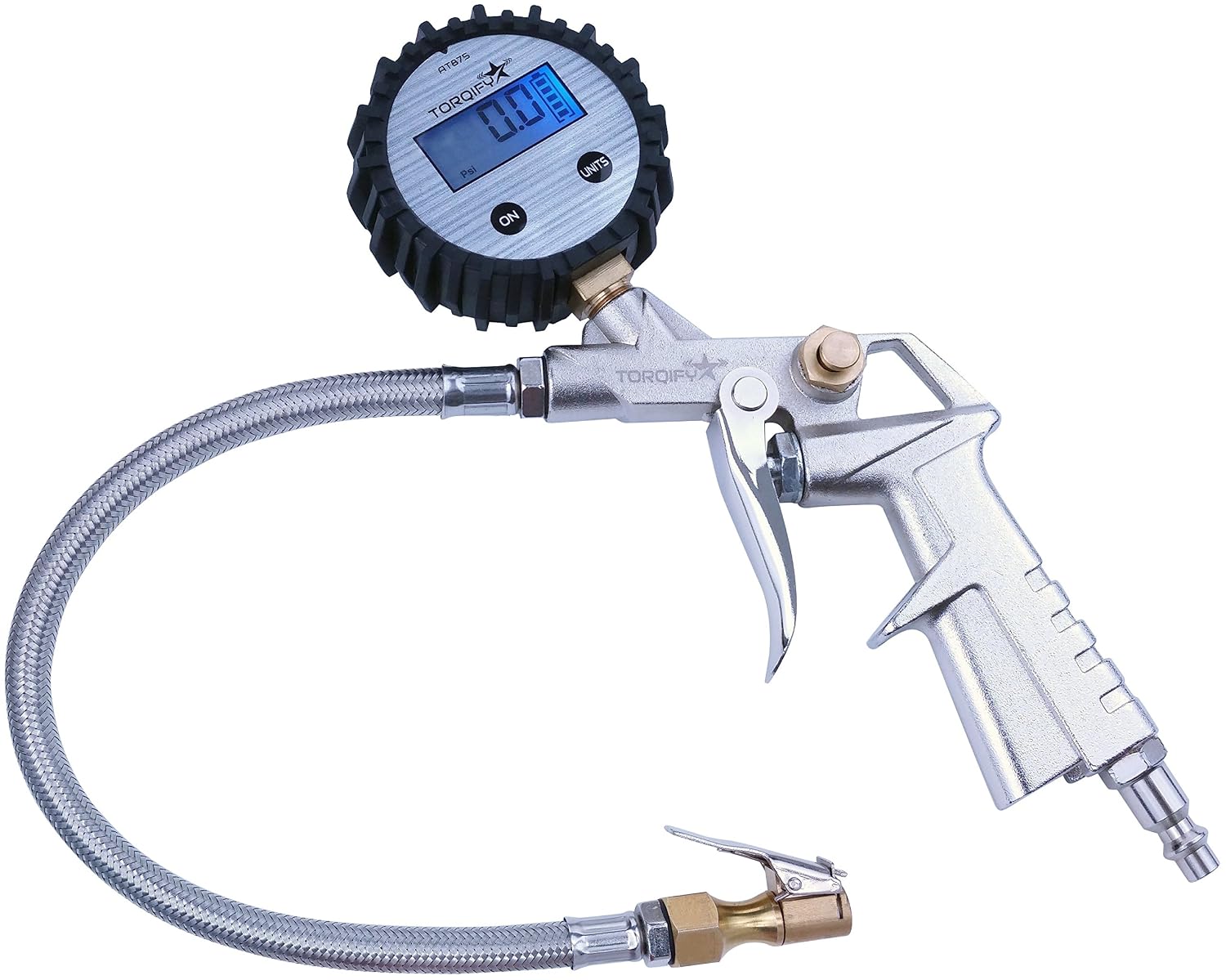

TORQIFY AT875 Tire Inflator Air Tool with Digital Pressure Gauge
https://www.amazon.com/gp/product/B071CF514F/ref=oh_aui_search_asin_title?ie=UTF8&psc=1

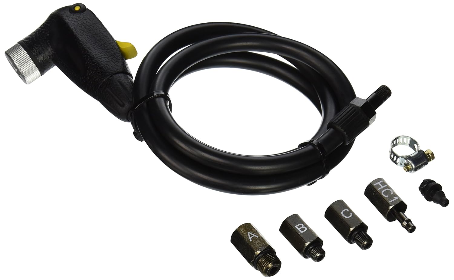

Topeak SmartHead Bicycle Floor Pump Upgrade Kit
https://www.amazon.com/gp/product/B000FIE4JK/ref=oh_aui_search_asin_title?ie=UTF8&psc=1

you won't be able to run that off of the rear 12v outlet, you'll blow the fuse.
you'll need to run at least 10-ga wires to the back from the battery to power it, you can add a relay under the hood and switch in the cab if you want switched power
(i assume the ac relay was so you didn't have to run wires and switch for a dc relay?)
You are correct, however you are looking at the max draw. The max draw occurs at/near the max psi and lower cfm through-put. There is no expectation around filling car/truck tires with the rear 12v plug.
10ga wire would be complete overkill for something like this. 8ga would be just a waste of wire. The attached power cable doesn't have an XXga printed on it. Its a little larger than my Battery Tender cables (18ga). I would put the OEM cable at 14ga or maybe 12ga.
A high volume mountain bike tire basically allows the pump to run at its highest cfm and lowest resistance. The pump runs for about 5-15 seconds at between 5psi and 15psi. The table below outlines the manufacture specs around pressure, cfm and amp rating.

its more than double the outlet's rating at max, every amperage on your chart exceeds the 120W rating. you'll blow a fuse.
and yes if you run that to the back a 30' run for 25A means 10awg. the oem cable is short, it doesn't need to be more than 12 awg. you could step down to 12awg if you keep your wiring direct and ground in the rear.

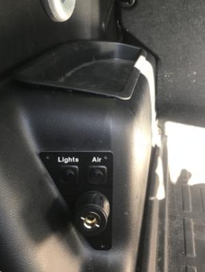

I have an ARB compressor in my engine bay and installed an electronic valve to shunt air to this rear chuck when I activate the compressor with the switch displayed versus the switch on my dash (that one only turns on the air compressor). I use it for SUP and Mountain Bike Tires. Too low flow/high pressure for the ducky.
I really like the cleanliness of the panel. Was it difficult to run the wiring and air line from the engine compartment to the rear wheel well?
