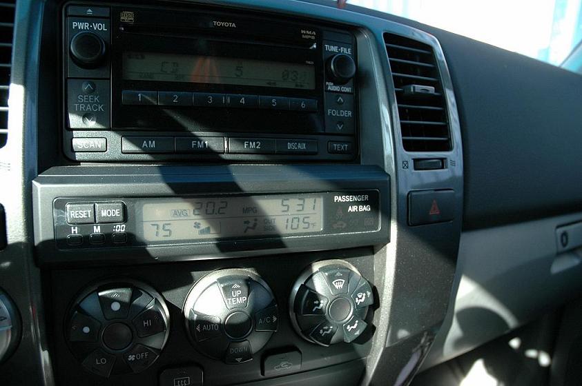

When I posted the pic of my air conditioning a couple people pointed out that my setting at 75 was kinda high. So I was wondering if my temp set is accurate as that same thing occurred to me. After I get going I usually set it around 78 as anything below that is to cold but the setting of 78 is clearly warmer than it feels. If I put it to 65 it's like the arctic. Anyone else have this in their 4th Gen?

alaskaman,
I had noticed that in your previous thread also.
All I know is that on mine if the temp is set at 75 then the air coming out is pretty damn warm! If it hits 78 I pass out.
65 is cold no doubt. I have mine usually set at 68 but I tend to like things cooler. It all comes down to personal preference I guess.
But with that said, with an outside temp of 105 and your climate set at 75, and with you still feeling comfortable at those settings, maybe you should have the dealer check it out just in case your climate control is off and it is pumping out cooler air than you expect?
Maybe you just like things toasty, but with a name like alaskaman I would assume you are familiar with the cold! :p

well I did a little checking and when I am in the city and the outside temp is hot I set it about 69 to 72 and that is cold. on the open road If I set it at lo or 65 I will have brain freeze and so I move it up until it is cool. on very hot days that would appear to be 75 and the air coming out is very cool at least enough to cool the cabin. but I do wonder about it and why it says 75 when the air coming out is clearly colder than that. I would take it in but now I am kinda used to it (and it works). If they try to "fix it" gosh only knows what they could screw up...........:confused:
