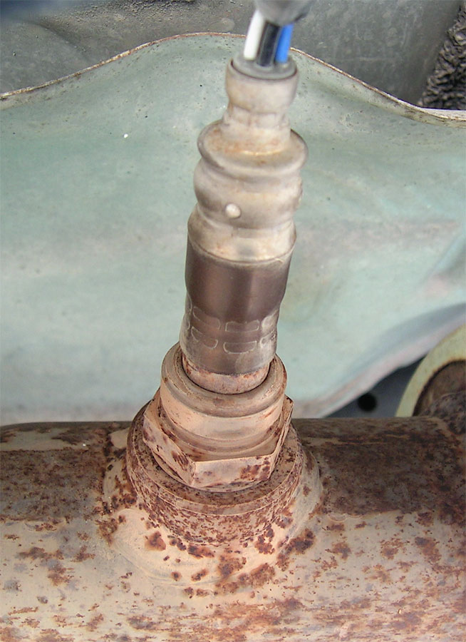

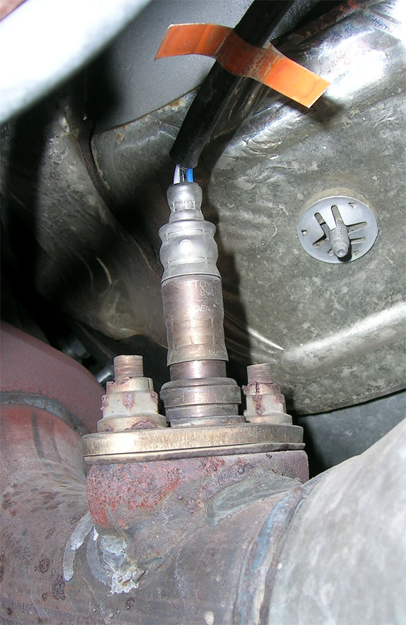

THIS time, I took my truck to a Meineke Muffler store nearby and they said the code was a P1135. The owner was super cool and said he felt it was the forward A/F sensor. He suggested I go buy one at a local store (cheaper) and then he'd install it for $50.
After reading several great threads on this website, I took the advice of many and bought BOTH sensors on Amazon.com. Here are the Denso sensors I bought:
Denso 234-9002 (Forward)
Denso 234-4261 (Rear)
I decided to install these myself as it appeared access was very simple. None of my bolts were in poor condition and they ended up coming over very easily. (see pics of originals)
After installing these sensors I am happy to report that I have not had a CEL light for over a month (also passed inspection!). I also think my mileage has improved a little. (I get around 300 miles per tank)
Today I installed a new fuel and air filter to top off this mini tune-up. I was surprised as many others here when Toyota says the fuel filters do not need to be replaced. I pulled mine out and dumped out a TON of crud from the original filter. I highly recommend you replace your fuel filter ($23) if you have over 100K miles. It is not difficult to do. Even if I don't see an improvement in gas mileage, I will drive a little happier knowing my engine is being treated with cleaner gasoline.
Thanks to all of you who are posting comments and modifications to their 4Runners. This is my third 4Runner with 134K miles...and runs great.
-Lee
