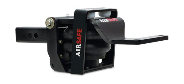

Do anybody here use a air safe hitch or any air hitch system?
I'm looking for a 20ft camper to pull with my 2016 trail. 2800-3000lbs dry weight.
A whole month road trip is in our plan.
I want it to be comfortable and safe.
Class IV | Air Hitch by AirSafe Hitch Technology
Seem to allow an equalizer.
https://youtu.be/HoXBXd2SvH8
https://youtu.be/Dhn6dypPxOg
Interesting
I looked at the videos and it is an impressive system. I would look at the class III hitch instead of the class IV. The 4runner really isn't rated for class IV loads.

The class III doesn't have the attachment for a weight distribution system.
Personally I would look at what people use who pull trailers every day.
That ain't it.
If I look at what people drive around here, 4runner ain't it.
Not the same. Some people pull trailers for a profession. They know what works best.
From my perspective, using that device means two suspensions fighting each other. Your choice though. Good luck.
I pull heavy stuff often.
No way would I use that. But....
I also wouldn't tow a 20' TT with a 4Runner either so you might ignore this. :hatsoff:
Never seen a setup like that. I'll have to look into them. I definitely did not buy my 4Runner with the intentions of pulling. Just sold a 3/4 ton diesel 4x4 truck for my 4Runner since we dont have much to pull anymore. We used to have a 28' toyhauler. I'd just worry about something in the 20' length behind the 4Runner in some wind, wouldnt be fun and I think the tranny would just be getting its guts ran out
