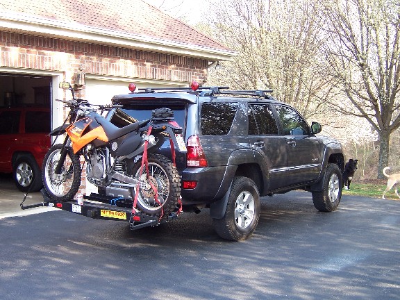

This is one good reason why - although I don't have it.
