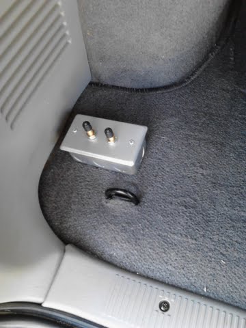

Decided i'm probably going to go ahead and cut a 1" hole into the floor of the rear cargo area (by the back tie down located near the liftgate), and head over to Lowes/HD and pick up some sort of grommet that I can run the tubes up through from below and hopefully find some sort of "cover piece" that I can just screw down, leaving the (2) nozzles exposed, easily accessible for air in/air out, yet keep them out of the elements. Shouldn't even really notice them hanging out over tucked away in the corner (thats my hope anyway). Picked up a descent inexpensive 12 volt air compressor also from amazon whe I ordered the bags, figure I could mount that over there near that area as well. Plug right into the 12v outlet in the back when doing my adjustments.
EDIT: Was just thinking about what sort of "cover piece" screwed to the floor would work best, and something like these switch plates (in black or even stainless I guess) might work perfect.

I'll take some pics of how I'm going to finish everything in the rear cargo area as right now its just "hanging" around. I'm still going to use the switch plate cover idea (and its working well right now), but I need to get a box to screw the plate in instead of mounting it to the floor as I originally intended to do.

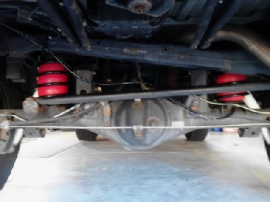

I'll keep adding some more notes as I think of them. And BTW, they do give about a nice 1" lift (running just below 30lbs), and do have a nice kind of "airy" feel with regards to bumps. I do still plan on tweaking the psi, and I still have to get my spare on which is going to add some weight to the equation, so we'll see what happens then. So far though, really happy with the purchase, and overall install wasn't to bad except for a few "doh" moments.
EDIT: Added a pic of what I finally decided to with in the rear cargo area. Metal electrical box/plate painted with some left over silver wheel spray paint I had laying around. Also went around the tubing indicated in the underneath pic with some krinkle flex tubing and cleaned that up a little more. currently running 30 psi on the drivers side and 25 psi on the passenger.
