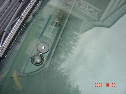

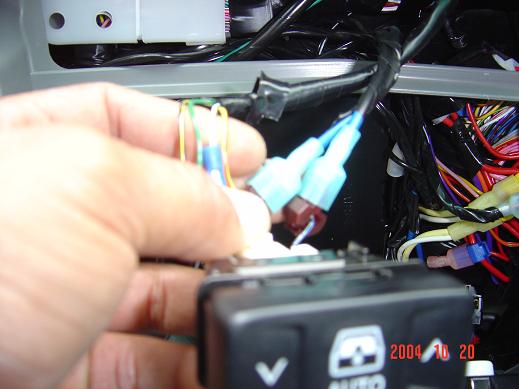

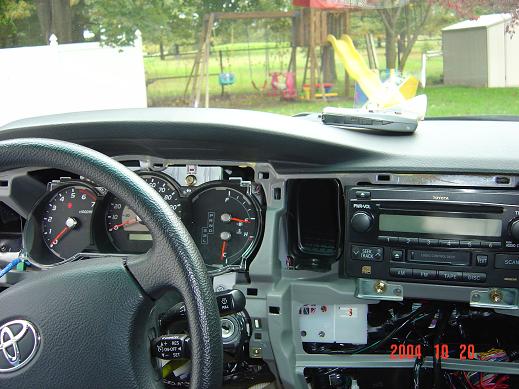

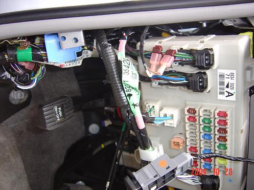

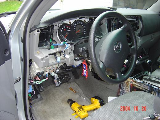

I finish my alarm remote start today . here are some pics .

Steve thats the bad news, the swicth only work when the trucks is on so i just used two relays to send a neg pulse from the 2nd and 3rd channels when the truck is on remote start . i don't mine doing that ,im just to lazy to the 530T all the way in the back window may be next summer. that black and white is Ign and the white and black is neg I put a 12v on the ign wire and cut the ground that runs to the back and put it on constant neg and stiil did not work if get lucky let me know thanks. p.s Im on Long Island (nassau) by the way I got 20's for the truck for sale , my boys work at nissan and toyota dealers.
