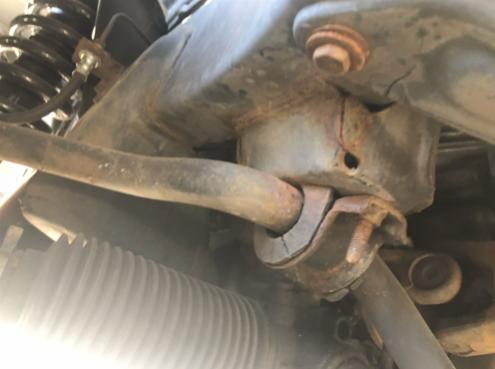

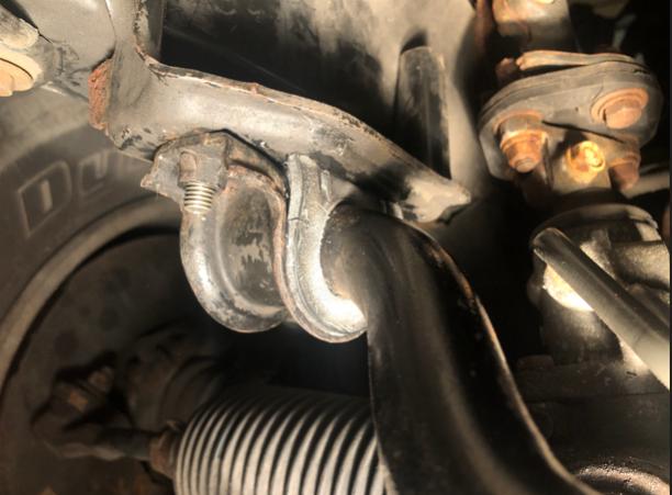

- Worn out swaybar bushing - got a new set ordered for front and rear. Will also do the rack and pinion bushings

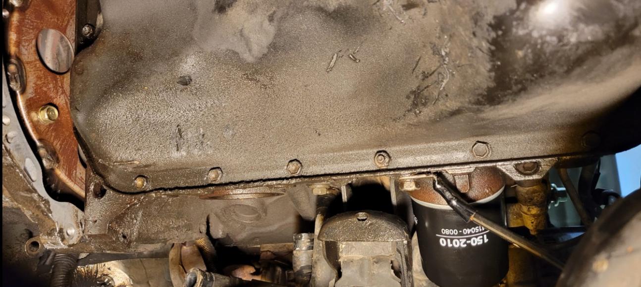

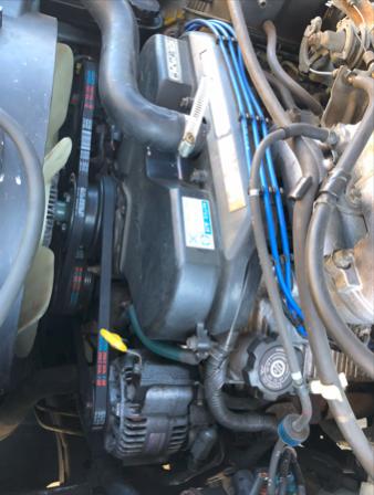

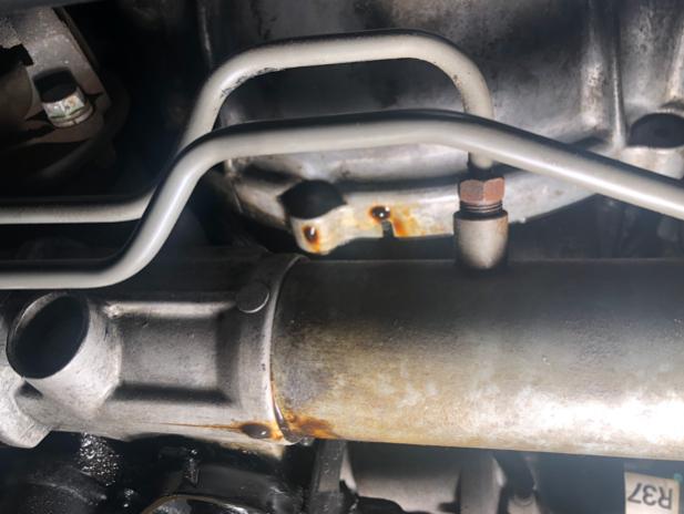

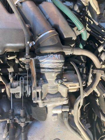

- Oil leak... oilpan gasket? rear main seal? It doesn't look like much so I'm hoping a good clean passes inspection.

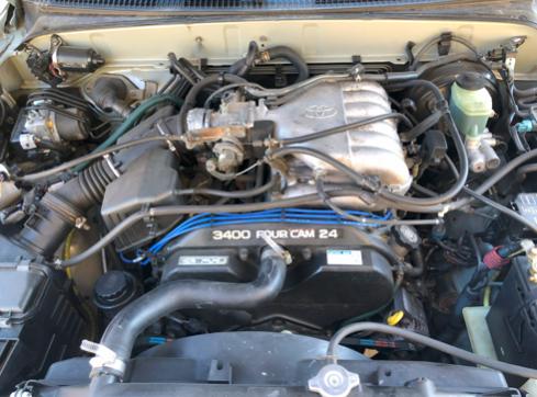

- Taped up intake coupler - can't remember what this piece was called. I'll have to take it off and see what condition it's in. Can't imagine an inspection being too happy about that.

The taped up piece is called an Air Intake Boot.
Should be about $50 from Toyota
I didn’t even notice the taped up piece on your intake tube. Here’s a link to an Airaid intake tube if you’d like to replace that whole piece and not worry about throwing any codes due to vacuum leaks. I have this on my rig and I love it. It’s a little pricey, though. It also cleans up the engine bay quite nicely in my opinion.
Airaid AIR-510-934 M.I.T. Modular Intake Tube https://a.co/d/0PDtdJ8
Awesome man, thank you! Very good to know

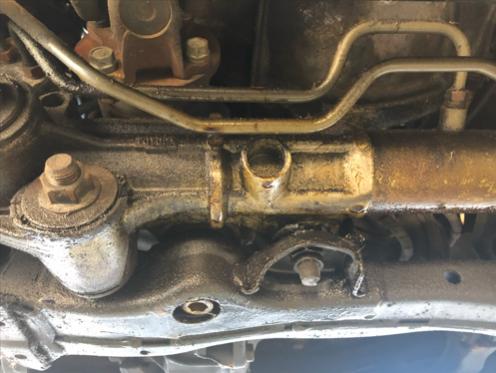

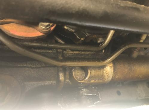

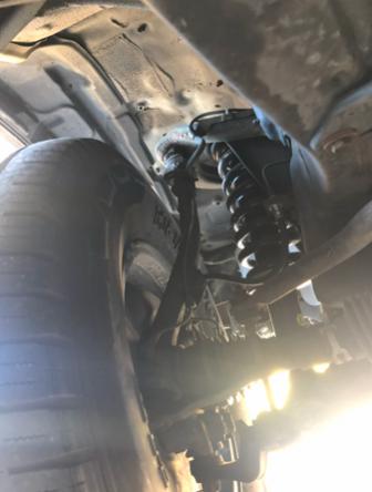

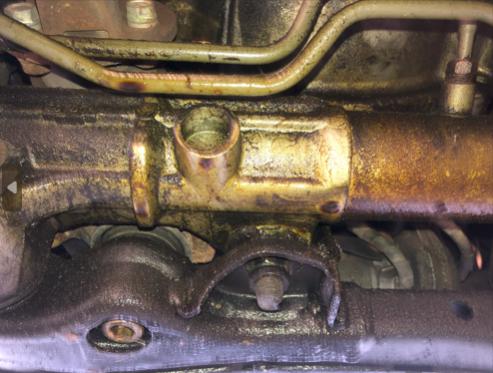

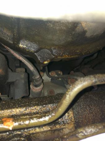

I'm thinking the leak is coming from the rack and pinion. Removed the skid plate and snapped some more photos. Will give it a wash today and see if anything leaks at idle. Can't legally drive it yet so...
Still hoping a wash will get it through inspection so I can deal with the leak later. Also noticed a bolt in the photos that isn't done up completely zzz. All simple stuff!

My rack looks just like that and has for years to be honest. I’ll hit it with brake parts cleaner every few months and it just comes back over time. I monitor my PS fluid reservoir and hardly ever have to top it off. But it makes me wonder where exactly the leak is coming from. I’m not going to say don’t worry too much about it, but I wouldn’t lose sleep over it either. Curious to see what all you find though.
Leak may also be valve cover gaskets leaking oil and running down the back onto steering rack. Should be easy enough to tell if its motor oil or ATF. If the seals in the rack are bad I have read that it can leak from the inner tie rod boots. I did get a junkyard rack that had a leak on the housing where the big bushing clamps around, moisture had been caught there and corroded right through the rack housing.
Congrats on the purchase, you truck looks pretty good for the age / mileage.
as for the leak, I cant confirm where it is coming from but you will need to inspect and eliminate the following:
1. Valve cover gasket condition
2. Leaking oil pan sealant ( its not a gasket)
Mines looked exactly like yours and I changed both as I had leaks on the valve cover AND the oil pan gasket ( after a Catch can caused over pressure in the PCV) dumba$$ POS catch can BS:gun5:.

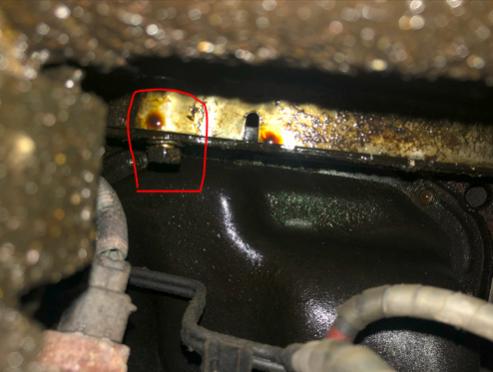

One of your pictures above shows a leak on one of the oil pan bolts. recommend inspecting some more.
Prepare for a long weekend and post repair neck pain if you plan on doing the oil pan sealant replacement as you have to drop the front differential to properly access the pan for removal / replacement. There is no other way around it.

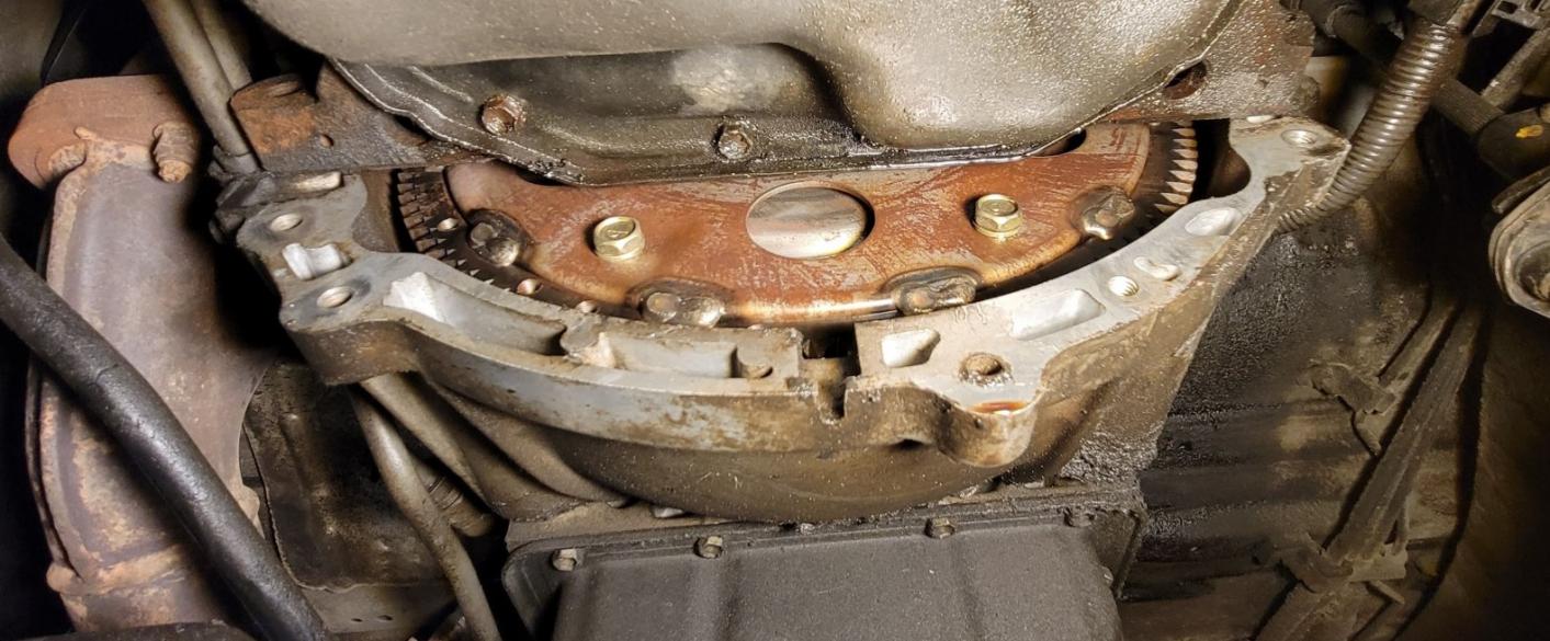

so the last image with the red box you added is actually the removeable panel that exposes the flywheel, that panel comes off when the oil pan is dropped. I removed mines and added a rubber section when i did my oil pan seal. I also used that port to verify I did not have a rear main seal leak, if you remove that panel ( you can without dropping anything) you can inspect for oil in that region which is a confirmation for rear main seal leak.
See images below with that panel removed after the front differential is dropped. Again, cleanup, inspect and confirm before dropping anything, really hope its not your oil pan.

Sway bar bushings changed finally - other than shearing one of the welded in bolts off, piece of cake. What's the torque spec? Next up is rear sway bushings then steering rack bushings. I wish I had ordered more things from rock auto way back when.
I got some better photos of the oil leak... Any ideas?

Dude I never saw this post, thank you! I'll have to check it out. I think the steering rack is definitely leaking but could be more than one source. I ordered a new rack seal kit.

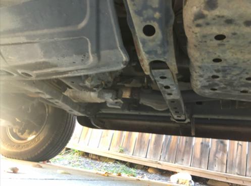

I went and took it for the out of province inspection and they came back with:
- muffler is rusted through and the tailpipe flange is cooked
- RHS outer tie rod end needs replacing, and they're saying the steering knuckle needs replacing.
- need new tires.
- High mount brake light and "front side marker lamps"... wtf are these? Also, they quoted me $125CAD to replace these bulbs LOL
About $1000CAD worth of stuff, which isn't too bad. That would bring the total cost to about $5600 USD for a great 3rd gen :thumb:
