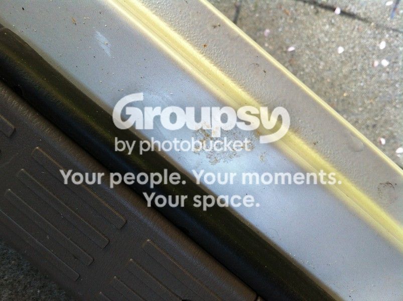

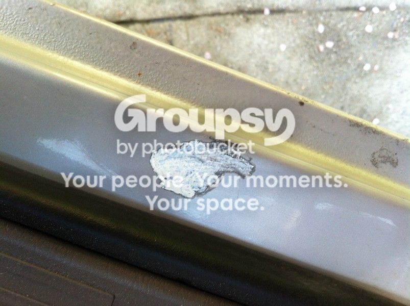

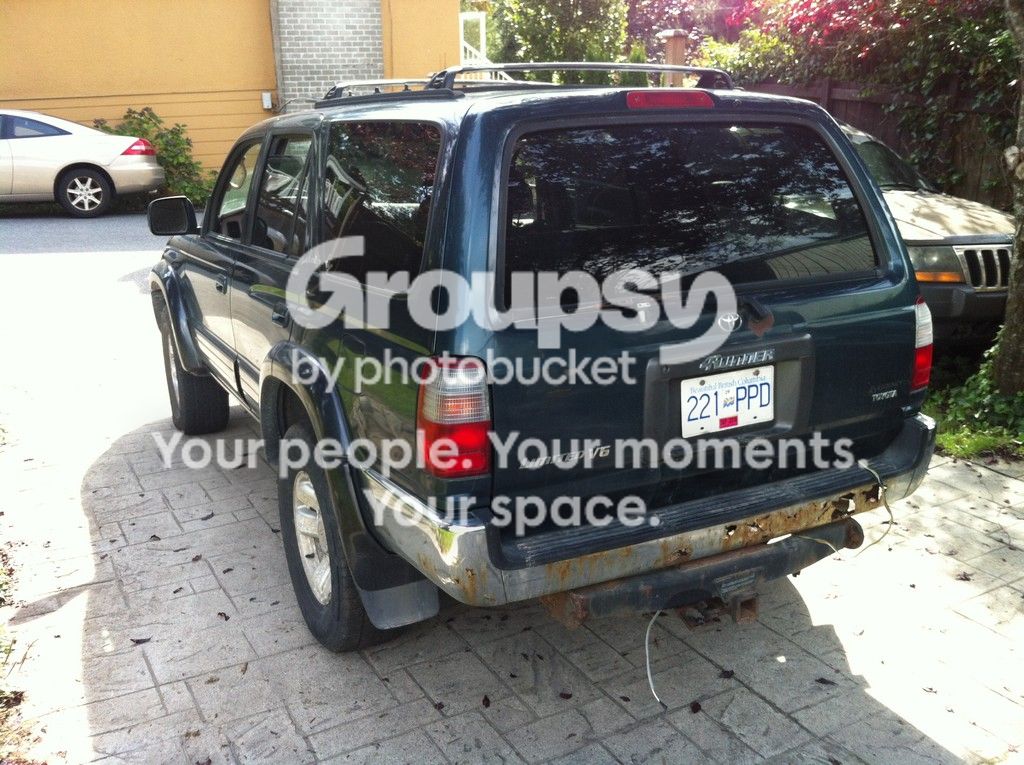

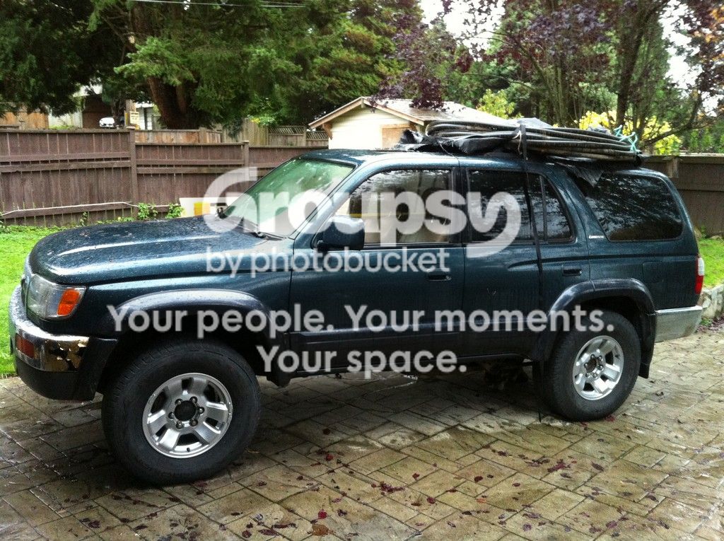

Since 1998 my family has had a 1997 Limited T4R, Evergreen Pearl dark green with e-locker. It has been neglected for a few years looking pretty sad and I recently fell in love with it / felt sorry for it so I'm bringing it back to life.
It has had a few rough winters. It is the summer utility / off road vehicle at my mom's property on the island (she drives a Prius). So in winter we would cancel the insurance. Unfortunately, for two seasons in a row, the last time we drove it was November with salt on the road, and it sat there all winter with salt underneath in the dampness of the PNW, getting eaten alive. I told my mom to drive it down the road when it rained but she didn't understand the importance of this; I was away and unable to do so.

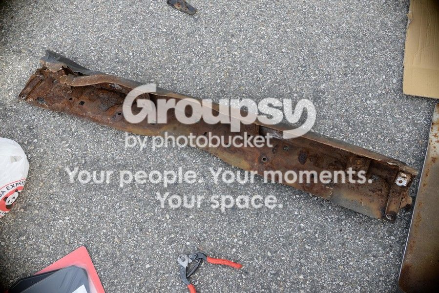

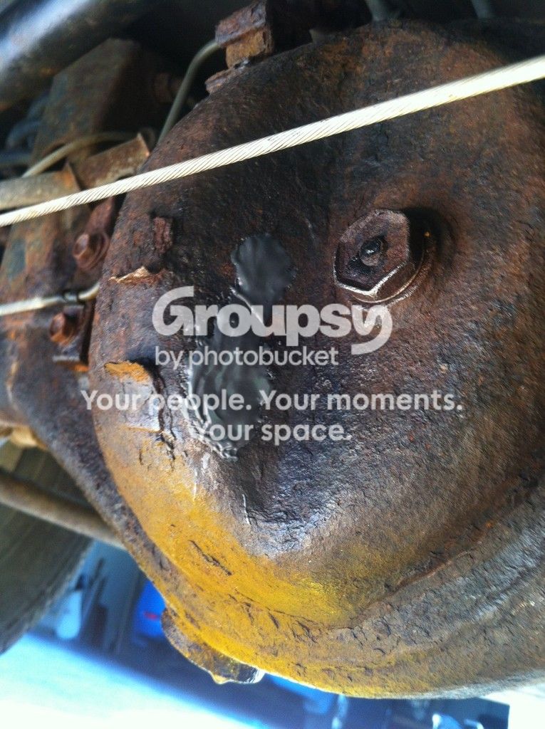

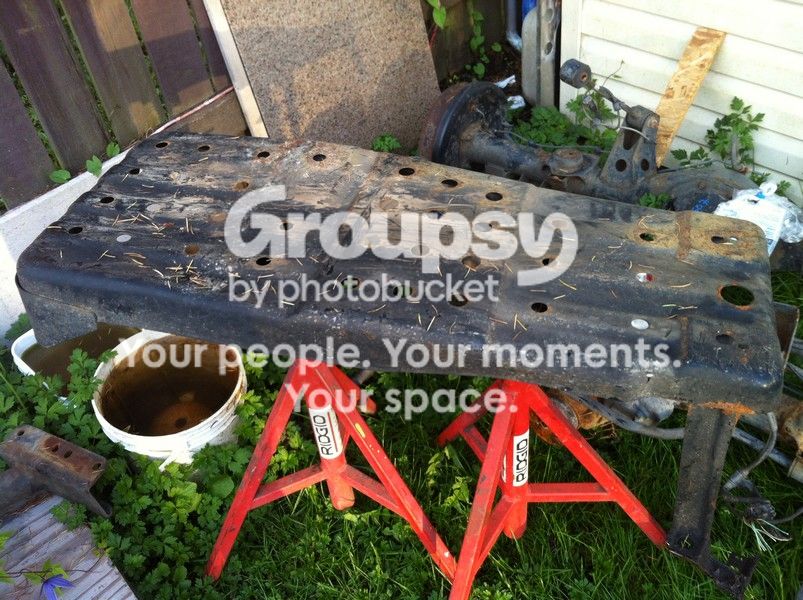

The rust is ugly but mostly surface flaking, at least on the frame. Some of the suspension is shot, the shocks are toast. In chipping rust off the differential housing I poked through and had to patch it up with JB Weld which is holding for now. It has 300,000 km on it.
~original
IMG_4454_zpspb4axzjg.jpg~original
IMG_3776_zpscflacj0b.jpg~original
DSC_2705_zpshat19swf.jpg~original
IMG_3841_zps39fpixh9.jpg~original
Here's what I plan to do to it. I originally wanted to build it up a bit but now I think I want to restore it to its original glory. In 2021 it will be 25 years old and therefore eligible for collector status in BC. With this you get cheaper insurance rates and special license plates. But the catch is it has to be pretty much stock so I can't really build anything up on it.

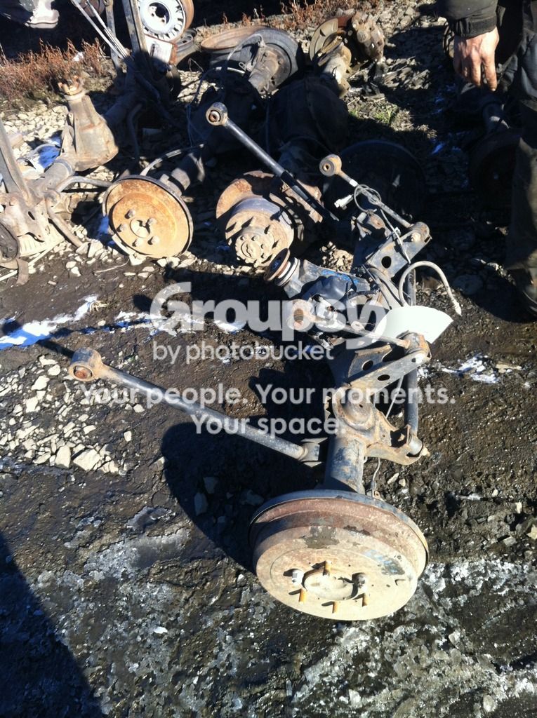

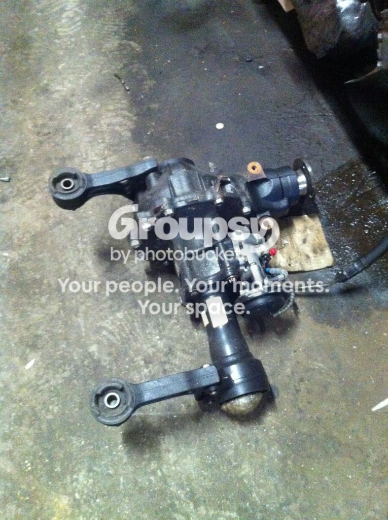

⦁ Swap out the rusty rear axle with the near mint one I picked up from another 1997 Limited for $350 Canadian.

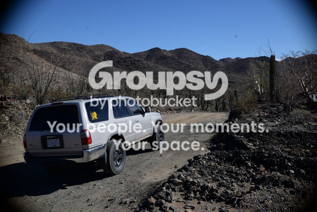

Sand:

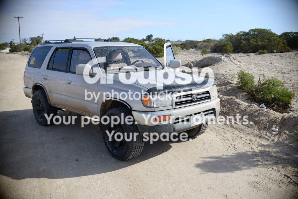

My love for this vehicle is only so deep because it is automatic. I'm not a fan of automatic. Plus it lives at my mom's house. I live in Vancouver and have a Nissan Leaf electric car which doesn't do off-road and has limited range. So I decided to get me my own T4R, a manual. I wanted tan colour and in a short while this one popped up on CL:
00v0v_beXo1JoK06h_1200x900_zpsds56lpan.jpg~original
It had 264,272 km on it and I've since put about 7000 km more, mostly over a period of two weeks freeway driving up and down the west coast but with some Mexico 4X4'ing as well.

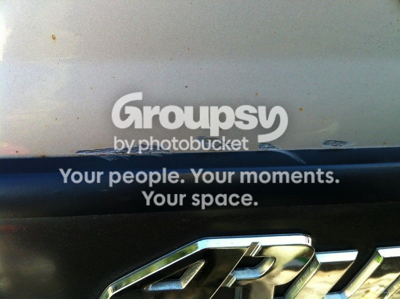

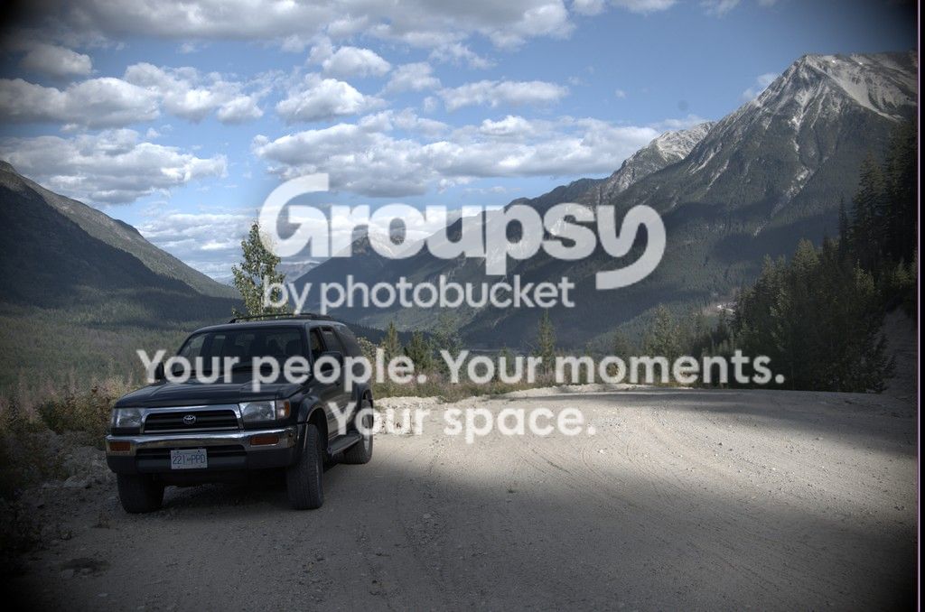

It is nice inside and has no body rust but it has significant underside rust beginning. She is lucky I got her in time because I think another year or two with the PO's would have been too much for her to stand and she'd start breaking. I got it from a New Zealand couple from Whistler who was going back home and had to sell... so that's always a good indication that the sale is for good reasons. That time in Whistler with the salt really did a number on the rust. The differential housing is pretty rusty but not as bad as my mom's; I was able to chip down to bare metal and repaint without poking through. 4.1 gearing with no e-locker.
This one is for off road exploring around BC and also taking me on my long trips down to Baja California where I go into the middle of no-man's desert. I'm not into crazy rock crawling. I 4X4 to get out there. I don't go out there to 4X4.
My plans for this one are as follows. I want to keep it looking as stock as possible, but with lots of hidden features.

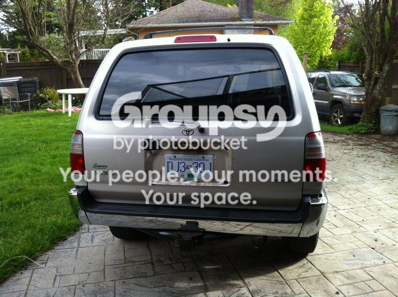

⦁ Now that dirt gets kicked up all over the sides with the running boards gone, I want some fender flares; probably convert some Limited ones over and drill them on like blcktpgsr did. I took off the little chrome / black ones and noticed grit grinding down the paint. I'm glad I took them off. If I put on some rock sliders those can take the place of the running boards and protect the sides from rocks. Thinking of the 4X Innnovations ones. So now I am thinking I will not put flares on.
⦁ Put a new rear bumper on it to replace the original piece of rust with a little bit of metal left on it. DONE with a cheap $100 POS from Amazon that doesn't fit properly. PITA, now I'll have to monkey around with it.
⦁ Put on a roof rack. DONE with a stock one but not very well. It still needs some touch-up paint. Plus I want to extend it out towards the front like this which will require drilling holes in the roof which I'm not too excited about but considering there are already 10 holes for the existing rack that I successfully sealed up with silicone I don't see any major issues. I have no sunroof. I may put a ladder up the back hatch to climb up onto the roof, we'll see. Maybe some other idea will come to me like something that is removable and hangs off the side back so you climb up onto the tire then a few more steps gets you up top. I will then weld up my own full length low profile rack.

⦁ The original axle had a hum at speed all through Mexico and I determined it was the carrier or pinion bearing in the third member. It was pretty noisy. Swapped out (unlocked) rear axle Aug 12, 2017 to put in a replacement axle with e-locker I got from a 2000 automatic in Oregon on my way back from Mexico, with 226,000 miles. It is 4.3. I also got a front 4.3 differential (from a 1998, 238,000 miles) so I'll swap that out while I'm at it so they match. I think I'll just do an aftermarket electrical job on this which won't integrate with the computer; that way it will also work in 2WD and 4Hi. No flashing light in the dash but no biggy. That can always be added later.

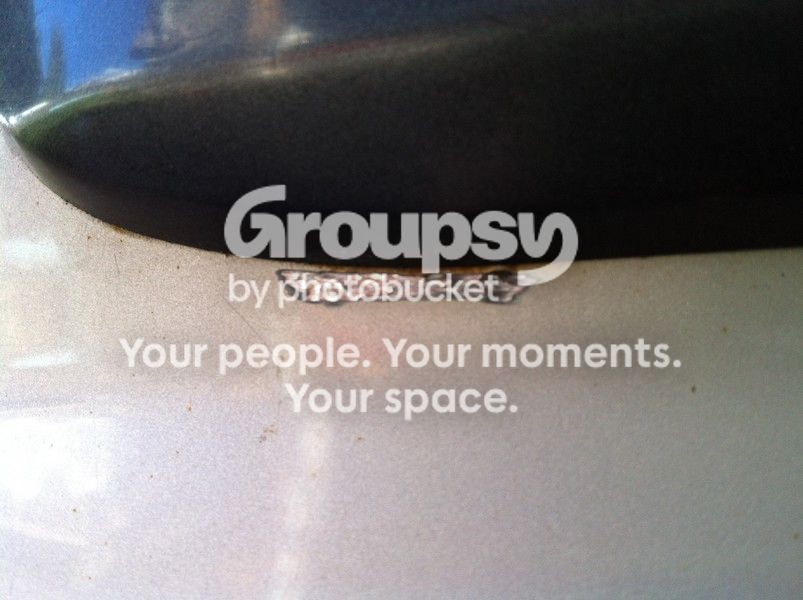

⦁ Fix loose steering wheel column. DONE with a tack weld. See here

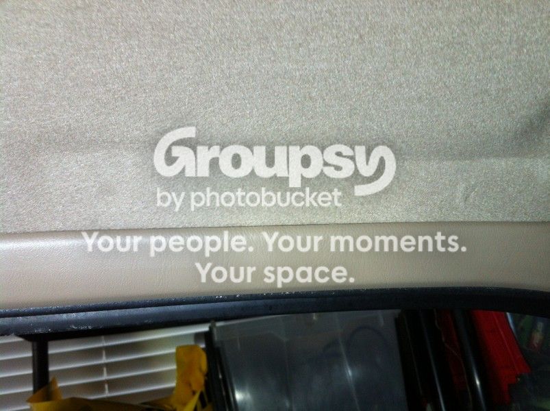

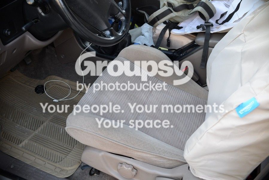

⦁ Seat covers on front. DONE. I got the Coverking ones which are pretty good. They don't look super plush but they are strong and easy to clean.

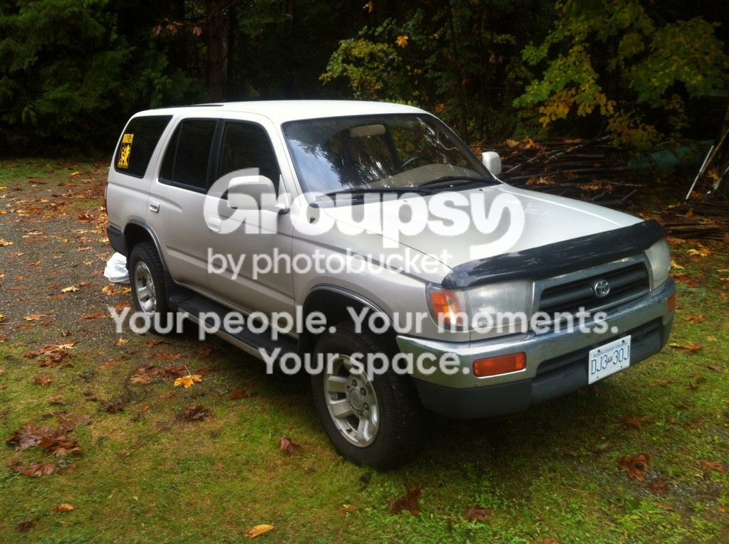

After I got her home:

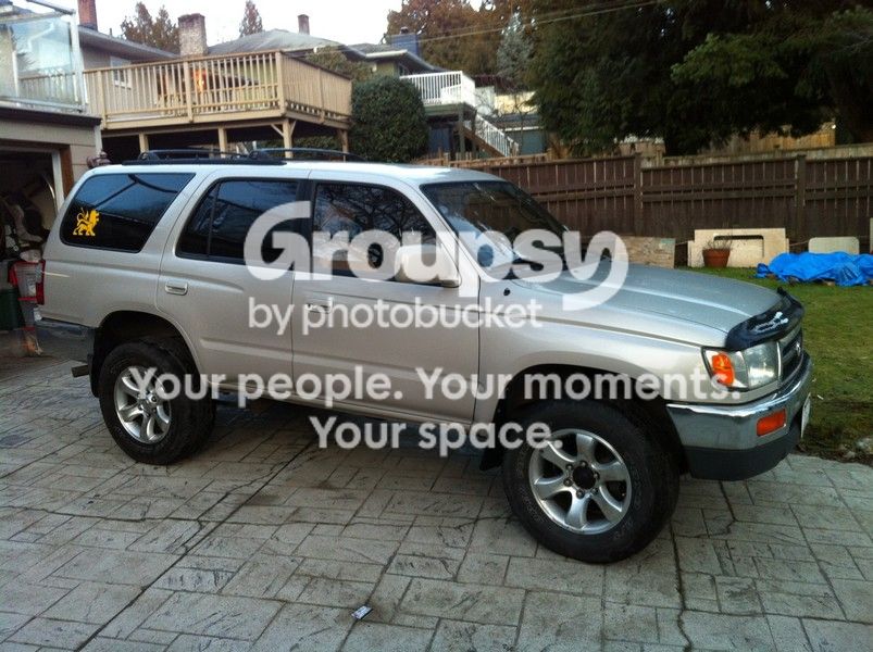

As she sits today:
IMG_7098_tn_zps6hp4igyf.jpg~original

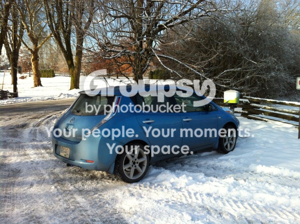

My Leaf with 350Z rims, getting a charge in front of the criminally insane asylum:
IMG_5760_zpsic101ziz.jpg~original
Leaf Maintenance:
⦁ 2012 version, bought in Dec 2011. It is my daily driver around town.
⦁ Added a 1 1/4" trailer hitch and wiring. I towed my 18' sailboat 100 km to my mom's house but I needed to charge it several times along the way. According to the user manual, we aren't supposed to tow anything or even put on a trailer hitch. I guess I wrecked my car then...
⦁ To install the trailer I needed to remove the large airflow deflector underneath the back. I left it off to allow for better access under there to clean off salt. I applied Rust Formula 5000 rust inhibitor to a few areas showing rust starting, fall 2016.
⦁ Original Ecopia tires lasted 50,000 km. Bought a set of 6 spoke 2004 350Z sports car rims off Craigslist which fit the large wheel wells. They came with Michelin winter tires. They went on fall 2016. I bought another set of identical rims and put some 3 season tires on those, they went on early May 2017 at 70,000 km. Sold my original Leaf rims early 2017.
⦁ Other than that I guess I should do SOMETHING to maintain it... it's true, these electric cars hardly need any maintenance. Oh right, my range has gone down about 20% since I first bought it, and apparently it degrades faster and faster when it starts so I will need a new set of batteries at some point. I believe that is around $5000. So offset that with the gas and maintenance cost savings. You can pick up used Leafs now for $15,000 or less, so it really does make good economic sense to buy a Leaf as a second car.

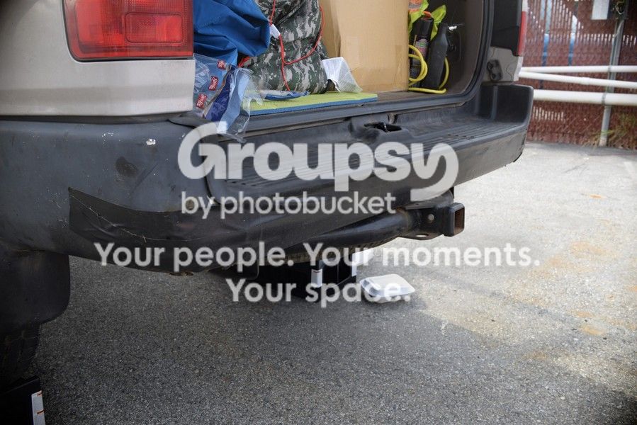

I stayed with my friend Mark for a couple days in Long Beach and swapped out the bumpers at his work. Goodbye hunk of rust held together with Gorilla Tape:
DSC_4252_tn_zpse8wbdffe.jpg~original
DSC_4254_tn_zpsiwuidkvv.jpg~original

The next day as we got to Colonet, traffic ground to a halt. There was a problem with the one bridge through town.
_DSC2189_zpsu06qwr0q.jpg~original
So I followed other people and went 4X4ing around it. The T4R definitely made that easier. Most people were struggling in their cars.
DSC_4464_zpsyjosy2ft.jpg~original
But then we hit the same problem again at the next bridge... went around that one. After talking with some people I learned that there was a nation-wide gasoline price protest and they were shutting down the highways. Great. At the next closure I met up with some Americans in Tacomas and we got directions from locals to get through the wash and around the bridge. To get out of the wash I went up a side slope I probably shouldn't have... a diagonal steep trail, but I didn't roll it. Just stuck it in 4LO and kept it going steady up the track up the slope. I had the dash cam going and hit save but for some reason the footage was lost unfortunately.
That was the last blockade and we had the whole highway to ourselves after that. We crossed at Tecate and I got through no problem. After spending a night in Long Beach I headed north for the long drive back to Vancouver. It was bloody cold in northern California and I just got through the mountains in time before a snowstorm. Oregon was cold too; the farther north I went the warmer it got because it goes down in elevation.
I stopped in Independence Oregon to pick up the 4.1 e-locker axle I had previously arranged. I got there and found out it was actually 4.3, and not a locker!!!! We made some calls and I then drove back down to Albany to pick up one they said they had there. 4.3 with a locker. OK, then I swung back up to Independence to pick up that 4.3 front diff to match...
IMG_5808_zpsq4ecddhr.jpg~original
IMG_5805_zps94io5mha.jpg~original
Got it all in the car and limped the final leg up to Vancouver in one day. I avoided road salt until only 10 km from home. I was really hoping to avoid salt since the underside is rusting out and therefore no longer protected by paint. I want to stay out of salt until I get it properly painted.

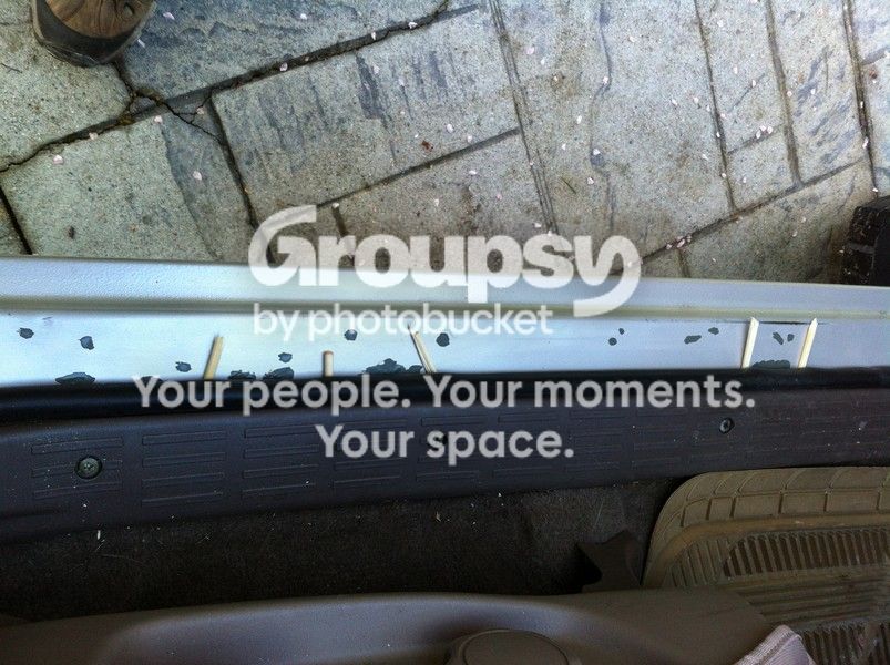

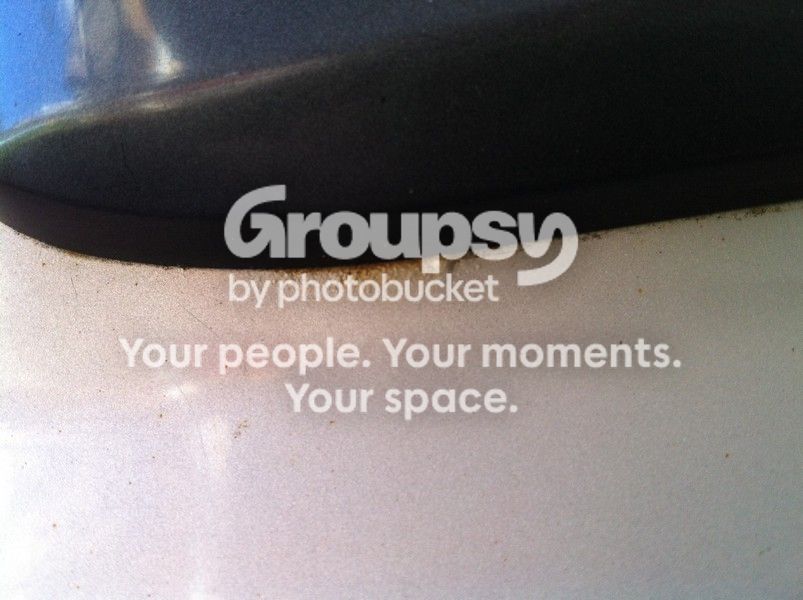

Also there are more annoying rust bubbles on the rocker panels. I have to get rid of them because I think they started from a small paint chip, then in winter salt got in there and just travels under the paint. Even if I wash it off now, the salt is still stuck under there and it will keep growing. Luckily there aren't any on the outside.
IMG_7329_tn_zpsyamwdoyb.jpg~original
IMG_7330_tn_zpslbhdnqlx.jpg~original
Hit it with primer.
IMG_7332_tn_zps0j4quqbr.jpg~original

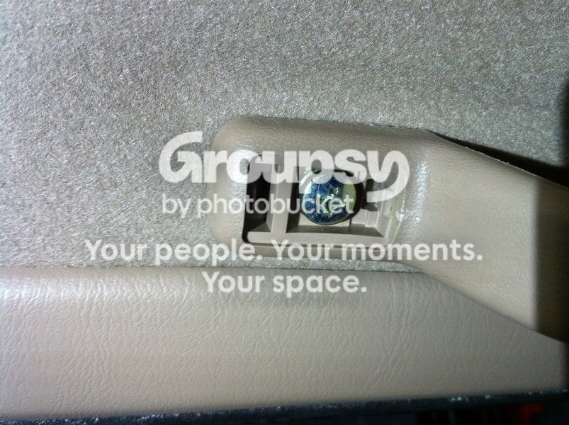

I pulled off the passenger side grab handle and put it on my driver side. Usually the screws are super tight but these ones were actually loose. You can feel along the fabric on the drivers side where the depressions are from the two existing holes. So all I did was make a little hole with a razor blade and screwed the new one in. Done.
IMG_7417_tn_zpsanlewgsr.jpg~original
IMG_7419_tn_zps4xoswzht.jpg~original
IMG_7420_tn_zpsc7ok6vq2.jpg~original

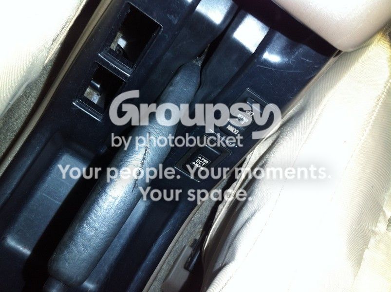

The other mod I finished was the power antenna disable switch, see here. I picked up the ECT ("eject") button from the wreck and hooked the multimeter up to it. It turns out that the black/yellow and green/red wires are the ones that switch on and off in continuity. So I just hooked those up to the wires I ran back from splicing the blue wire in the antenna harness behind the cigarette lighter, and put it in a blank spot in the center console (mine is manual transmission so I don't have an eject button). Done!!! The only thing wrong now is the button says ECT so I wonder how easy it is to re-letter it. Does anyone have any suggestions?
IMG_7423_tn_zpsqr6cjzg0.jpg~original
I also took the rear window up/down button which I hope to wire into the hatch door as described here so I don't have to go to the front and turn on the ignition every time I want to adjust the hatch window when sleeping in the back. Edit: it won't fit, it sticks too far back so I'll just have to get a little one from the electronics store.

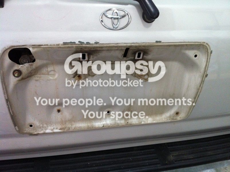

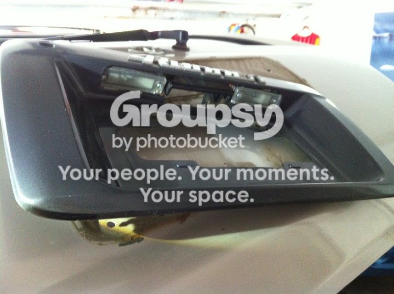

Got that son-of-a-b!tch rear license plate bezel off last week. I have a few reasons for opening up into the rear hatch: 1) bezel causing rusting where it chaffes the paint so I have to put a rubber gasket on it. 2) while I have it off I'll paint it, 3) a nasty dent under the windshield wiper that would be impossible to access unless the bezel comes off, 4) the rear outside latch handle mechanism is pretty rusty and the only way to clean that up is to take it off, and 5) put in a local up/down switch for the hatch window.
  • Managed to pull off the interior panel. You have to start at the bottom, you can't pull it off at the top.
  • Unscrewed 10 or so bolts holding on black metal panel cover.
  • Unscrewed the two bolts holding the rear latch on. They can be accessed using a socket extension. For one, I cut a little notch in the white plastic cover over the window gear tooth thing, which allowed me to get in to the bolt. This way you don't need to remove the window mechanism at all, you work around it.
  • Unscrewed the one bolt holding the bezel on.
  • Removed license plate.
  • Squeezed with needle nose pliers (longer ones with the bent tips would be ideal) the four plastic clips from the inside, holding the bezel on.
  • Pried bezel off hatch a ways but the key cylinder came with it. It has two screws to remove it from the bezel but unfortunately you can't access them until you take the bezel a few inches off the hatch, and that's about as far as you can go without stressing the lock mechanism. So I got a little Philips bit and turned it with needle nose pliers and the screws were in very loosely so they came undone.
  • Then you can pull it away, to reveal this mess:

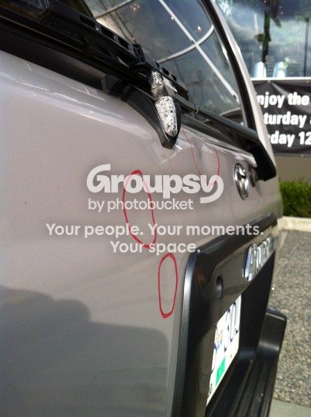

I took the 4runner to the paintless dent repairman today to fix several minor dings along the doors, one on the hood, and an ugly dent on the rear hatch by the windshield wiper. It bent the horizontal ridge under the wiper which is a lot more difficult to fix than a flat panel. Also, there is a reinforcement piece inside there and there is no way to access this area from taking the inside panel off, so luckily I had the rear bezel off to access it through the key cylinder hole.
Before:
IMG_7238_tn_zpspofwnyrn.jpg~original
IMG_7239_tn_zpswd9lf4k4.jpg~original
After:
IMG_7478_tn_zpsptoyebvl.jpg~original
IMG_7480_tn_zpsvlepi16m.jpg~original
Pretty impressive what a good dent repairman can do. You can still see some slight rippling there but you have to know it's there to see it. It cost a few hundred bucks for everything but so does a good detail. Otherwise I'd be looking for a new rear hatch... Maybe I'm too much of a perfectionist.
Now to fix up the scuffs from the bezel, repaint it, fix the rust on the latch, and put it back on.
IMG_7432_tn_zpspdih88t9.jpg~original
The most important question of all: what colour should I paint the rear bezel? I am liking the chrome wheels and bumpers and I have some silver rim paint I like. Would silver look weird? Or should I paint it that dark grey like it is now? Black to match the bumper plastic trim?
I need to pull mine as well, it's starting to crack and the gasket has rolled in at one spot underneath.
You have some chrome, so you could go with a lighter silver, but if it were mine I would stick with a similar shade of grey!
I think I'll go with black to match the plastic on the bumper, window trim and windshield wiper.
