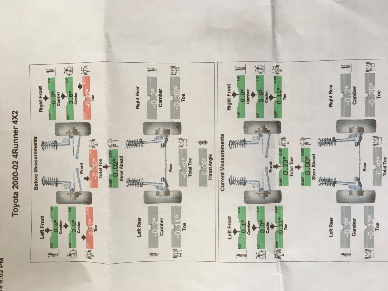

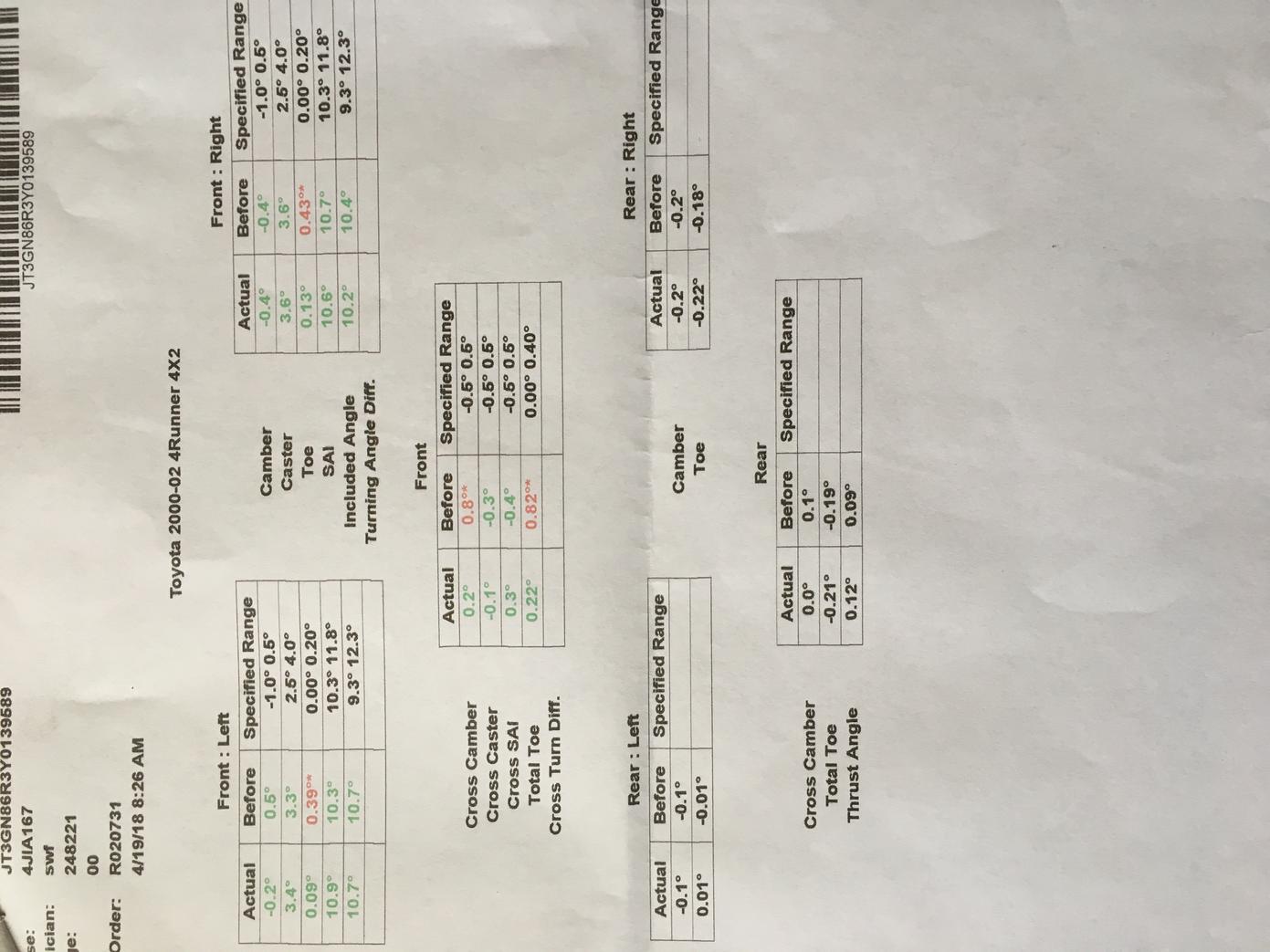

Ok so I did not think that lower ball joint replacement would effect front end alignment, but I have discovered that is not the case.
A timeline of my situation is as follows:
2/21/18 new tires and alignment - felt fine and drove fine
3/26/18 installed lower ball joints - felt fine and drove fine.
4/15/18 noticed feathering on the outside edge of the front tires
4/19/18 same tire shop rechecked alignment and reset toe, as you can see it changed quite a bit.
Attached are the alignment sheets from before lower ball joints and after.

Good to know. Doing my LBJs in about a week and was wondering how much it would effect things. Thanks for the heads up
If your ball joints are bad, or going bad, then an alignment after LBJ replacement will probably be required.
No doubt about it, mine were bad!!! I should have done them before getting my tires and alignment, thankfully the shop took care of it.
I’m super anal about getting my alignment checked.
After every wheeling trip depending on how hard I go
And of course after any front end work or adjustments
Fact is no matter how good you are things never go back exactly the way you took them out.
I’ve done some work where yeah it was in the green BUT just cause it’s in the green doesn’t mean it’s right.
