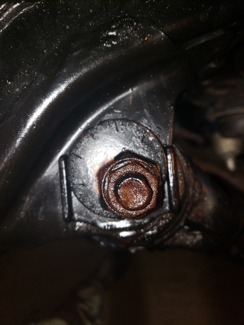

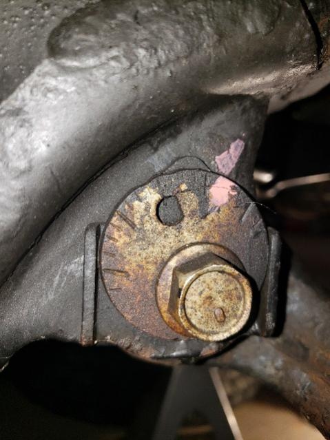

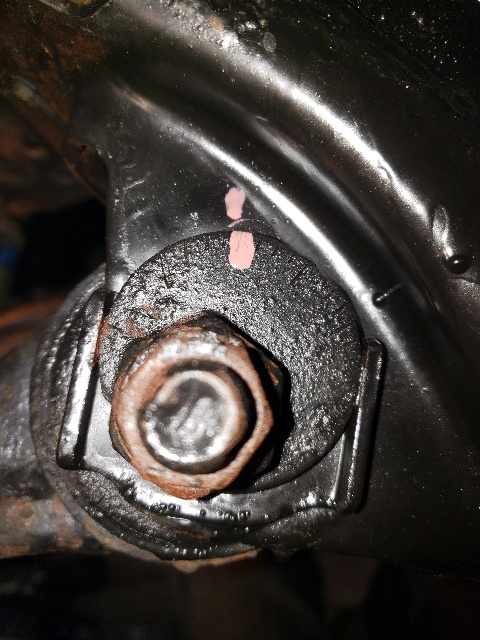

You could be able to get a pretty decent alignment depending on what kinda of lift (if any) you have. Take a pic of your alignment bolts now and I can probably give you a good idea on what you could run your taco tabs at (or buy my lightly used stock cam bolts LOL).

That would be positive camber. The front passenger cam bolt is probably set outwards. I’d need to pic of them to confirm but I’d be willing to bet this is the case.
Sorry for taking such a ridiculously long time to respond... Took me a very long time to find time to get that job done.... Not to mention I ran into A lot of problems but I got it.... Even though I knew it wouldn't be right I set everything to factory neutral well that's not working out so....
I tried to upload photos The first two are the driver side rear cam the last one is passenger rear cam they're the same on both sides just opposite.... it's pretty hard to tell from the photos everything is covered in rust encapsulator so I tried to get it at least somewhat visible.... The front cam bolts both sides were dead center....
