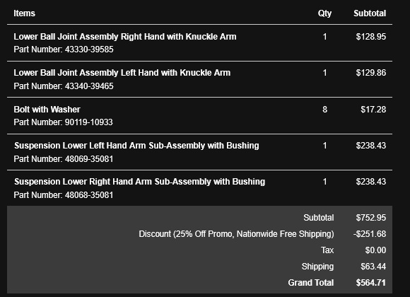

I just bought OEM from Springhill Toyota Parts which I thought was pretty cheap compared to other sites, 2 separate places said they can't do the wheel alignment until I get steering rack bushings / lower control arm replaced, and at that point, I may as well get the LBJs replaced again since I'm at 265k.
1. Lower Ball Joint Assembly Right Hand with Knuckle Arm | Part Number: 43330-39585
2. Lower Ball Joint Assembly Left Hand with Knuckle Arm | Part Number: 43340-39465
3. 8 x Bolt with Washer | Part Number: 90119-10933
4. Suspension Lower Left Hand Arm Sub-Assembly with Bushing | Part Number: 48069-35081
5. Suspension Lower Right Hand Arm Sub-Assembly with Bushing | Part Number: 48068-35081
chose to stick with OEM bushings for LCAs since the mechanic who's installing these said he doesn't have the press thingy to get the whitelines poly swapped in there and I don't feel like spending more money.
Good choice on the bolts! Just be sure to torque these to 37 ft-lbs, not the 59 ft-lbs in FSM.
As others said, you can't run cam eliminators with stock UCAs, you'll need some sort of adjustment on top. If using stock UCAs (or JBA), I'd go with OEM or OEM-like cams.
I thought I saw somewhere Tim recommended to still do the 59ft lbs?
If he did, that's outdated. 37 ft-lbs is the right torque for the black bolt with washer that you are getting, used in '01-02 trucks. 59 ft-lbs is the correct torque for green/red bolts of the '96-00 models.
