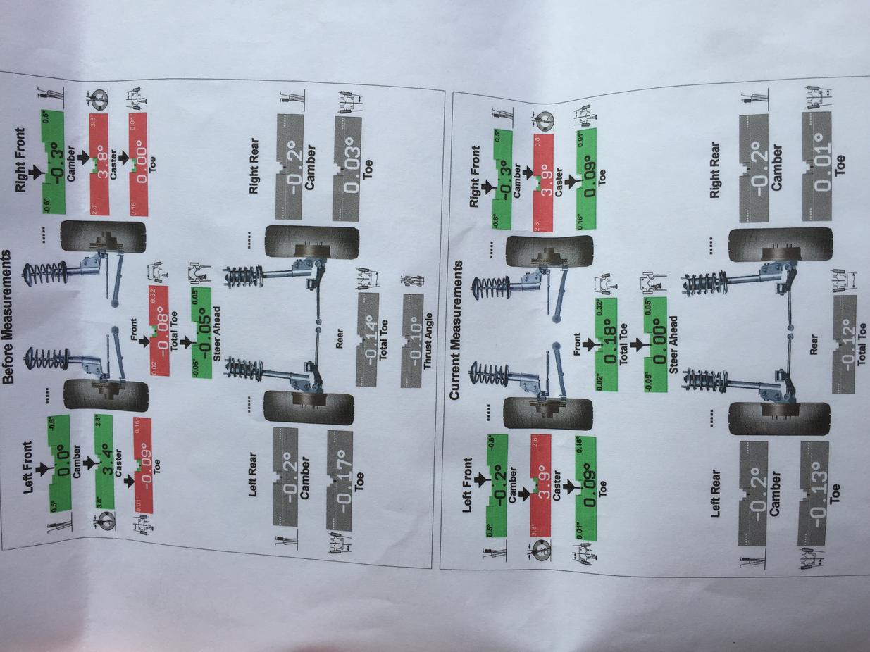

I had the dealer max the caster and it helped with what you are asking.
2016 Limited with TRD wheels and tires.
Thx but I’m already in spec.
I’m familiar with alignment angles, I was asking if people deviate from factory specs...on factory suspension. I swear I read this somewhere.
To answer your question. I asked the dealer to set my caster as. Lose to 4 degrees as possible. That helped.
