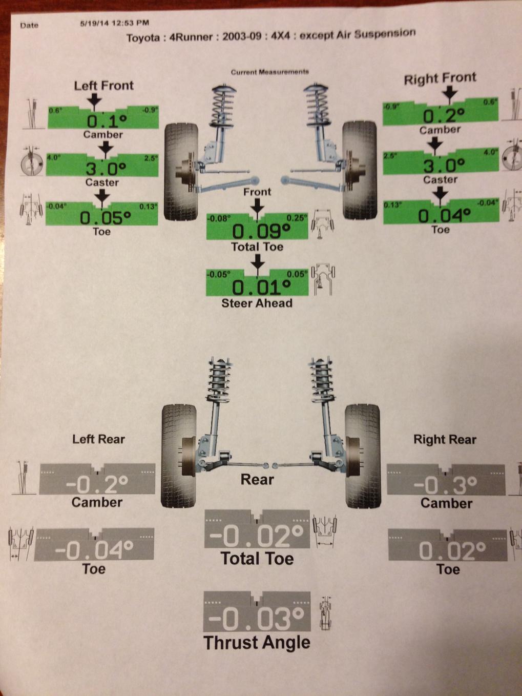

Had my alignment done yesterday after I installed my Icon's up front. The last shop that did the alignment didn't do a very good job. Felt some wandering for sure. It feels perfect now with the Icon's and a good alignment. How about some opinions?

IME, positive camber will lead to increased wear on the outside edges of the front tires. A slight touch of negative camber assists in cornering stability and helps the tires wear more evenly.
The other shop probably just did a rush job on it and "did the toe & let it go" procedure on it. Your specs look really good, I would leave it at what it is. I've had this issue several times where I've dropped my truck off to an NTB and got it back and could tell that my camber was wrong (bow legged look) by sight, and caster not right by the twitchy highway feel.

I am by no means an "alignment expert" but I did just have my alignment done and have the same print out sheet as you have posted.
I just put on new Michelin tires a few months back, and an alignment was recommended after putting a few miles on the new rubber.
Your numbers look very close to mine, especially for the toe and total toe.
My camber is just slightly negative (compared to your slightly positive) for the reasons mentioned by KidVermicious.
Those number look excellent. I would be more than pleased with them. One thing that irritates me with many alignment techs is they fail to provide you the before specs. The reason many (some good, some bad) is they don't want you questioning the work that was done. They have a hard time justifying you a charge for an alignment when it was in spec from the start or even worse if they don't make any changes at all.
In any case, you numbers look solid. Any thing you feel is either in your head or not related to the alignment.

Thanks for the input guys. So far I am happy with the way it tracks and rides. If the tires wear a little fast on the edges I'm not gonna fret about it. I'm waiting for these tires to wear out before I upgrade to better/bigger tires.
It looks good to me. Just a hair less camber would be ideal though. Usually, camber that is +/- 0.50° will cause a tire wear issue. These 4runners tend to ride on the outside of the tires when turning so you will see more wear there regardless. Just keep the tires rotated and you should be fine.

If your really concern about camber/ tire wear use sidewalk chalk rub on tread. do this in three to four patches on front tires. drive on flat level surface in straight line for 100 ft check tire wear chalk should wear off evenly across tread pattern. If it wears on outer edge to much positive camber, wears off on inner edge to much negative camber, wears out in middle to much air pressure wears out evenly on outer edges to little air pressure. repeat a couple times.

This is the most important thing. if you feel confident in the truck and its handling and the vehicle doesn't pull and the steering wheel isn't off center then your good.
Camber will wear tires whether its positive or negative. Typically not until it gets above/below +.75/-.75. Even then it all depends on the Toe settings. Im running -3 deg. of camber in the rear of my bmw and I have no inner edge wear due to appropriate toe settings.
On most Toyotas, unless you have the SPC control arms you will likely never be able to obtain negative camber with out having low caster. I shoot for +4 deg of caster on lifted 4runners. with out UCA I can usually get them up to 2.5/3 deg of caster which is ok but not ideal. I keep camber around the +.1-.2 deg range. This alignment looks very good if there are not UCAs installed
