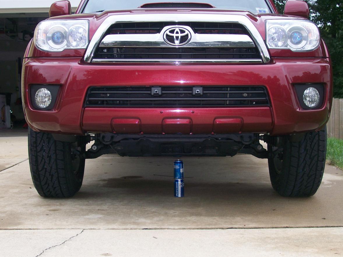

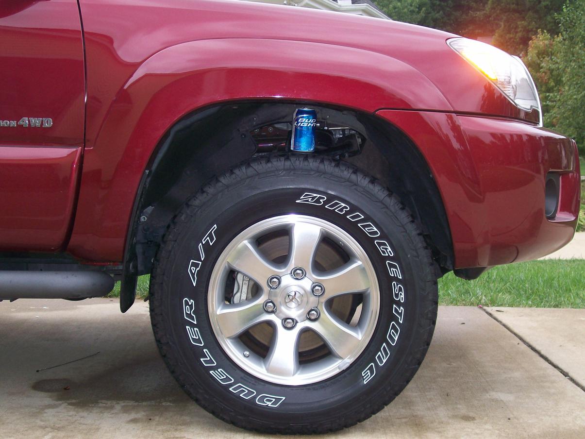

I had my 08 Aligned after my Daystar Lift install, (Topout spacer only) and they were not able to get my Caster back to specs but were able to get them within .2 Degrees of each other. 2.4 Degrees Lt 7 2.2 Degrees Rt. The spec is 2.5 - 4.0 Degrees. So in reality the front wheels are moved slightly back from the "ideal" or spec location. They told me not to worry since they were very close to each other, and the real problem would be if the were far apart.
Has anyone else run into this issue?

The shop I had do it does not specialize in lifts or 4x4s, but the owners/guys doing the work are autocross guys and have the best alignment machine you can get. They do specialize in setups with aftermarket supension mods.
Before #s
Lt front Rt Front
Camber Camber
.8 .5
Caster Caster
1.5 1.3
Toe Toe
.15 .08
Total toe
.23
Steer Ahead
0.04
I won't even post the rear since they basicly did not/can not be changed.
After #s
Lt Front Rt Front
Camber Camber
-0.1 -0.1
Caster Caster
2.4 2.2
Toe Toe
.04 .03
Total toe
0.07
Steer Ahead
0.00
My Steering wheel is centered.
Camber Specs .06 to -0.9
Caster Specs 4.0 to 2.5
Toe Specs -0.04 to 0.13
Total Toe specs -0.08 to 0.25
Steer ahead spec -0.05 to 0.05
Overall I think they lined it up well from side to side. I drove it over 200 miles yesterday and it does not pull in any direction.
