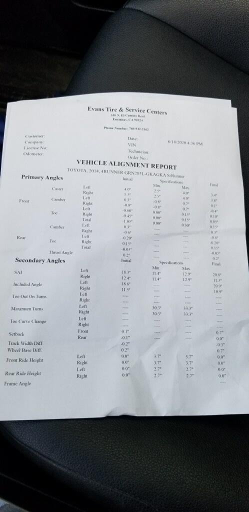

Posting for friend. Went from a 2” lift to a 2.75 lift. Added UCA’s. was driving straight even after the lift and now it’s pulling right. All I can see is the SAI is off but not super good with alignments. Any help is super appreciated
