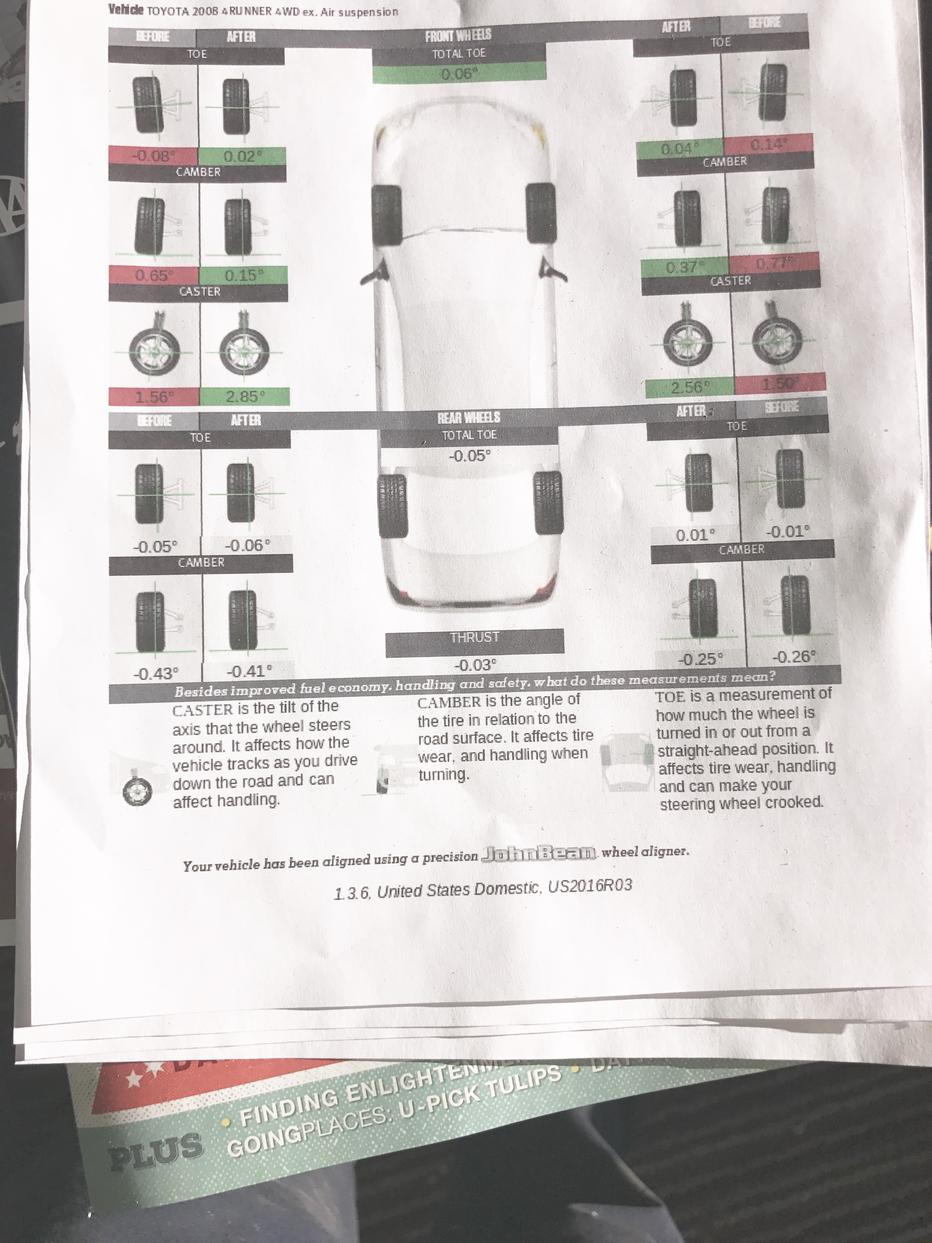

I already asked this in the 4th gen section, but would like to post here to get a broader range of help. This is my alignment after ripping out Xreas and doing 5100s at 2.5 with stock coils and daystar 1.5 in rear. It pulls to the right and now I am rubbing on my sway bar and my tires are barely kissing my stock UCAs. I have stock 17" wheels with 265/70R17 and they never rubbed before. I'm taking it back to have the alignment rechecked. Anything particular I should ask for?
