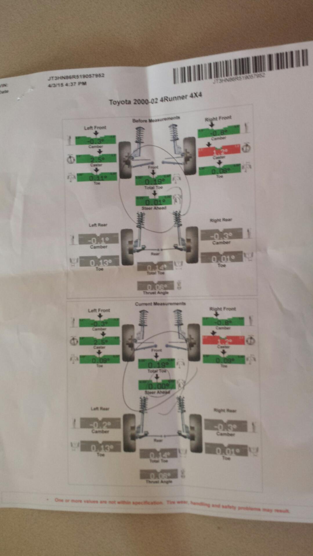

I've been in for an alignment twice now and I still have a pretty bad steering wheel shake above 60 mph. I have a 2.5 inch lift in the front with stock UCAs. Can anyone tell me what the specs need to be for that amount of lift and stock ucas so I can tell the alignment shop what I want? Or is the steering shake not an alignment problem but something else. (I have new outer and inner tie rods.)

Steering wheel shake is a front wheel imbalance. Have the wheels balanced
I suppose they could be out of balance. They only have 4000-5000 miles on them but before i got the alignment done it was WAY off. Didn't have any steering shake though. I noticed the steering shake immediately after I got my tires rotated. If it's not my tires I can definitely see it being my rotors they look pretty thin so could be warping.

I agree, 99.9999% of the time it's a tire or wheel balance issue. However, I've heard excessive amounts of toe can cause vibes.
Now, get that caster fixed!
Those issues would make a wheel balance issue must more obvious but not solve the shake.
They have solved it for me many many times. I actually just adjusted the rack on thursday and it solved the shake - the guy said it had a vibration for over 3 years and nothing solved it.

Since the 3rd gen is body on frame, every balance issue is harshly noticed. Can you explain the steering rack adjustments? I was under the impression that if everything is "tight" and the toe is set correctly, you're good to go.
I also noticed a wobble after rotating the tires, and even more so when I installed wheel spacers. I checked the torque on the spacers and then the rims after 20 miles of driving and they're still properly torqued. I was told it was the wheels needing to be balanced. If it is the rack needing adjustment, how would I go about getting that tightened back up? I know it's not my ball joints or tie rod ends, as I have recently replaced those and had an alignment done after the install.
