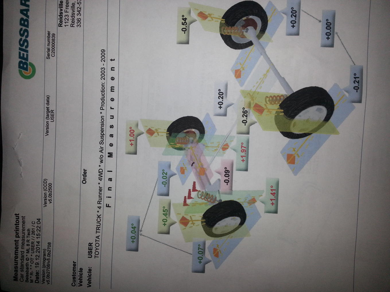

This is what they came up with. Drives good, no pushing or pulling. I had no issues before alignment except tires wearing on the inside, not real sure how to read this sheet though, never seen on like it. Thoughts?20141219_175322.jpg

Just a little update....at highway speeds it seems a little light in front end, really touchy. But, my main concern is tire wear, anyone have a opinion on those numbers I posted?
That's a really difficult printout to read (I haven't seen any alignment print-outs other than Hunter Machines, like the one posted above you.) But that Caster and Camber seem really off if I am reading that right... kinda hard with my neck cranked sideways. lol
Well, thats what i thought but, figured i hadn't had a alignment done in a while and maybe this was something new. If you look at it closely it almost looks like a generic form, doesn't have my name or nothing on it, idk.
If I'm reading it right, to me, your alignment is still off. On the passenger side, 1° of camber is way too much. You will definitely wear the outside of that tire. Even the .45° of camber on the drivers side is too much. Also, the caster on both sides is low. That is where the skittish handling is mostly coming from. Honestly, the only thing that looks halfway decent is the toe. Is this the same shop you first used? The struggle is real, it's hard to find good alignment techs.
First alignment i have had on this 4runner, Nisaan dealer that is supposed to be good!! Not sure if i want the hassle of taking it back to them and trying to get it right or go to this independent guy that was recommended to me. I tried telling the "front desk guy" what i wanted when i went in but he kind of blew me off, not sure how well it will go if i go back in there, on my end!
Not entirely worried about the customer information as we don't bother typing that crap into the Hunter Machine (its not even hooked up to a network), but like [MENTION=32290]gm350reratliff[/MENTION] mentioned, the more critical measurements appear to be off by quite a bit. It honestly looks like they just "set the Toe and let it go" which is pretty common practice with most places that do alignments unless you press them to correct ALL the angles. To be honest though, most of those don't even look close to being "in the green."
OK, thanks guys for the input, I should have known something was up when I had to ask for my printout!! Now i need to decide if i am going back there or to the independent shop. The indep. shop was recommended to me by the guy who does all my service work on my 4runner.
Up to you, it wouldn't hurt to talk to the shop and see what they'd do for you. Worst case scenario you go back to the first shop, throw a polite hissy fit (meaning you ask for the proper repair to be done politely, they think you're being unreasonable and "one of those customers" ect.) and they do a shit job again and you go to this second shop. :)
I guess you missed this part of my response What you should ask for is if they will provide you with a print out showing the before and after readings.. You should have asked for that first. You didn't even get the before specs. I would ask for a refund because it really doesn't look like they did much beyond a toe set.
