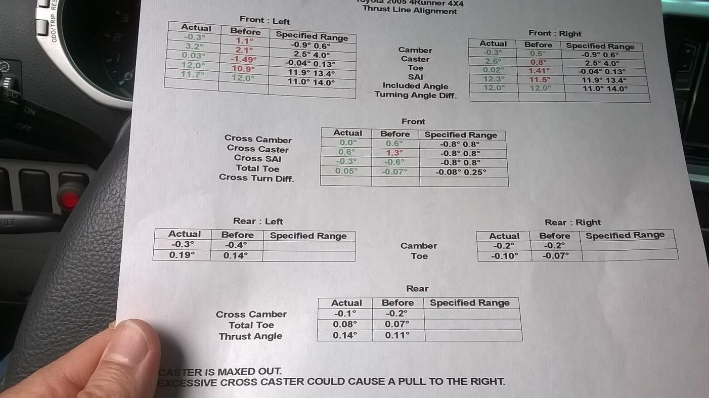

after last alignment the tech at town fair tire told me that the caster is maxed out.
I have installed new parts. KYB strut assembly, KYB rear shocks, new control arms from 1A Auto, new front cams and bolts because the old ones were seized.
I don't know if I should check anything or have the alignment done one more time maybe with a different tech. Or maybe I am over thinking this?
Thank you for any input
Doesn't look terrible, but also looks like a tech just "got it all in the green". I'd want caster to match a little closer but if you don't notice it pulling or wearing tires unevenly then leave it til the next time you tear it apart for more mods.
