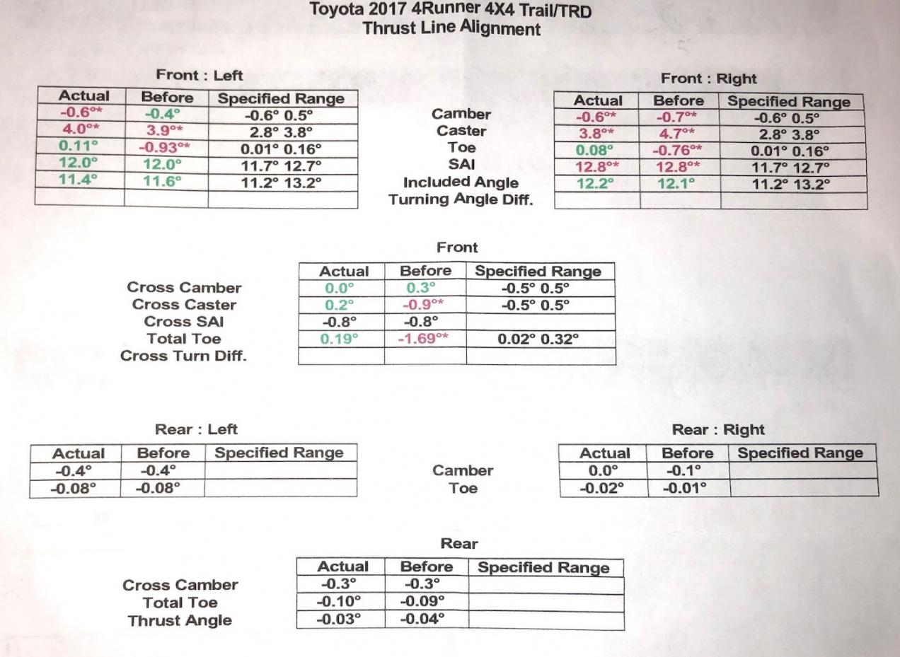

What was odd is that the report shows the before on the caster as 3.9/4.7.
How could that be?
Here's the report

Aftermarket UCA's are designed to increase caster by default. The 'before' number is what the JBA's achieved once you put them on. The alignment 'fine tuned' it

The JBA’s are built with an added ~2* caster....so you were at +1.9* with stock uca’s then the JBA’s added ~2*....that’s where you got the increase on the “before” reading.

Thanks for the quick replies.
I thought alignment adjustments were done at the LCA.
if the LCA was locked into place (alignment-wise) wouldn't new UCAs not have an affect until they're adjusted?
Caster angle is determined by the geometric relationship between the ball joint locations on the lower and upper control arms. Lifting the truck changes this relationship and reduces the caster angle. Adjusting the lower control arm eccentric cam bolts can regain some, but not all, of what was lost by moving the lower control arm ball joint slightly forward.
Aftermarket upper control arms move the upper ball joint location rearward compared to stock. This results in increased caster angle -- usually about 2 degrees, as pointed out above -- even if the LCA adjusting bolt settings aren't touched.
Thanks. I needed this explanation too!

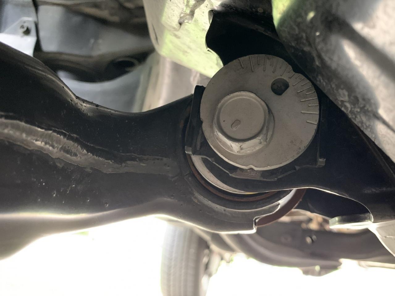

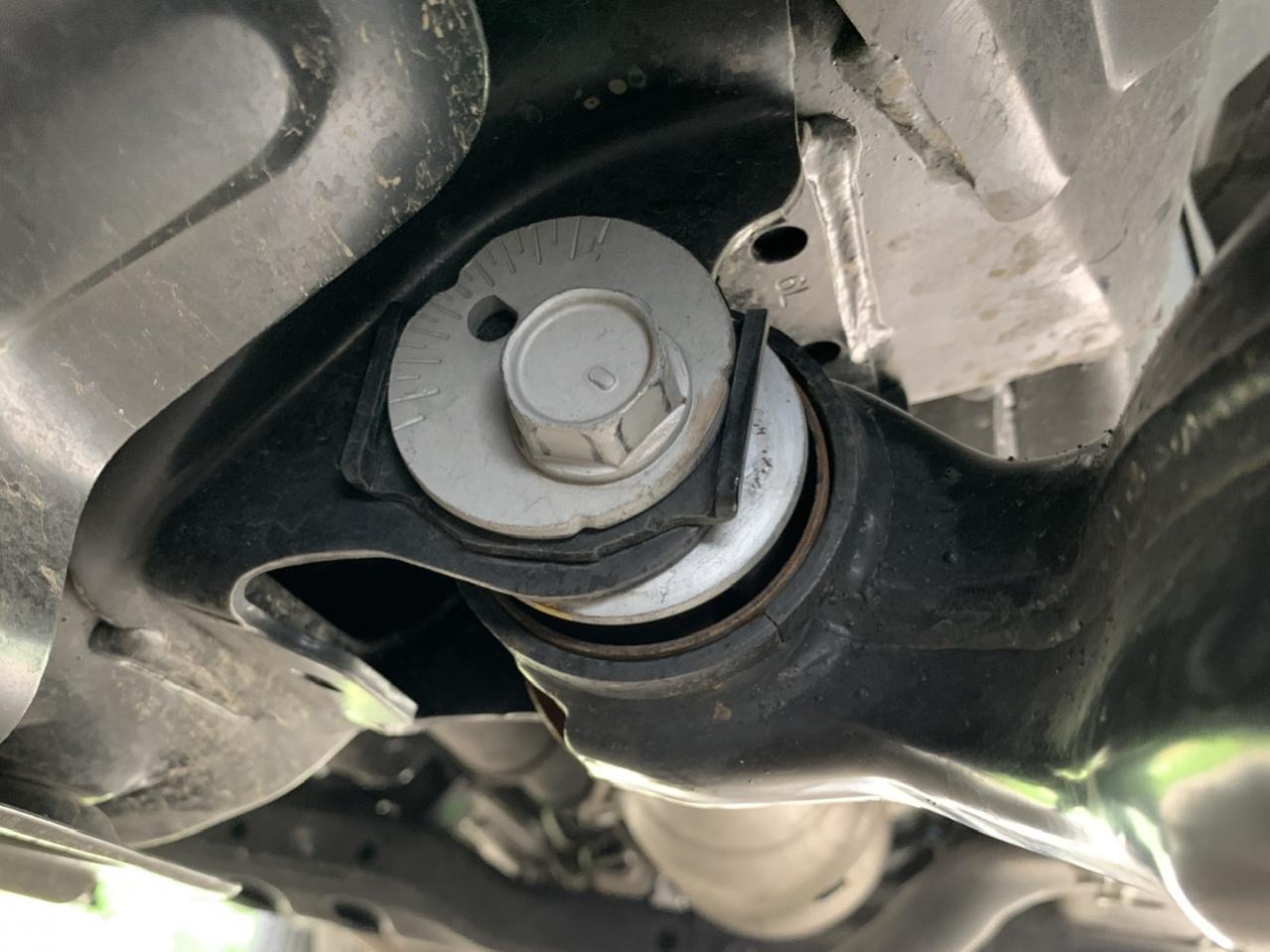

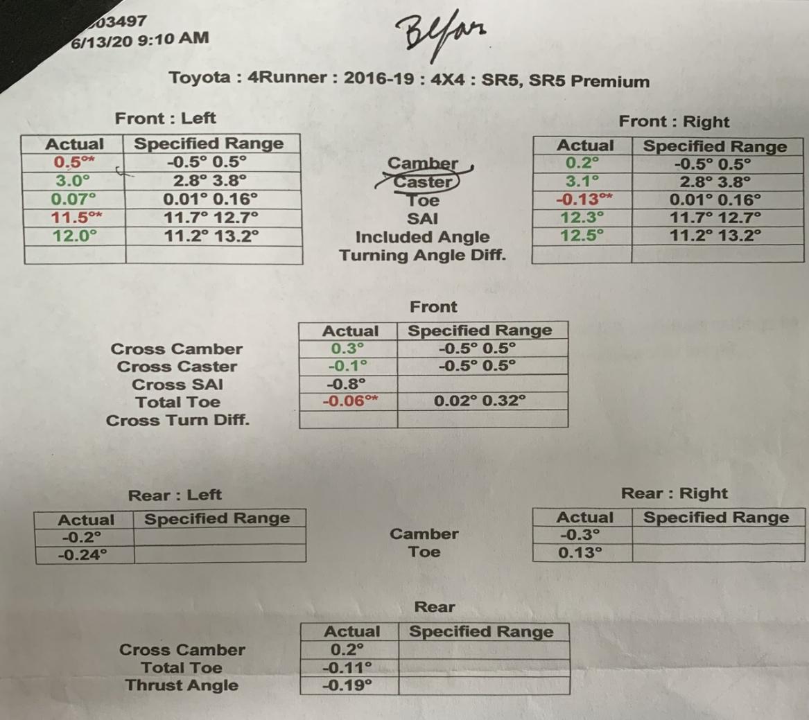

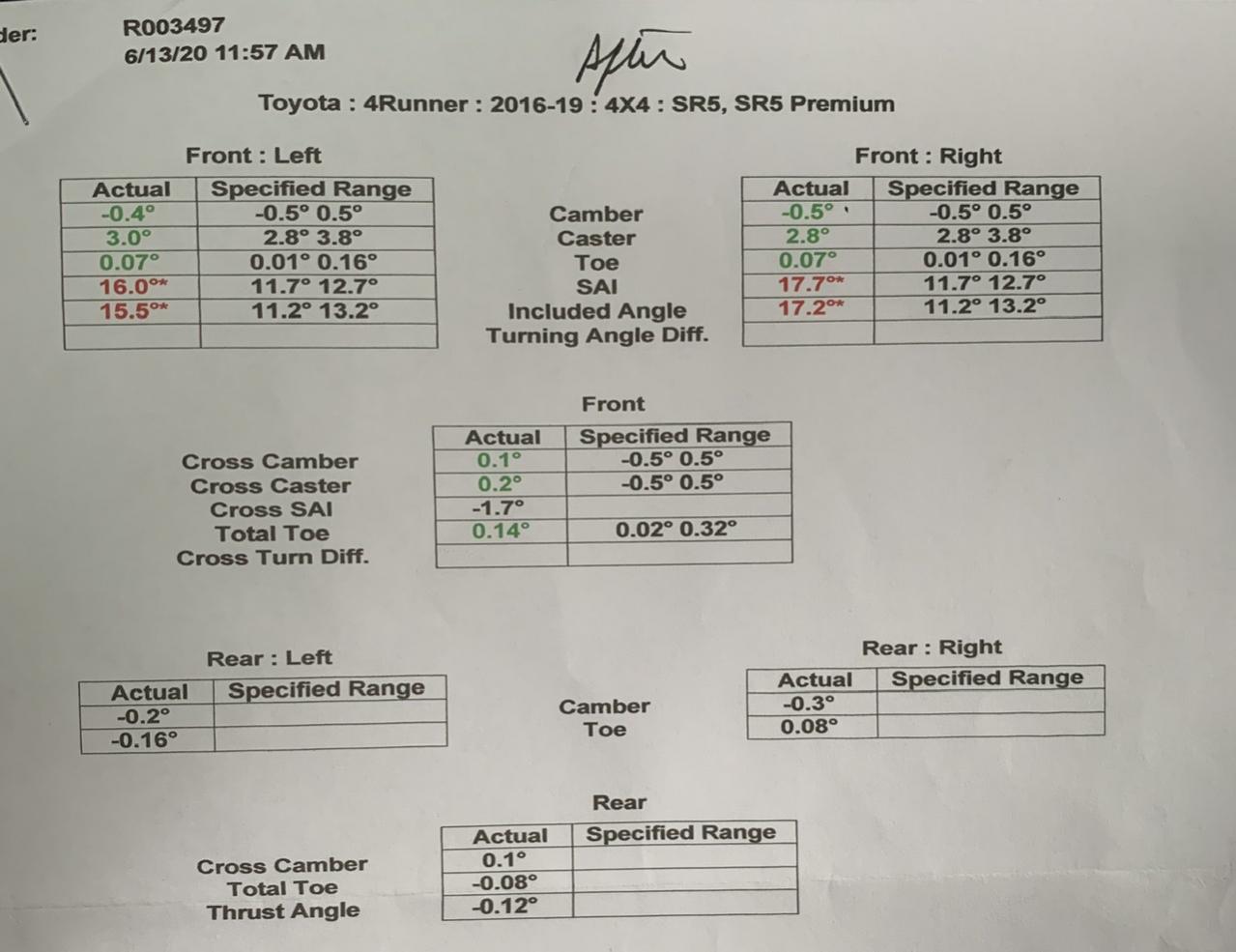

Similar situation and could use experienced eyes and feedback.
Installed Ironman Nitro lift (3”/2.5”) and Ironman UCA’s w/ 4* built in caster.
Went to local shop for alignment assuming it should be simple. Currently running stock wheels/tires with plans to size up to 285’s. I requested caster above 4 to avoid future rubbing with stock wheel. Tech worked diligently for 2.5 hours but it was obvious he didn’t have experience. I should have asked more questions before taking it in- my bad. End result is that all is in spec, but couldn’t get Caster above 3.0 on drivers side and 2.8 on passenger. It drives great, but could use some advise. Should I find a more experienced shop before buying new tires or am I being OCD that my Caster is in the low end of spec?
Before and After alignment specs and photos of L and R rear LCA below.
Does it look like the LCA was even adjusted or is it still in the neutral position?
I see signs of adjustment but don’t know how to read what was done.
Thanks for any experience or advice you can offer!
