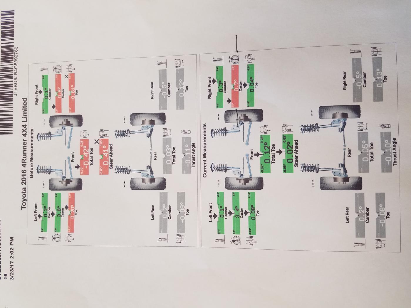

I installed 5100s at 1.75 with 1"rear spacers last week and got an alignment today. Here are before and after #s. It took them 2 hours and I am not so confident in their work. The rep siad to go to toyota and buy some bolt that can extend the adjustment range to increase camber...
Long story short the truck pulls to the right and this was not at all noticeable before. All the numbers seem to have moved in the right direction. Any ideas?

They sent you out with +3.4* caster on one side, and -.7* on the other?!
That's completely ridiculous, and they are 100% incompetent if they're sending you out the door with those kind of specs.
Definitely find a competent alignment shop, and have them fix it.
You want them to max out the caster, without going positive on the camber.
WOW... These people are beyond clueless.
Go get your money back and find a shop that knows how to do an alignment on a Toyota.... There are no bolts needed... That is just a BS line. They only adjusted toe (tie rods) and did not understand how the cam bolts are the lower control arms work or simply just did not want to get it right. I'm 95% sure that alignment machines tells them how to adjust... Sad how lazy people are.

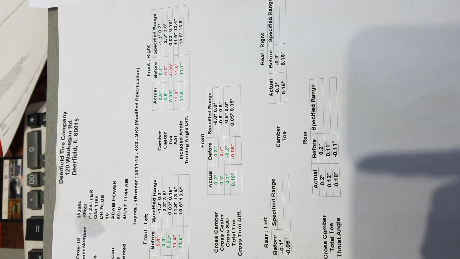

Ended up at a firestone - I told the guy info from this thread more or less and he said no problem. I'm extremely happy with the 5100s now.
