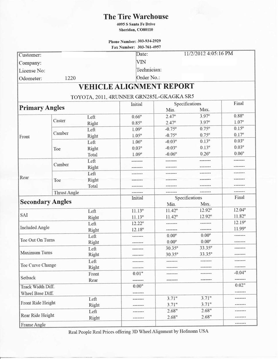

A few guys asked to see my alignment report after the recent install of Toytec Ultimate, 18" FN BFD's, and Cooper A/T3's.
The report:

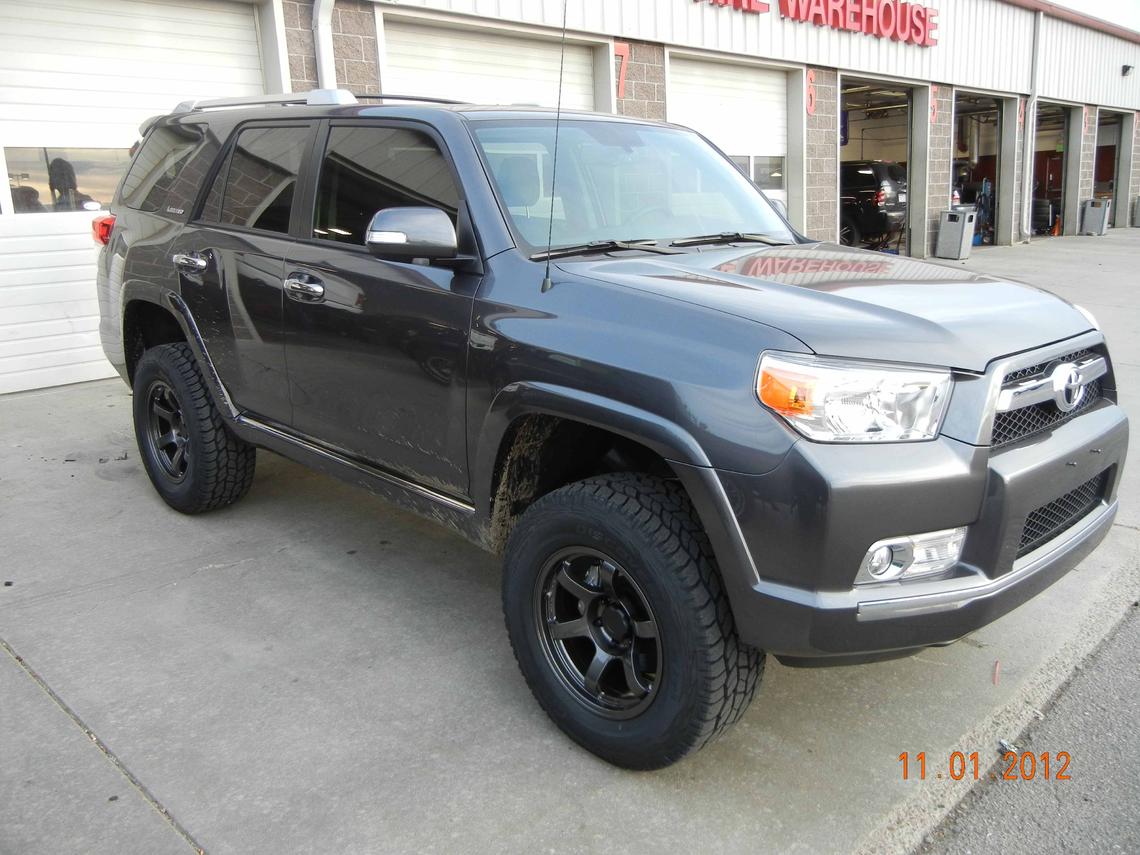

The vehicle:

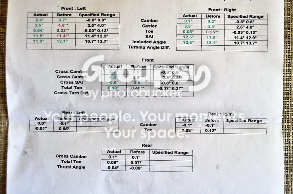

Yep, your caster settings are super low but they should have been able to get better then that even with the stock UCA's .
The closer you get to 4.0 with the caster and still keep camber and toe within specs,the better highway stability and stiffer steering feel ,you have on 5th Gens. It was a night and day difference on mine and a good reason to get aftermarket UCA's when lifting,besides the added 1-2 inches of down travel you get from them.
Here was one of my alignments and I even went higher with caster(5.6) on a subsequent alignment and it's been like that for awhile and love it.
alignment.jpg~original
Thanks for the insights!
This thing really feels fine on the highway (all speeds) and I have to deal with very squirrely road surfaces. I chalk-up the slightly rougher feel to the more aggressive tires of course.
I would def love to have it a little tighter feeling...though it's not bothering me as-is.

With a lift and stock UCAs, you will never get over 4 degrees of caster.
Yes, you should add UCAs if you want it to drive as well as it should/could. Factory alignment spec from your sheet is 2.5 - 4.0 and you are WAY under. IMHO, factory spec should be more like 3.5-4.5 degrees.
The very popular 5th gen T4R complaint of twitchy steering and being blown all over the place by wind is a direct result of the low caster spec. Same phenomena as 2 wheel vehicles, if you are familiar; more rake trail make for more high speed stability (self centering), but harder high speed steering. Think raked out cruiser vs. race bike.

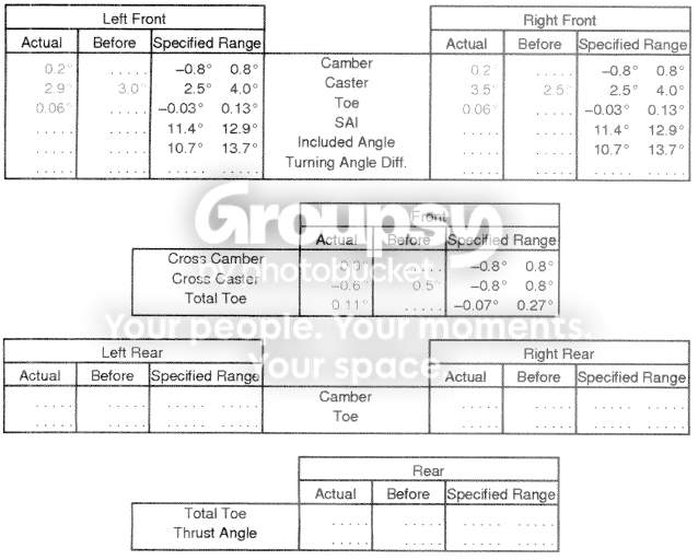

Got mine buttoned up on Monday after installing the 5100's on Friday. Here's the report:
AlignmentResults_zpsf89721e5.png~original
Comments on the results? I did specifically request Caster of 3 Degrees or higher while keeping Toe and Camber in spec - this was his absolute best effort with the stock UCA's any my small 0.85" front lift. He took his sweet time (little over 1 hour in the bay), and was only $69!
Rock on :cool:
