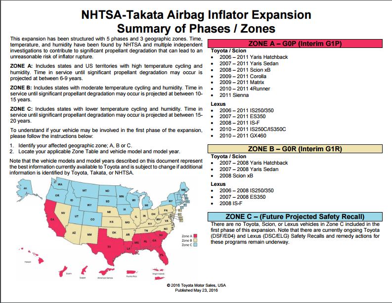

My understanding is that all 5th gens 4Runners include a defective passenger side air bag manufactured by Takata with a phase-stabilized ammonium nitrate (PSAN) propellant that does not contain a desiccant.
A desiccant is a material that acts as a drying agent. Desiccants collect moisture present in their immediate environment, helping to limit moisture absorption by other nearby materials.
Without a desiccant, the inflators may degrade after prolonged exposure to high absolute humidity and fluctuating high temperatures. Degraded propellant can cause inflator rupture during airbag deployment. In the event of an inflator rupture, metal fragments could pass through the airbag cushion material, striking the vehicle occupants, and result in serious injury or death.
The inflator degradation does not affect the air bag deployment circuitry, so they should not trigger spontaneously, even after degradation. The issues is that once degraded and triggered... the inflator is basically over charged. A small bomb of sorts.
Please read this PDF for further clarification.
https://techinfo.toyota.com/techInf...echinfo/html/prelogin/docs/cp/g1pg1rtofaq.pdf
The recall for your truck is phased based on the age of the airbag and the zone you live in. All 5th gens will be recalled eventually (explained in the chart below). Right now it is just 2010-2011 in zone A. That will include 2012 next year..... and so on
Unfortunately, those in the gulf states + Cali with a 2010-2011 are already recalled, but there is no remedy available at this time. Not a great situation, but hard to say what the risk really is for your passenger. It would mostly depend on the environment your tuck lives in (garaged.....) Also, it is hard to say how cautious they are being in their projections.. I'm guessing they are being overly cautious, so I'm not too concerned myself.
I'm not sure about this, but I think Toyota is basing the recall trigger on where the vehicle has been registered over time.

I'm pretty sure you just have to wait until Toyota flags your VIN. I updated the post to clarify this, but I think it is based on where it has been registered (not purchased).
At this point it does not matter since there is no remedy available.
Forgive my ignorance, but are they phasing the recall not only based on geographical region, but also on time?
For example, 2010-2011 are currently recalled, would 2012 be recalled next year, and 2013 the following?
It's a simple formula, the zone sets the degradation rate.
Zone A:6yrs
Zone B:10yrs
Zone C:15yrs
It gets a bit more complicated if you move between zones, but it's just math LOL.

Thanks. I'll ask again here. Is it known how old the airbags that have failed were. That is, what is the youngest/newest vehicle that has had a failure failure?
From the Toyota Canada website:
Toyota Update on Takata Airbags in New Vehicles
June 10, 2016
Category: Safety Corporate
TORONTO, ON – June 10, 2016
Toyota is currently in the process of phasing out the use of Takata frontal airbag inflators that contain phase-stabilized ammonium nitrate (PSAN) propellant without a drying agent (“desiccant”).
The only Canadian market vehicles currently in production receiving Takata frontal PSAN airbag inflators without desiccant are the 2016 model year Toyota 4Runner and Lexus GX460. Additionally, the models that may be in dealer inventory today equipped with Takata frontal PSAN airbag inflators without desiccant are the 2015 model year Lexus IS250C/350C and Scion xB, and the model years 2015-2016 Lexus GX460 and Toyota 4Runner. Note, these are all frontal passenger air bag inflators.
Importantly, these non-desiccated Takata passenger frontal PSAN airbag inflators in these new vehicles are not subject to a current recall.
Based on multiple independent investigations and NHTSA’s independent expert, NHTSA has concluded that non-desiccated frontal Takata airbag inflators do not pose an unreasonable risk to safety until they reach a certain level of propellant degradation after long-term exposure to environmental moisture and fluctuating high temperatures. NHTSA and Takata are prioritizing recalls of these components through to 2019 based on when affected inflators are likely to pose an unreasonable risk to safety, considering time, temperature and environmental moisture, which depends on a vehicle’s operating location. Toyota will take appropriate steps to remain compliant with Transport Canada regulations based on priorities determined by the level of risk associated with involved vehicles in Canada.
