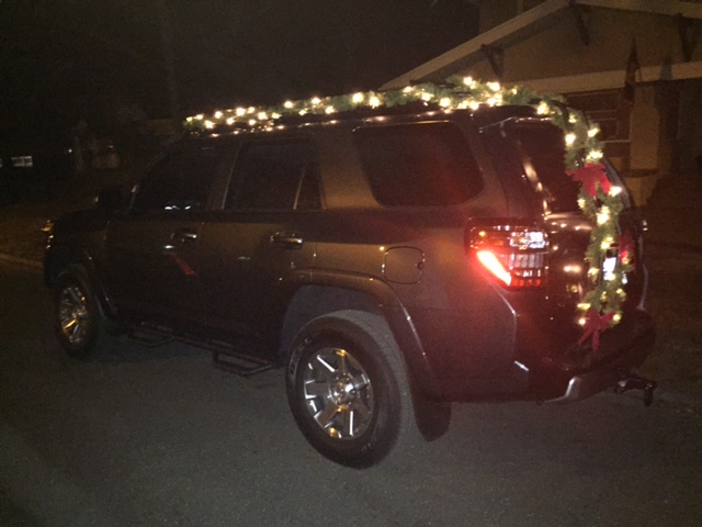

Compared to my Ford Explorer, I noticed that the 4Runner factory sunroof design is much quieter. The GOBI rack was one of the first mods to my 14TEP due to (what I consider) inadequate rack system from Toyota. Once installed, I can tell a difference in noise level with the radio off, and also with the sunroof open... but it is still ALOT quieter than the Explorer... and noise tends to be relative to user expectations. With the sunroof closed and the radio on low, I can't even perceive the noise difference from the factory rails.
So all that being said, noise isn't an issue with the GOBI especially with the wind fairing properly curved, anchored and touching the entire roof line (like hendooman previously noted).
The funny thing is with all the different stuff I put up there, my kids still love the 30' Christmas garland the best. And I gotta admit... the GOBI rack provides a ton of options if you're looney enough to use it for that 'decorative mounting purposes'. Next year, I've already got more stuff I'm planning on doing for the Christmas holiday. :)
