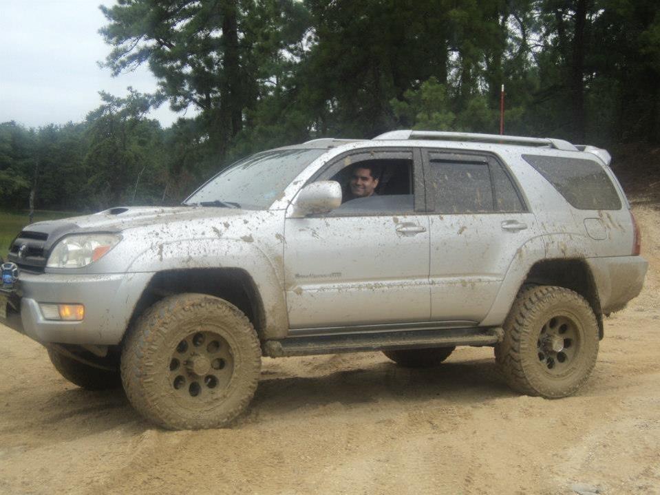

hey guy found a side view pic of my truck which was taken right after coming outta hole in my sig.
shall i emoty the gas out of it??? theres no weight in the truck besdes me sitting in it i weight 190...... the driverside has a trim packer in it so what your seeing is where it sits my friend:shrug:
Nooooo up front im running tacoma springs and bilstein struts with 3 inch spacer. note uca are needed if going offroad the control arm will make contact with the spring. a nice set of camburgs are my next investment
